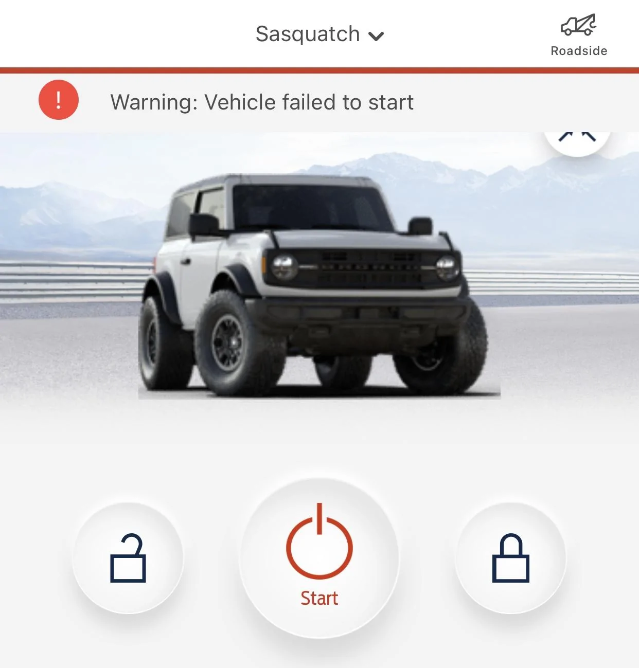

Has anyone tried to disable the Engine Idle Shut Down with Forscan on the Bronco?
(different than the Start-Stop function)
The Bronco only lets you idle the engine for 30 mins max (two 15 mins starts on the FordPass APP) you can shut this off in the Vehicle settings, but it auto resets on each start-up. Making it not practical for remote starting.
I know it's not a big deal for 95% of people but when it's very cold out you sometimes need a few extra starts.
