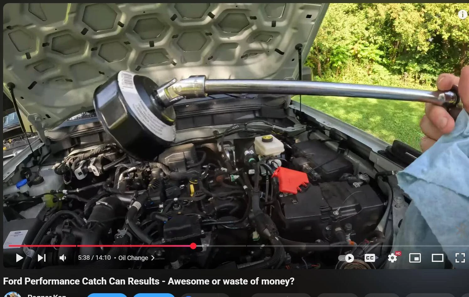

Yes a tool like the one above will help a lot, used with ratchet extensions. Here is a video that may also help:

This is EXACTLY how I do it. Skip ahead to the 5 minute mark. TLDR version: 14 flute oil filter wrench on a long socket extension. This exact fit wrench is less than $10 and will be easier to use than the one linked above, which requires some tension on it to grab.

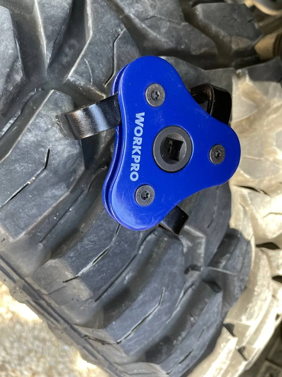

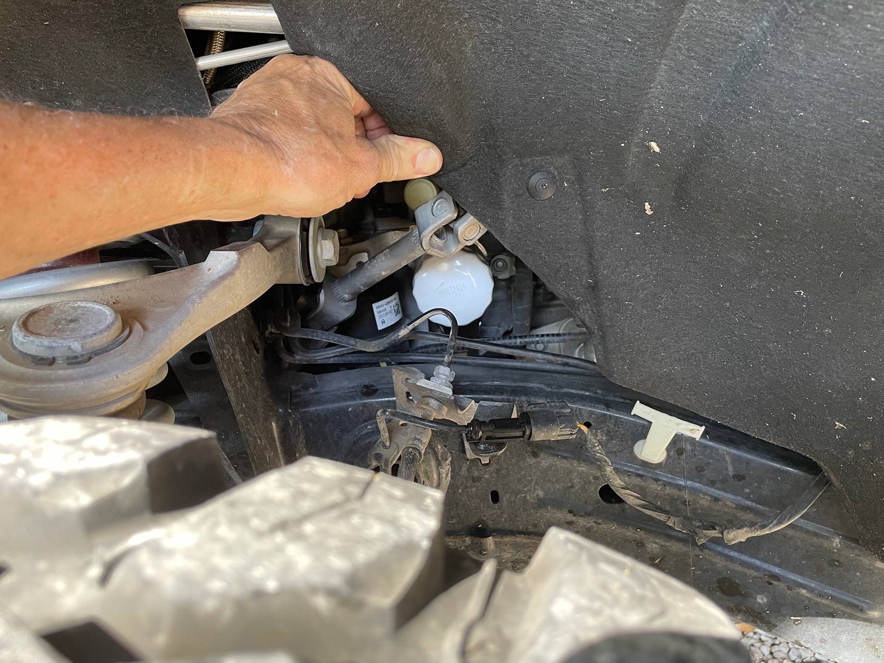

I fold the inner fender back and reach in with a long extension, 3/8” ratchet, and one of those three finger wrenches. Yes it does require resistance to grab but fits multiple size filters. I reach in and hand tighten it. With the inner bent inward out of the way it’s not bad. You really have to hand feed it in there to keep it from getting dirty anyway.

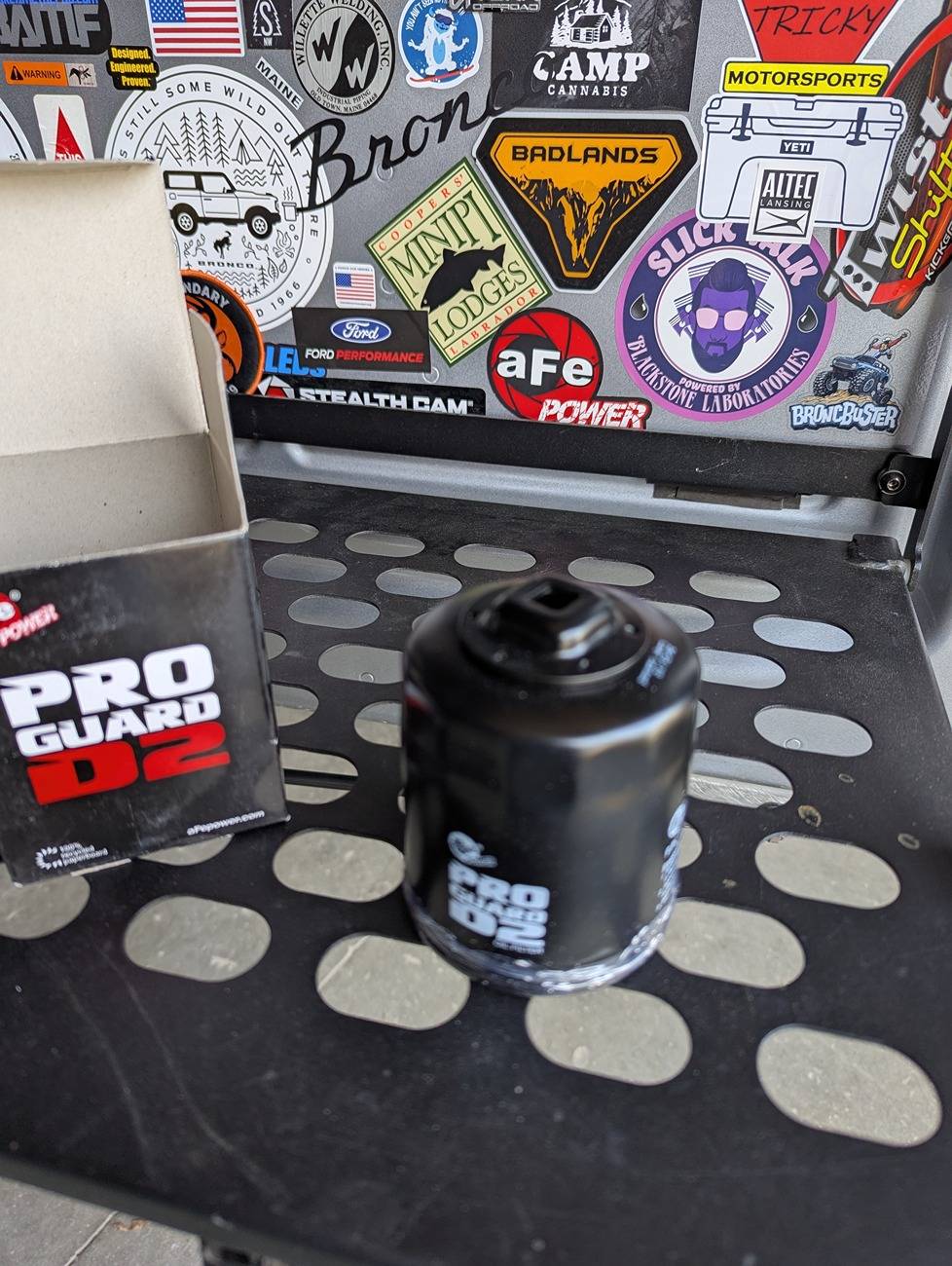

AFE has a clearance sale couple years back, I bought a case of these, pretty slick IMO
