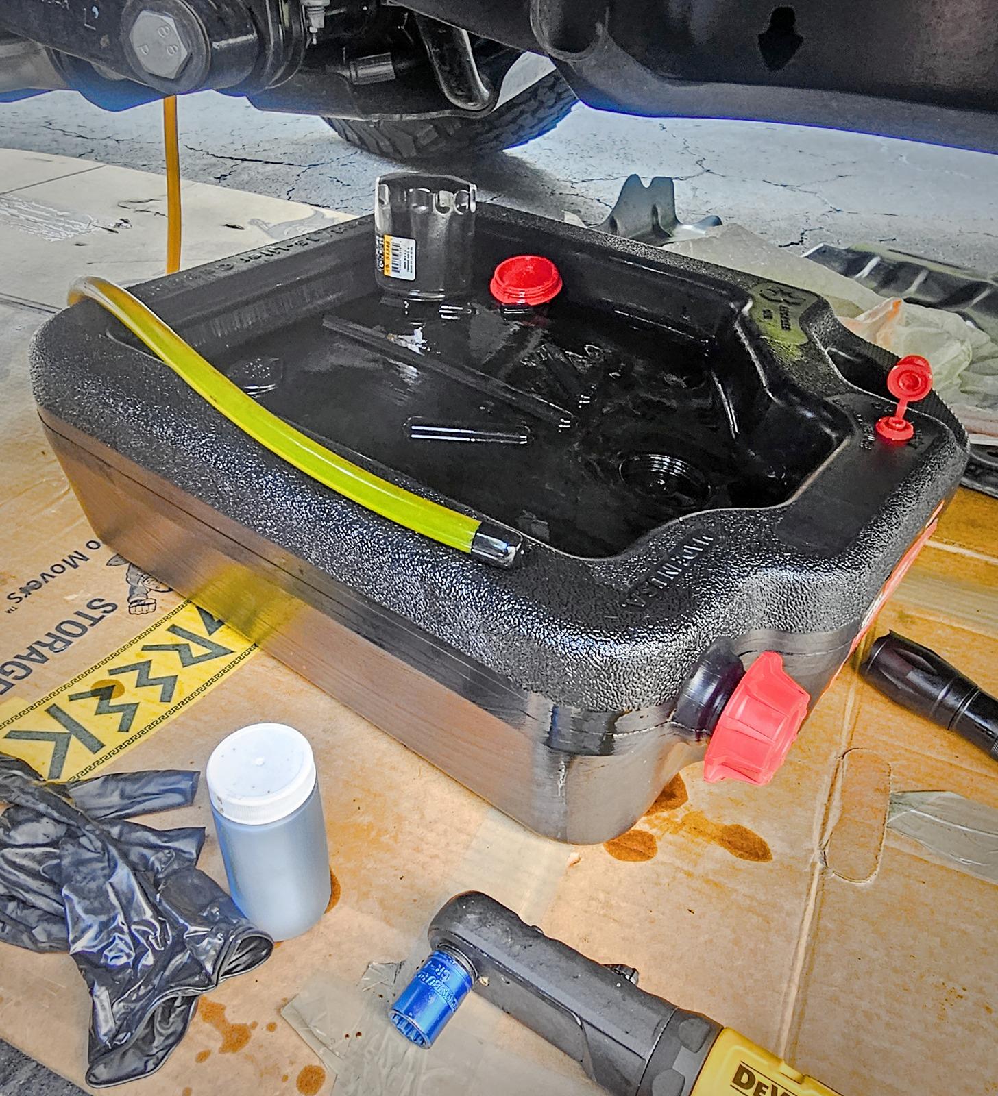

So, here's a pic of the setup:
Ford Bronco Oil Change Experience 1000014460
Clockwise from top-left:
  • Zip tied Tygon tubing, valve side, leaks if I pull it hard to one side while draining. No leaks otherwise.
  • Wix 51348 (non-XP, because O'Reilly guy lied? and were out last time) oil filter, draining.
  • Skid plate under trash bag I re-use for transporting oil to auto parts store for recycling.
  • Some auto parts store 15qt drain pan, great for multiple vehicles.
  • Flashlight, to check for leaks, etc.
  • Dewalt electric ratchet that I end up not using, to be nice to my neighbors in the morning, except to bolt the skid back on real quick.
  • Cheap, blue Hobo Freight 15mm socket because I outsmarted myself and put the 15mm deep socket in a specific oil change tools spot.
  • Oil sample for Blackstone Laboratories taken after several seconds of draining--stupid easy with the tubing.
  • Nitrile gloves I used to try and keep my hands clean before I lost my cool and took it off.
  • Doubled over, thick cardboard moving box to catch drops and slide on like a poor man's creeper, because I learned this way growing up poor as a kid and I don't have to lift a stock Badlands to change the oil.
  • The other end of the Tygon tubing (maybe this is out of order) with the rubber cap back on it. I was waiting for any extra oil lining the inside to collect in that bend. It's a gamechanher for the 2.3L oil changes.

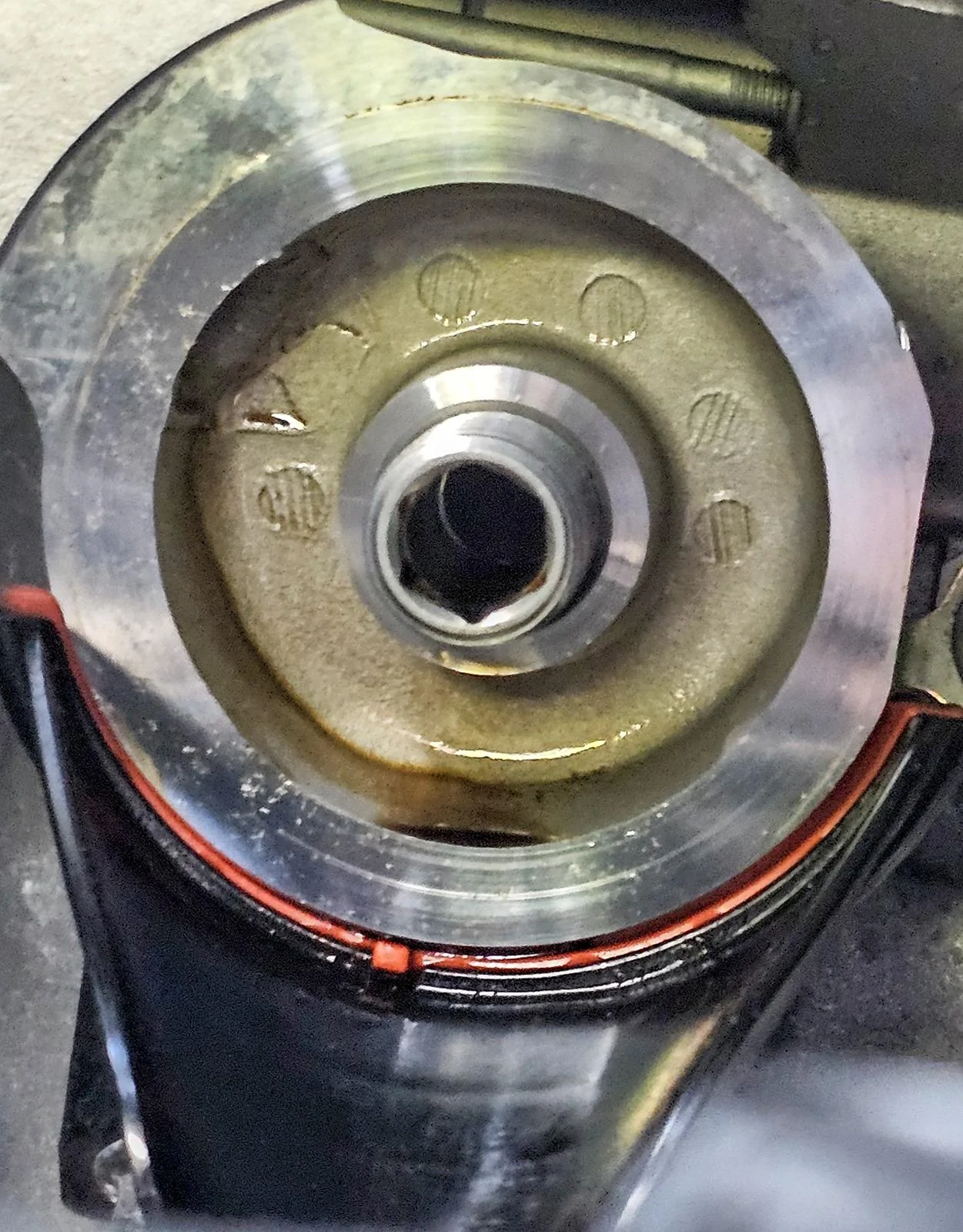

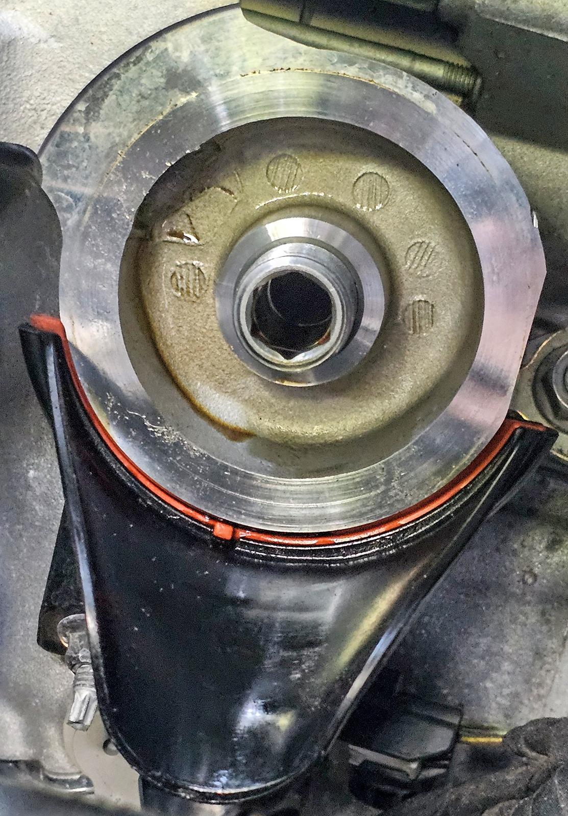

Here is the oil filter mating surface right after removal and then after a wipe down and wiping the oil chute.
Ford Bronco Oil Change Experience 1000014461
Ford Bronco Oil Change Experience 1000014462
It's not a lot and I did not get a shot of the long, skinny chute. The blue shop towel I used got more oil from wiping it down, though. The Ford oil monkeys are not likely to wipe that down or have the time to let the oil drain out of the channel. That's where the drops and such are going to come from.
