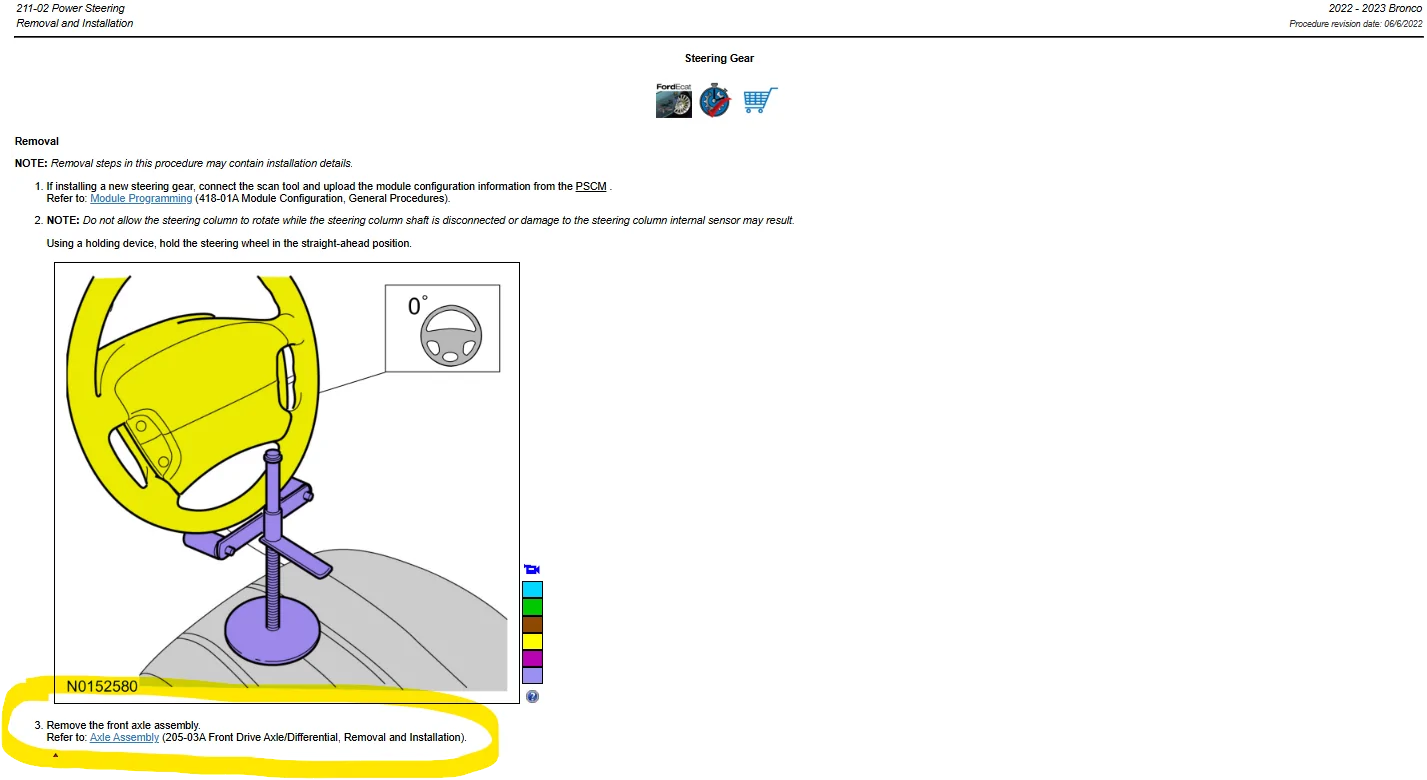

Understandable to think that if you aren't familiar with Ford's workshop manual, however you have to also go though each section it lists.
For example, to remove the steering gear, it instructs you to remove the FDU. While that may not be entirely necessary for steering gear replacement, I'm willing to bet it is for oil pan removal/installation.
