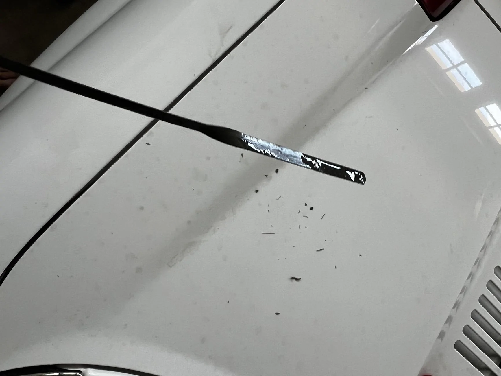

Let the car sit over night after 6.5Q and it’s not too far over the 2nd dot. I feel okay.
