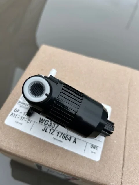

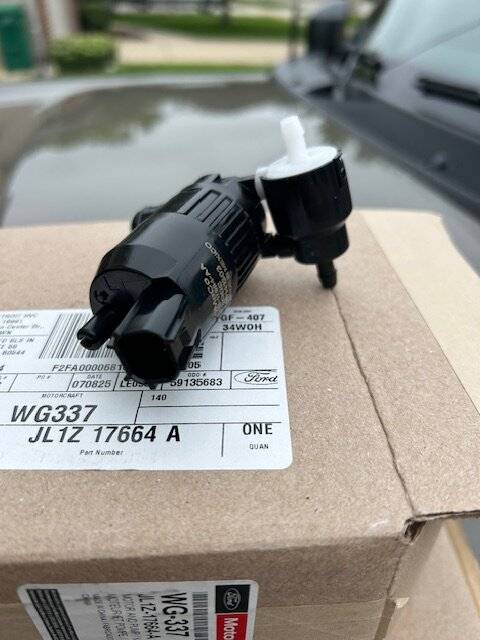

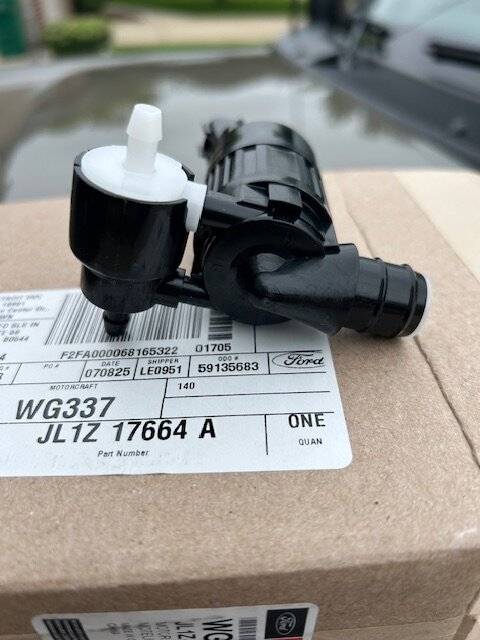

Well I just went and bought a pump for my 2025. I know it is under warranty but it was $47 so I don't want to hear it blah blah blah. It looks like there is an intake screen (white) that my guess is probably clogged with something from the manufacturing plant or such. I looked up the hose diagram and there is no one way valve after the pump itself or switch that diverts front or rear washer. It appears that if the pump spins one way it goes to the front and the other way spinning it goes to the rear. The white circle seems to be a one way valve on one of the hose fittings. My best guess is that the screen is clogged or the pump impeller has an issue of some kind since mine will spin freely seemingly as if it is empty before eventually drawing washer fluid and working fine for a while. Another guess is that the impeller is not secured to the motor shaft and maybe RainX washer fluid is too slippery. All theories waiting for lab day when I take it apart and get some answers.
