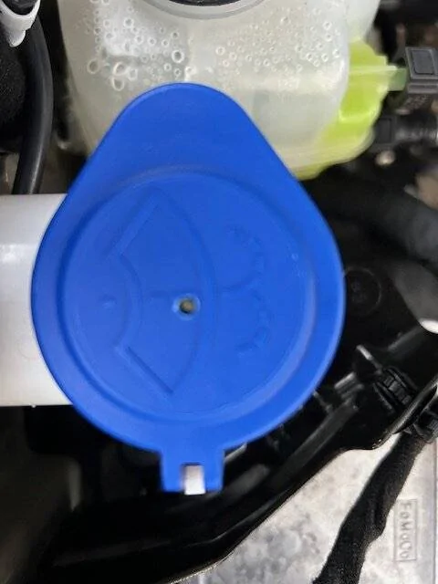

My new 2025 with just over 1000 miles after sitting in the heat for a couple days would not spray washer fluid. No leaks under it, fluid is full, hoses are good no kinks when I traced them out. I opened the lid and wiggled the hoses bit and tried again. Now it works. I could hear the pump running at first before I opened the hood and it seemed loud and possibly dry running. I think I saw someplace that the washer fluid container might be sealed too well with the lid on it and now allowing fluid to pump because of vacuum. Some said to leave the cap loose or drill a small hole in the lid. I drilled a small hole and no more issues with it. The back side of the cap is a foam piece that seals really well, probably too well. Having a little vent fixed it so far.

Because it fixed it. If you take it to the dealer, they will probably change out the pump or hoses and replace new with new. I have never had a Ford that had a foam back lid on the washer fluid before that sealed so tight. It would be the same as taking a water bottle, filling it, drilling a hole in the bottom while the cap was on and no water would come out until you opened the lid. Hey, it worked.

There is at least one older thread here documenting this, maybe more. So I’d agree it’s not widespread, it isn’t unheard of and drilling the hole is probably the best solution to the issue.
Good on OP I say - it’s their Bronco and they fixed an engineering issue in a manner that doesn’t negatively affect anything else or cost significant money or time.

Actually, it is a wide spread problem. And it has been well documented. I did something similar to mine. I drilled a very small hole on the firewall side of the washer bottle neck just beneath the lip. I was concerned about dirt entering through the lid if I drilled there. Now my washer fluid disperses as soon as I hit the button every single time. Vacuum is indeed an issue with the washer bottle. 6 months later, no more issues with my washers. Both of my broncos had this issue.
