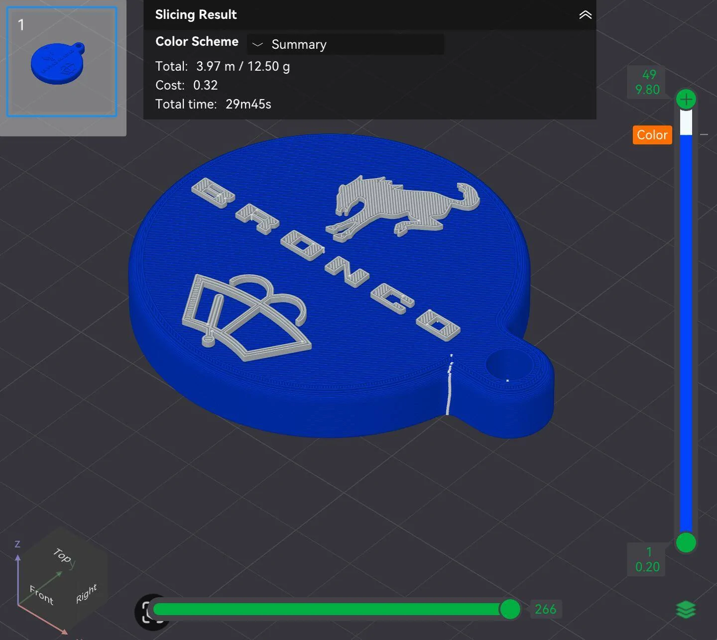

Danielsan [ATTACH type="full" alt="1751404011988-y1.jpg said:
737644[/ATTACH]
I need this!
