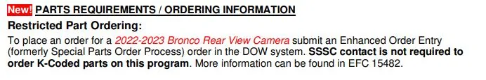

Dealers can get the parts by contacting SSSC or some other ways in certain situations though. Not sure if this is what your dealership did or not.

No, that’s not accurate.
21-23 all came with the exact same camera from the factory up until 4/6/23.
At that time, the faulty camera (M2DZ-19G490-B) was superseded and replaced with M2DZ-19G490-E which is the recall fix part.
Ford Bronco New Recall #23S48 - REPLACE REAR VIEW CAMERA IMG_7582
So like I mentioned, M2DZ-19G490-E is probably the correct fix for all of them. If it fixes the 21’s, why would it be any different for 22-23 🤷‍♂️
