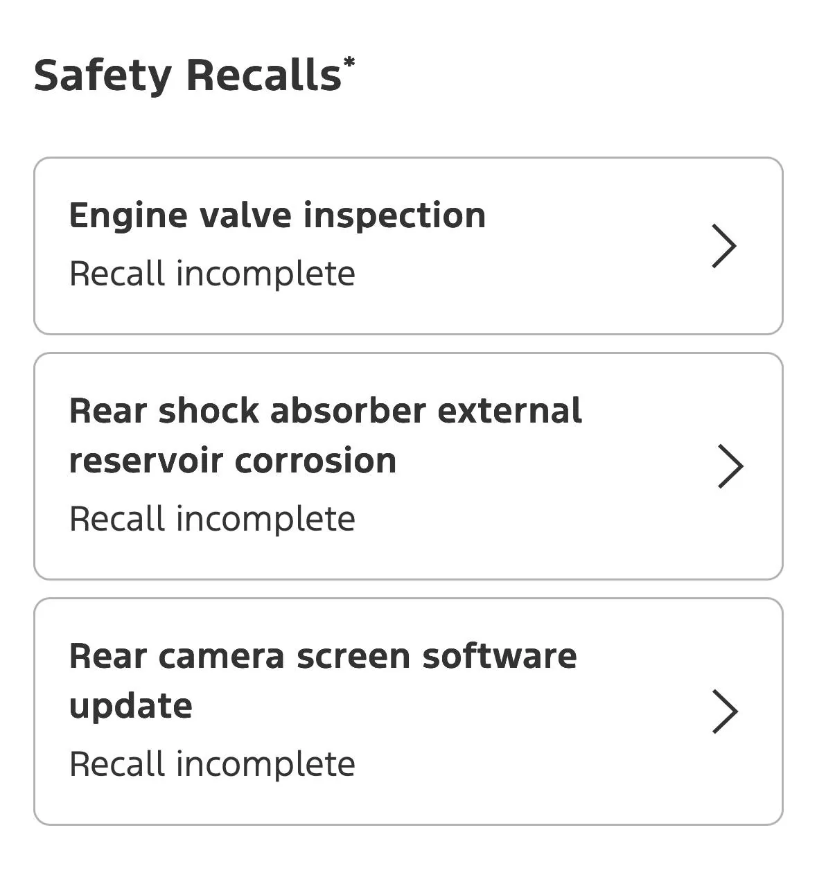

My 2021 has the trifecta of recalls with no solutions
Ford Bronco New Recall #23S48 - REPLACE REAR VIEW CAMERA IMG_2836

So my 2021 BL which had camera recall in 2023(and fixed)- is now recalled again(got the alert of the Fordpass app)?
Ducati1098
9,988
23,198
Midwest
Theres 2 different camera recalls.
One to replace the camera, and a new one to update the software for the rear camera. You likely saw the software update one that just came out.

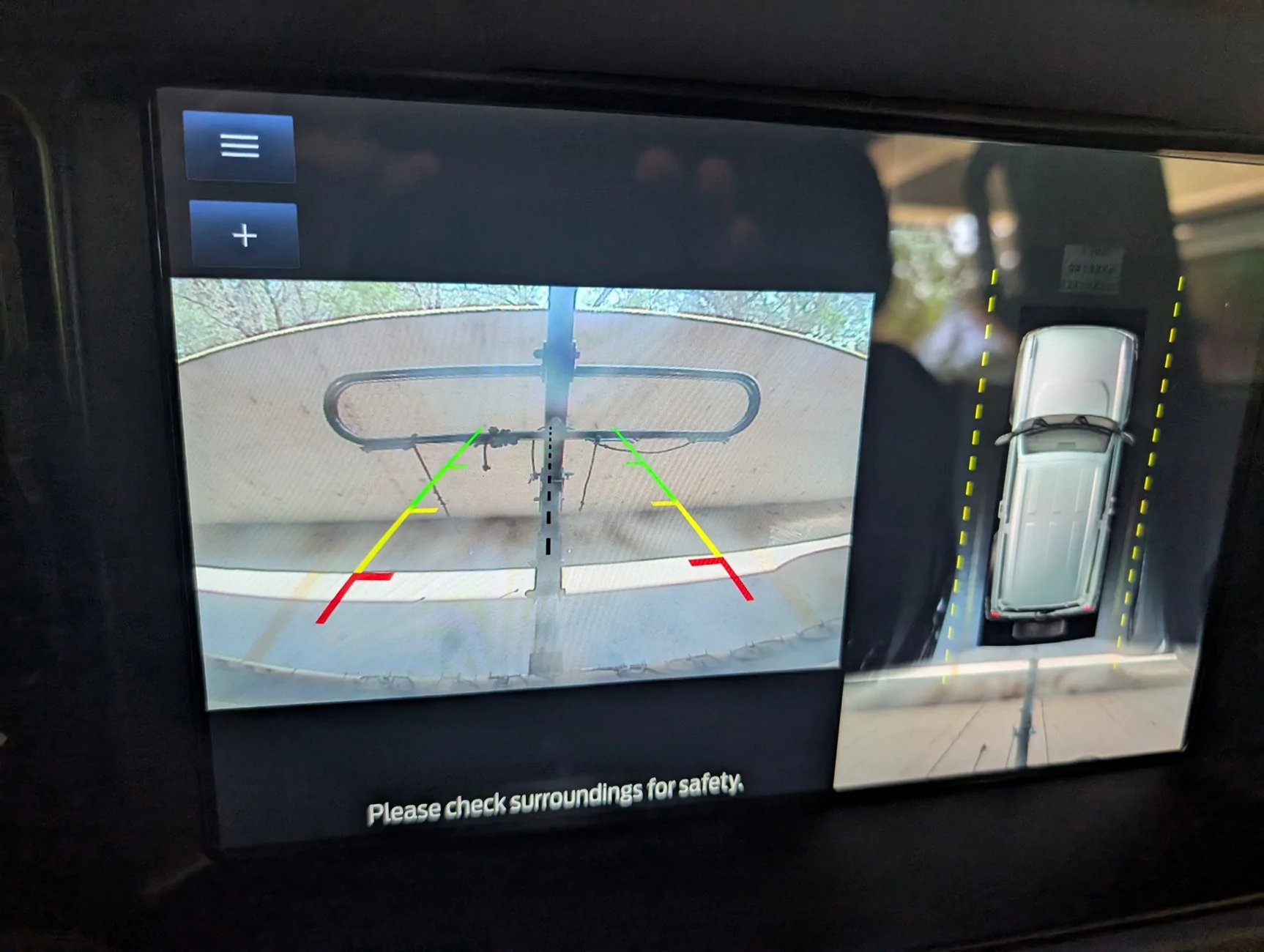

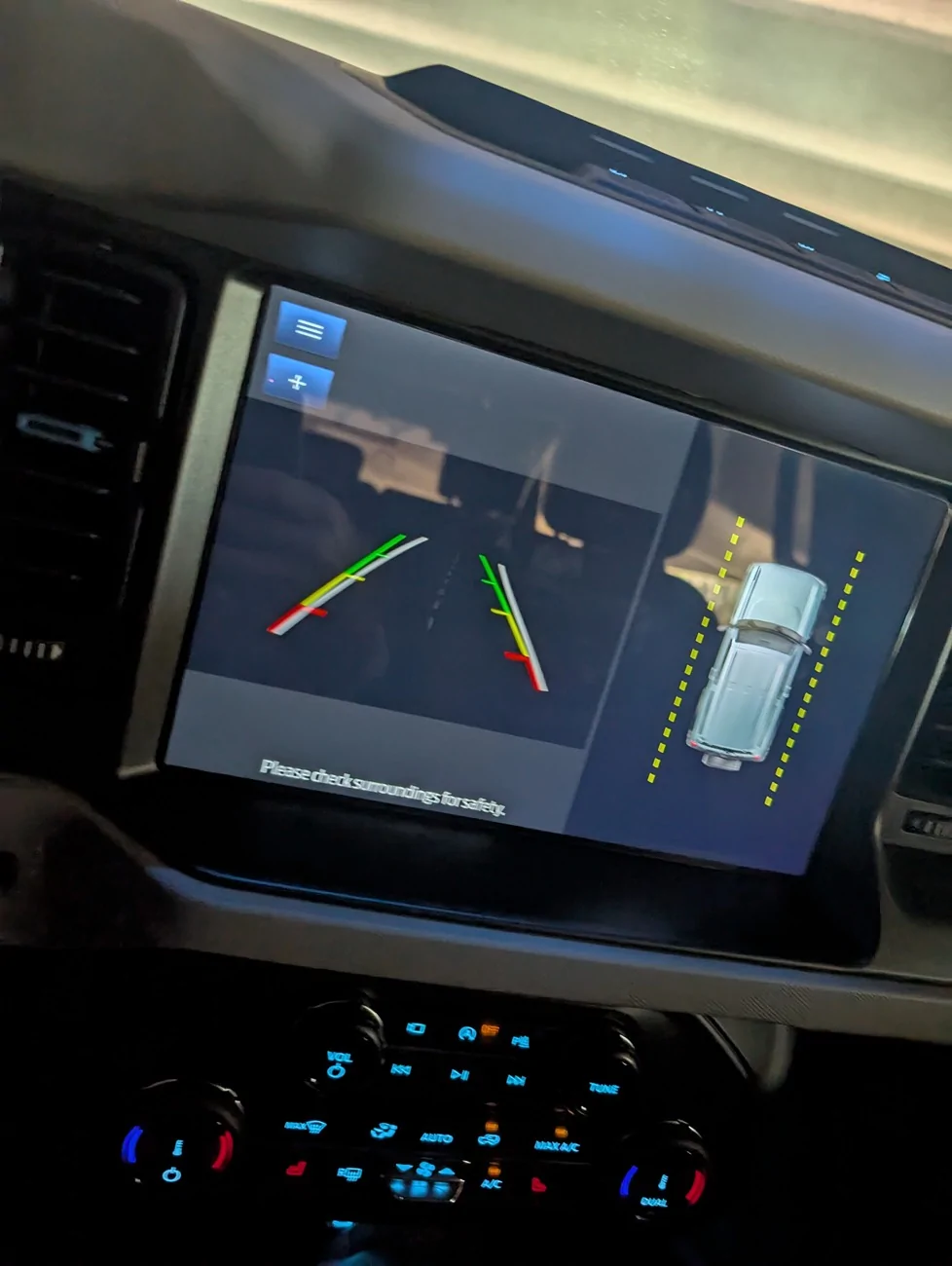

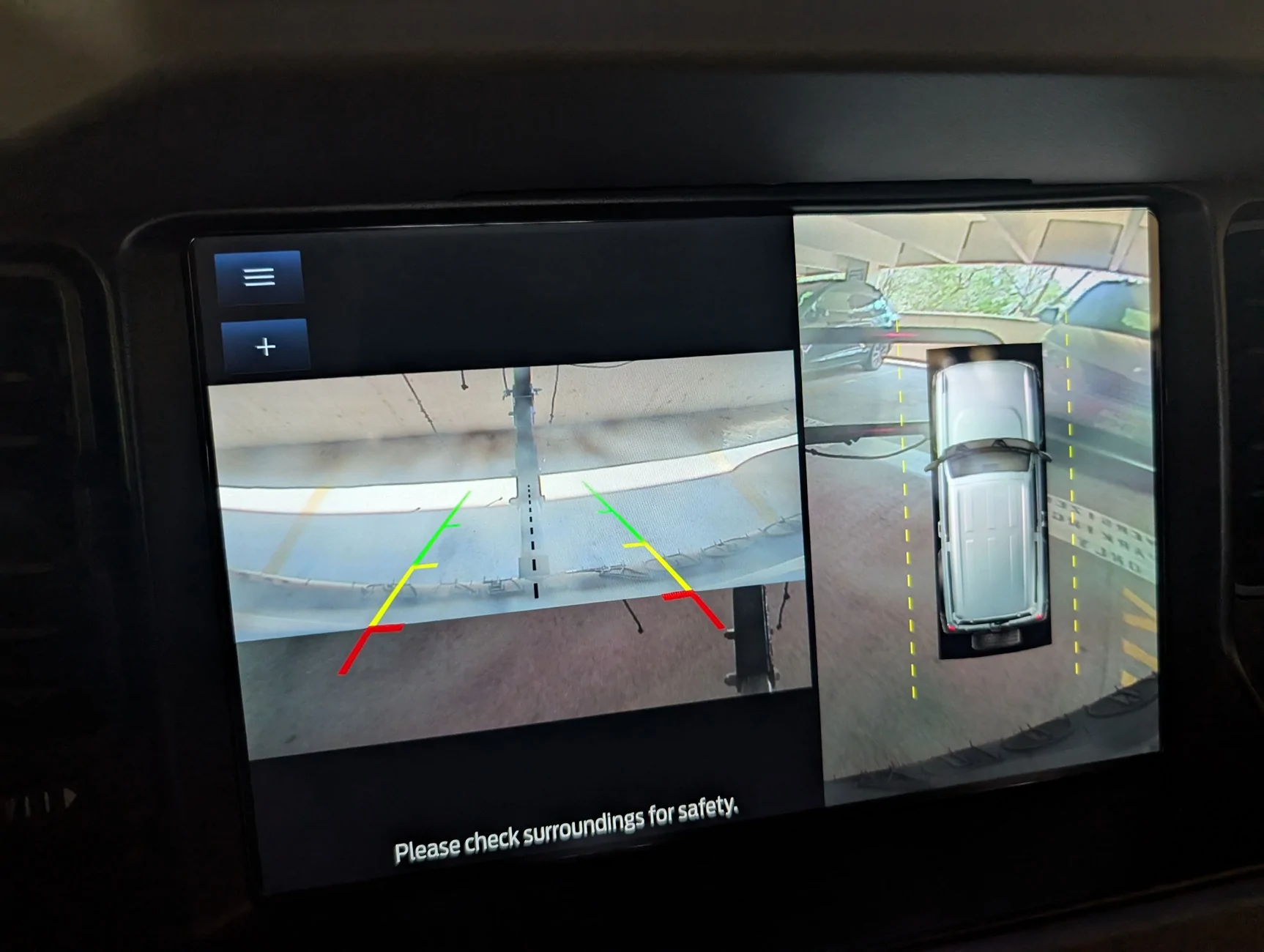

Just had software TSB on my 2022 WT...had 3 different issues just today (less than a week after getting it back).
Ford Bronco New Recall #23S48 - REPLACE REAR VIEW CAMERA PXL_20250918_160120015.RAW-01.COVER
Ford Bronco New Recall #23S48 - REPLACE REAR VIEW CAMERA PXL_20250918_160017998.RAW-01.COVER
Ford Bronco New Recall #23S48 - REPLACE REAR VIEW CAMERA PXL_20250918_160141474.RAW-01.COVER
