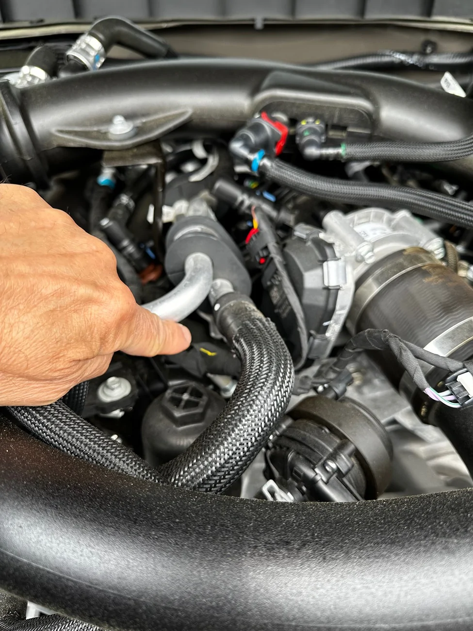

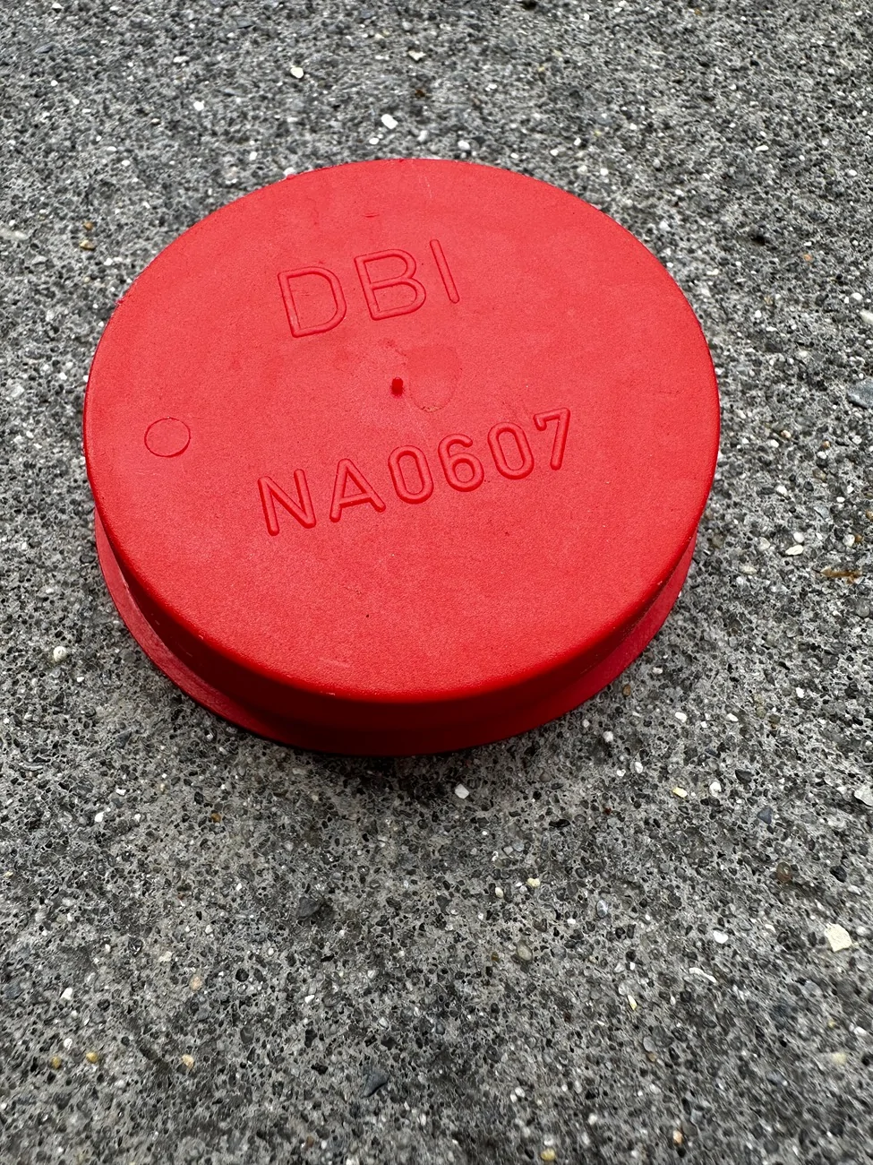

Checking under the hood of a MY25 Braptor and found this protective cap (1st photo) wedged in the top of the location I am pointing to in 2nd photo. DBI seems to be the manufacturer of this cap that online searches seem to say the cap is used to protect hoses and hydraulic fittings. No vehicle issues noted - is it just a leftover from the vehicle assembly or something else that has fallen off? Any guidance appreciated.

I'd bet it's a leftover as you suggest.
Assembly worker has zero time to search for an errantly dropped cap.
Not hurting nothing .... until it catches fire.

Based on the image that you provided, this is a protective plastic dust cap/plug manufactured by DBI Plastics (indicated by the "DBI" stamping). Specifically, this is a heavy-duty shipping or assembly cap used during the manufacturing and transport process of automotive components to keep dirt, moisture, and debris out of sensitive areas. These caps are typically used by Ford or its tier-1 suppliers to seal off factory components—such as large chassis openings, suspension components, steering gear housings, or axle tubes—before the vehicle is fully assembled. It is incredibly common for assembly line workers to pop these off right before a component is bolted together, but occasionally they get trapped in a crossmember or frame rail and ride along all the way from the factory. If you've recently been working under the vehicle, installing aftermarket parts, or if the vehicle is relatively new, it likely just jarred loose and fell out of a hidden pocket in the undercarriage. It is a disposable factory shipping item, so you don't need to worry about replacing it on the vehicle!

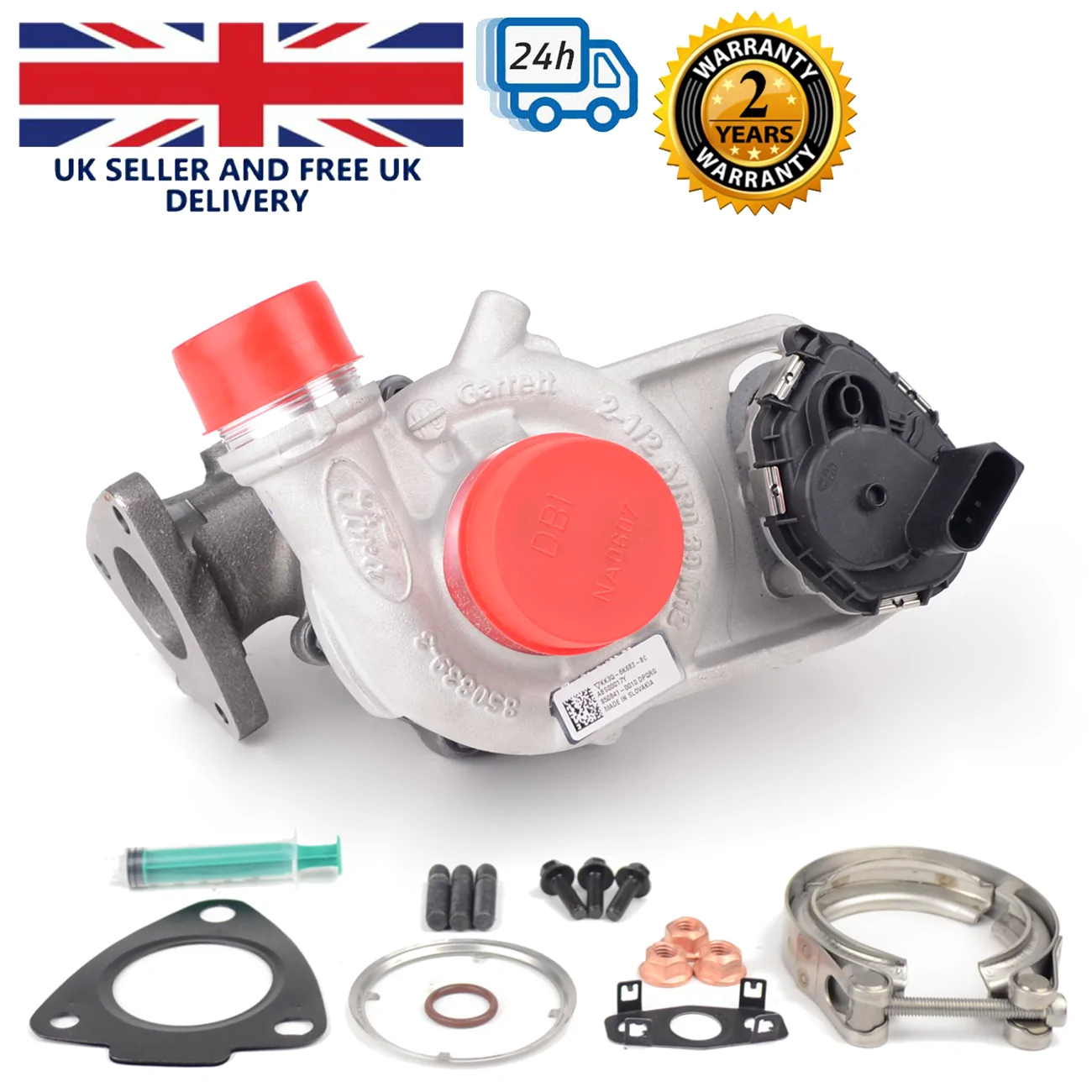

Probably was on the turbo before they connected the intake piping.
