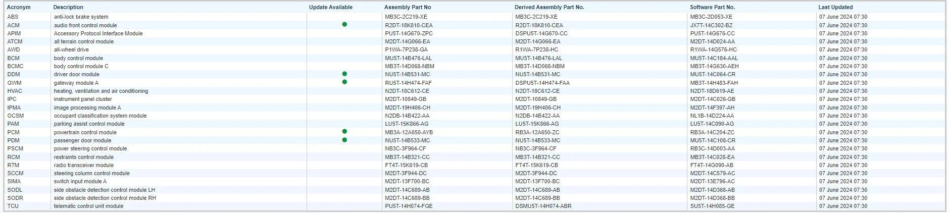

Post or send me your VIN and I can check.
Can you check mine? Same issue but with a 24 BD. Auto updates setup and everything and not one update yet.

Your truck being a 2024 was built with a lot of the software you'll see talked about on the forum already. Your truck is on Sync 23237 which is a new version and you are only showing a few pending updates. The door module updates you see below are the ones this thread is about. Your truck is talking to the cloud just fine and is reporting no codes, so it seems happy. You aren't getting sent updates because there is little to update on your truck. I don't see anything to be worried about, tbh.

Thank you so much, was curious about that. My truck was a 2022 and seemed like a ton of updates were coming through so I was curious about the lack of updates on the bronco. Thanks for putting that worry to bed.

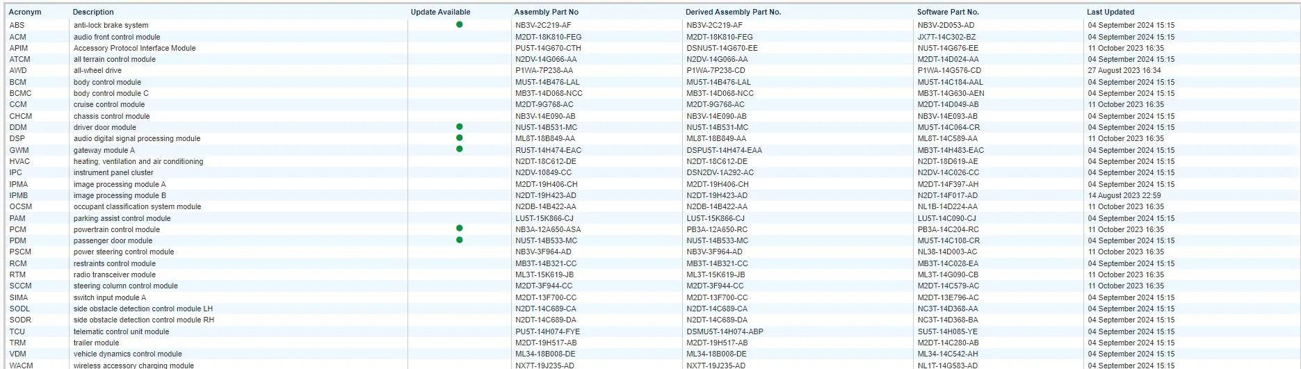

Any chance I can bug you about mine?
1FMEE5JR2PLB778034

I was able to get my access back. Modules pending updates for your truck are below:
Thank you sir! I talked to the OTA phone line yesterday and she said that I’m one update behind and to give it two months. Doesn’t seem like I’m too far behind then? She said I’m on 23151 and need 32391. It looks like I got updates on 9/4? I’m assuming some updates just happen in the background?

No, ignore that column to the right. That refers to the last time that particular module reported it's status to the server; not when it was last updated as far as software goes. OTA dashboard does not show any recent OTA activity for your truck. Not far behind at all.
Correct; you are on Sync which is one version behind the latest for the Broncos. 23291 is the latest version and that will come with OTA 6.3.0. You need the GWM update to come in first and that will release the APIM update for the latest Sync software.
