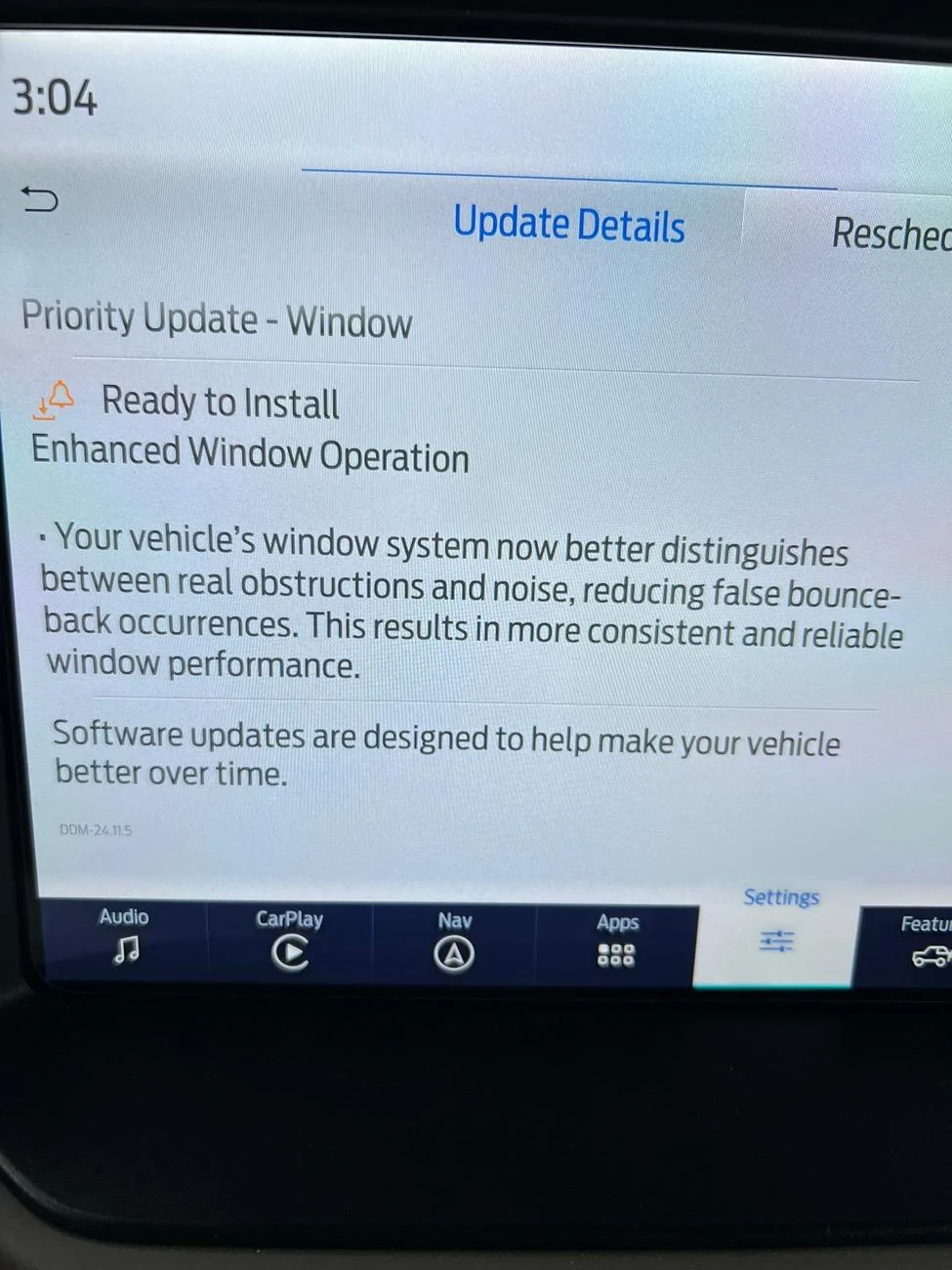

Anyone else get this message or update?
After I received the update on my '23 OBX I noticed that certain windows were not closing all the way. I would have an issue where the window would drop slightly but not return up. Also, I noticed that when I opened the doors, the windows would not always drop which required me to manually push the edge of the window under the seal from time to time. When I took it in for service, they found some outdated module firmware and applied article SSM 52479 ( 2021 Bronco ). Windows seem to work fine now.
