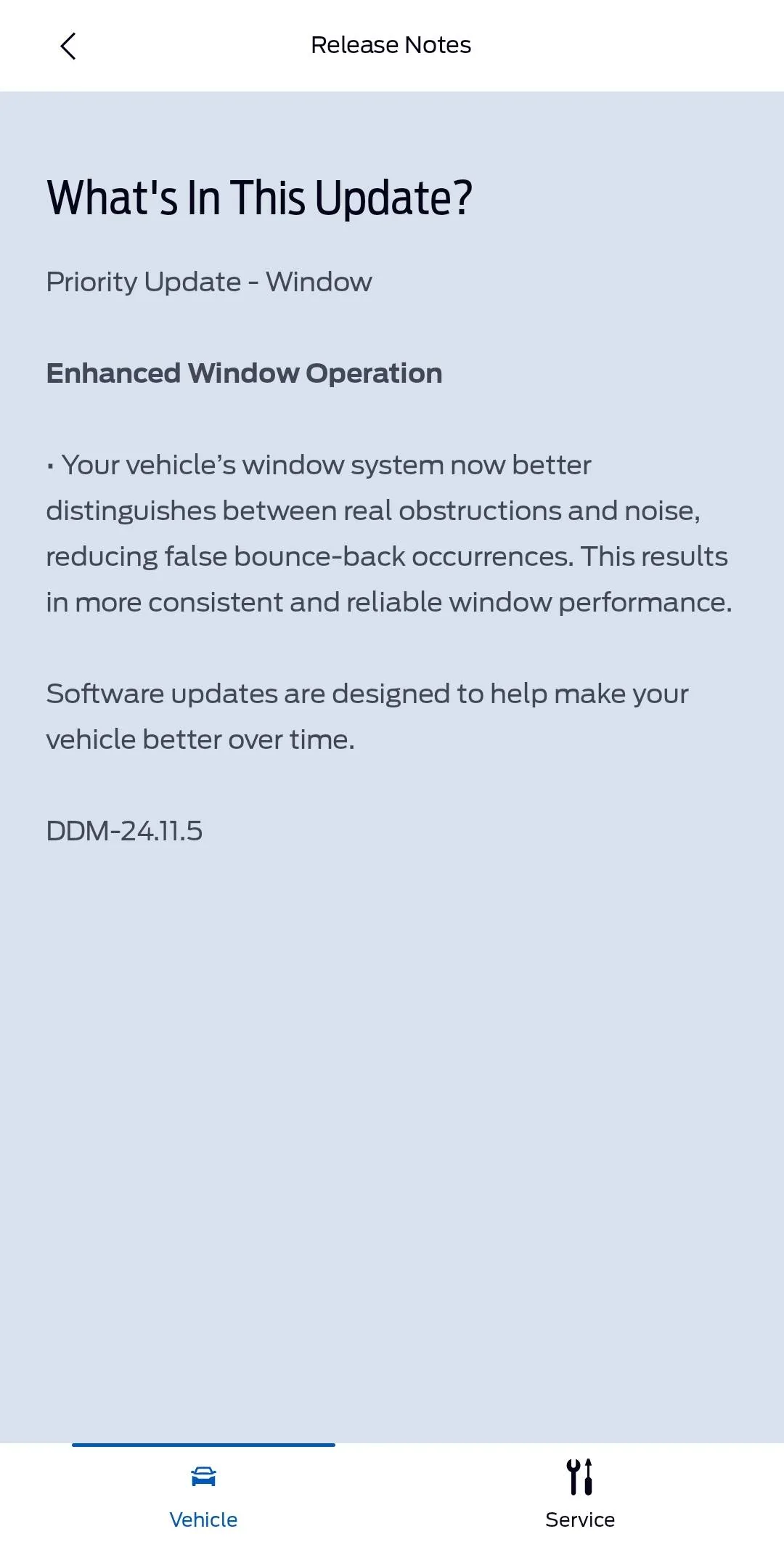

overnight I got this update:
Ford Bronco Update complete--DDM-24.11.5 for "Enhanced Window Operation" Screenshot_20241207_112116_FordPass

I actually just got this yesterday too. 23MY
Does this update correspond to a numbered update (ie, 10.1 or whatever)? I’m trying to avoid this one because I believe it takes away the window drop feature upon unlocking with the key fob, which I love and still have on my 2022 BD.

I’m not good with updates, but I got 10.1.1 a few days ago and then this one which had the DDM number like in OP

As an aside, I think one of the things this DDM and the PDM update did was eliminate an update from awhile ago that @RagnarKon posted a video about (where you could via FDRS set all four windows to drop that 1/2-inch when you pressed the unlock button the fob). See:
I say this b/c I tried to apply what RK talked about in his video by recently applying these new PDM and DDM updates that were available to me via FDRS. But the updates did nothing different than what I already had. Meaning (to me), that it deleted, among other things, the earlier available "1/2 inch down when press fob" option (which RK confirmed in a different thread; that the option was no longer available).
So maybe the update does some other stuff, but it definitely deleted the "1/2 down" option.

It's not supposed to. It was added to some vehicles midway through 23MY. Some were able to add it after that with an update, which is now gone.

Yes, Ducati is correct. I got the dealer to add the window drop feature to my 22 last October through a DDM and PDM update. The latest OTA update now eliminates the drop feature. I love the drop feature, and still have it, so I’m trying to avoid the new update as best I can.
