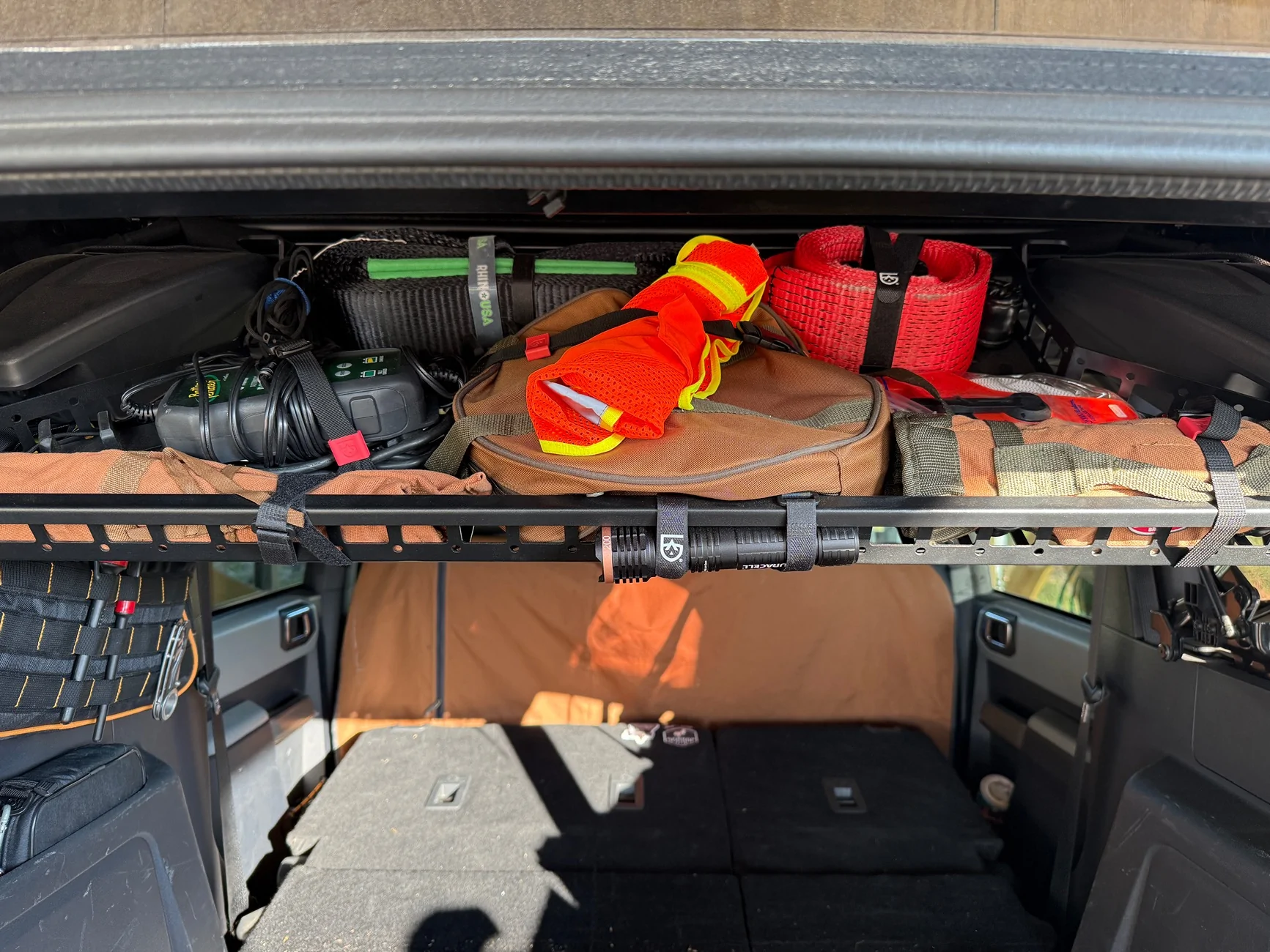

How is the access with the top in place from the tailgate, please? The hardtop obviously has plenty of access with the flip-up window. Our soft tops would appear to be an exercise in frustration. TIA.
I have the IAG soft top assist so my rear window goes up higher than the factory prop rod. I’m able to easily get to the entire shelf in the lowered position. I have things in the basket as well as stepped to the front and I underneath.
I’d recommend getting the IAG lift assist even without the shelf.

^ Everything this guy said. Plenty of easy access to stuff both above and strapped below the shelf. It really is the most useful mod available for the Bronco.

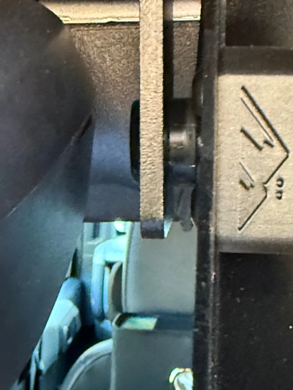

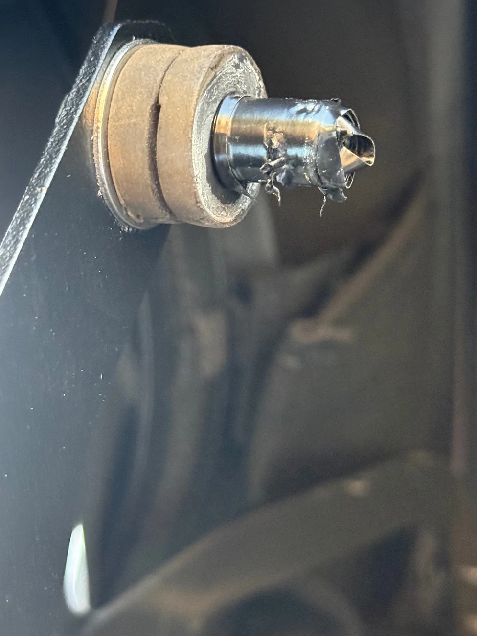

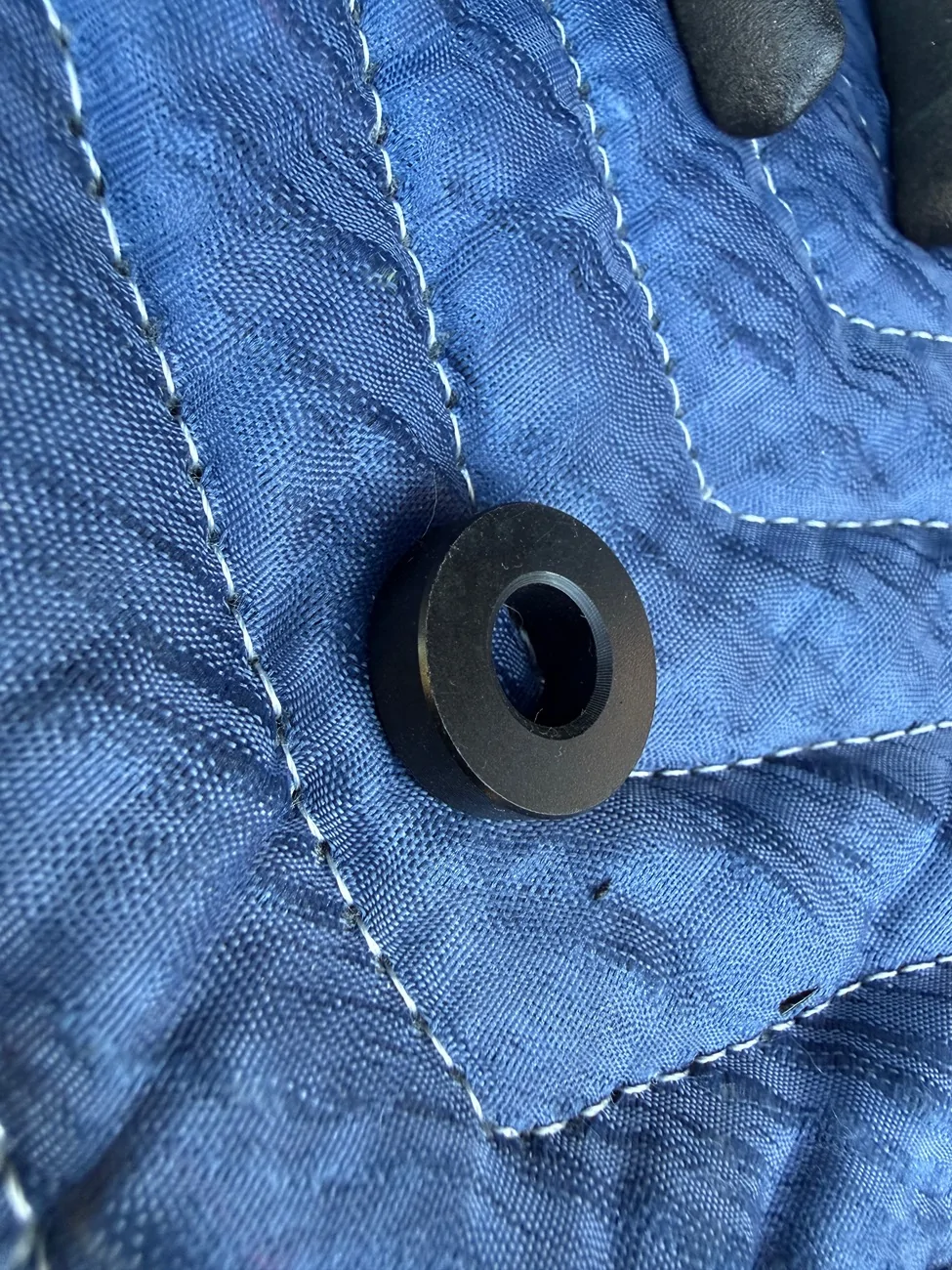

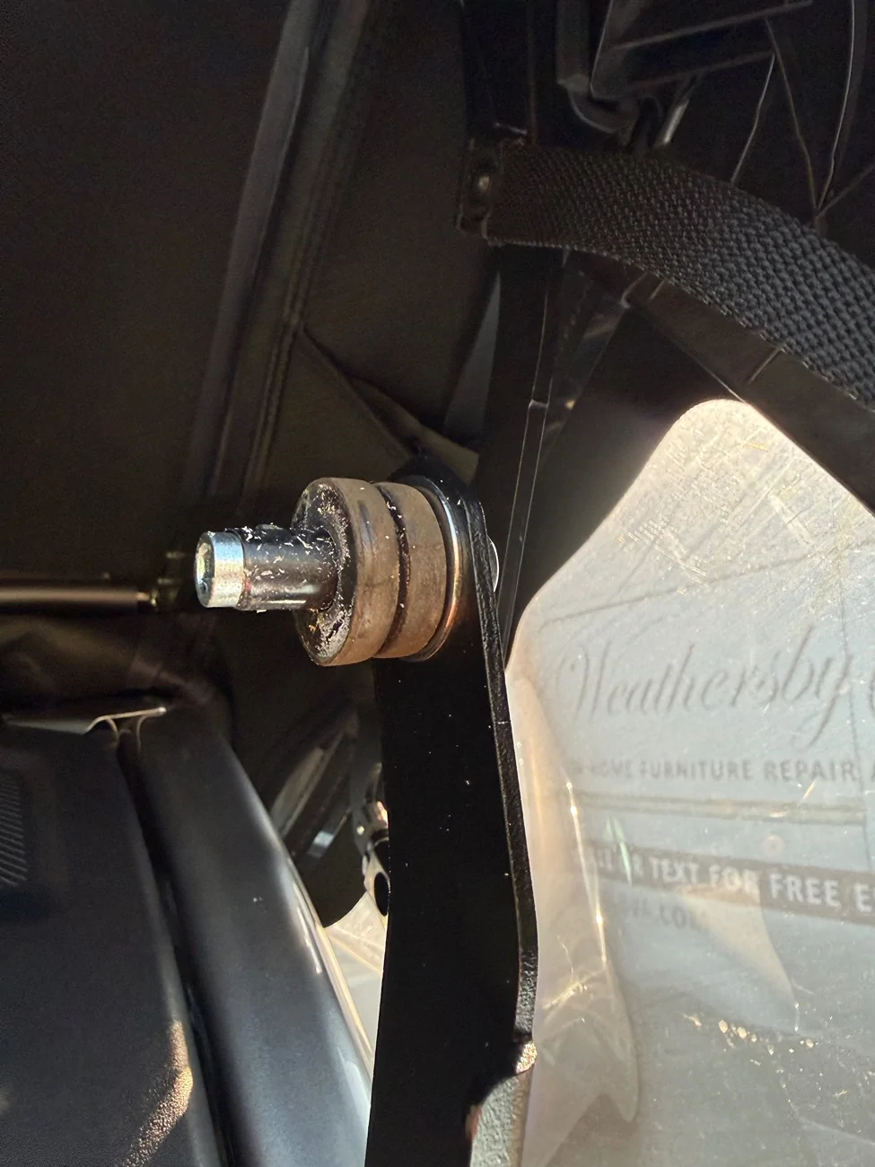

I got it installed and it rattled, as others have noted. I had to adjust the driver latch down (4mm Allen) and tighten the same post (5mm Allen and 13mm wrench). I added 6 wraps of Scotch 33 electrical tape to that side and 3 wraps to the passenger. I also added a motorcycle fuel tank mount bushing to each side of the latch post to dampen movement.
At the hinge, I added 1/4" thick, 3/8" ID, 1" OD nylon washers to keep it centered. The post is probably 10mm since I had to waller out the ID a bit with a 3/8" drill bit to get it on.
No more major movement now but the driver latch still has a bit of play (1/16-1/8").
All this said, this is still a good investment, and I would do it again. Engineering and making something always involves learning and tradeoffs. This is a great balance of both.

I installed Harbor Freight Marine Grade shrink tubing over the latch pins. It's a perfect fit even without shrinking it. Also Teflon washers I bought from McMaster-Carr for the hinge pins. The shelf is silent.
https://www.mcmaster.com/95630A487/
