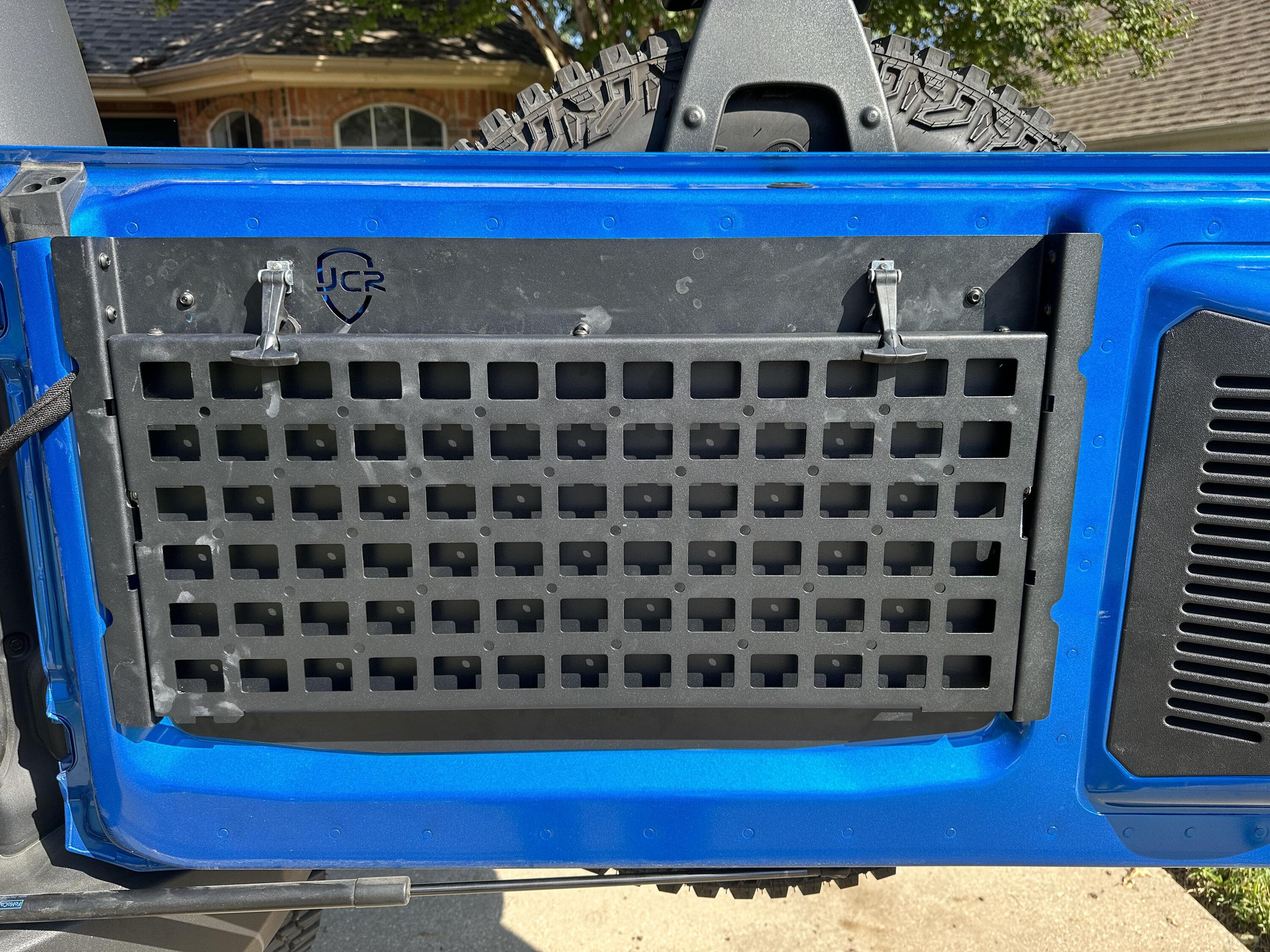

anyone have issues with the fit of the molle backing. I got to the step where I need to fold it shut and adjust the rubber latches, right before you mount it to your door. it won't fold flat. it seems warped or something.
The solid panel tabs may have to be coaxed into their receptive slots, the powder coating might be a little thick on the tabs but once you line them up it should work itself in….or at least that’s happened with mine and it’s fine. Love the product from JCR!
It’s designed with a tight interference fit on purpose to minimize rattle. Watch the addendum at the end of the installation video for guidance on the step that @Cbiggs is describing, and you will get it to fit tightly and appreciate the fact that it won’t rattle after installation.

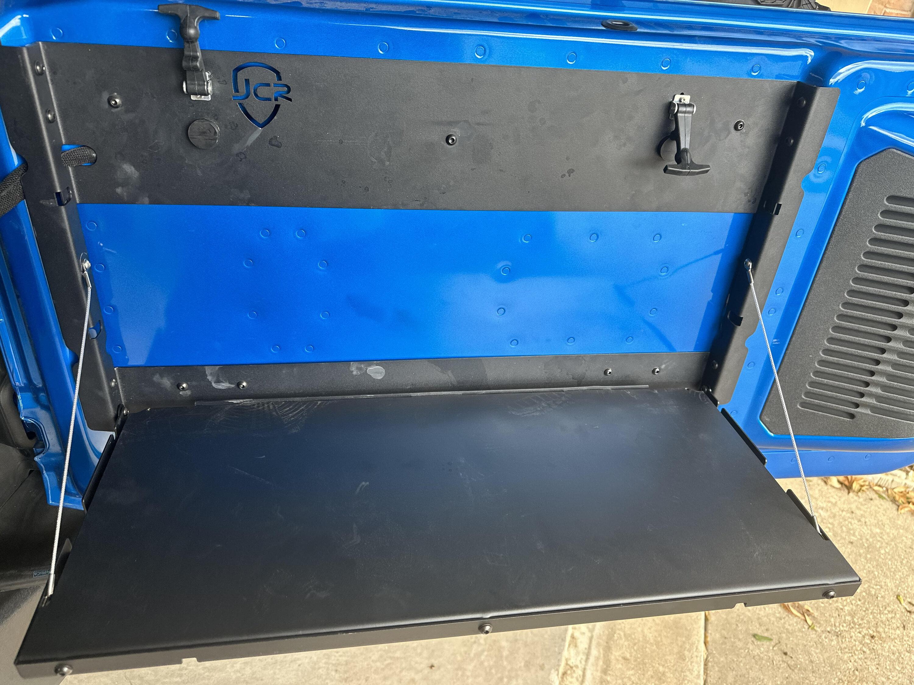

It is in. It is filthy and I can't figure out where the rattles come from, but it's in. The wires tuck with a little bit of a suggestion from your hands but it's not any kind of problem. I've seen others have trouble but they go into their respective slots if you just take half a second and guide it a touch.
I wouldn't buy it again.

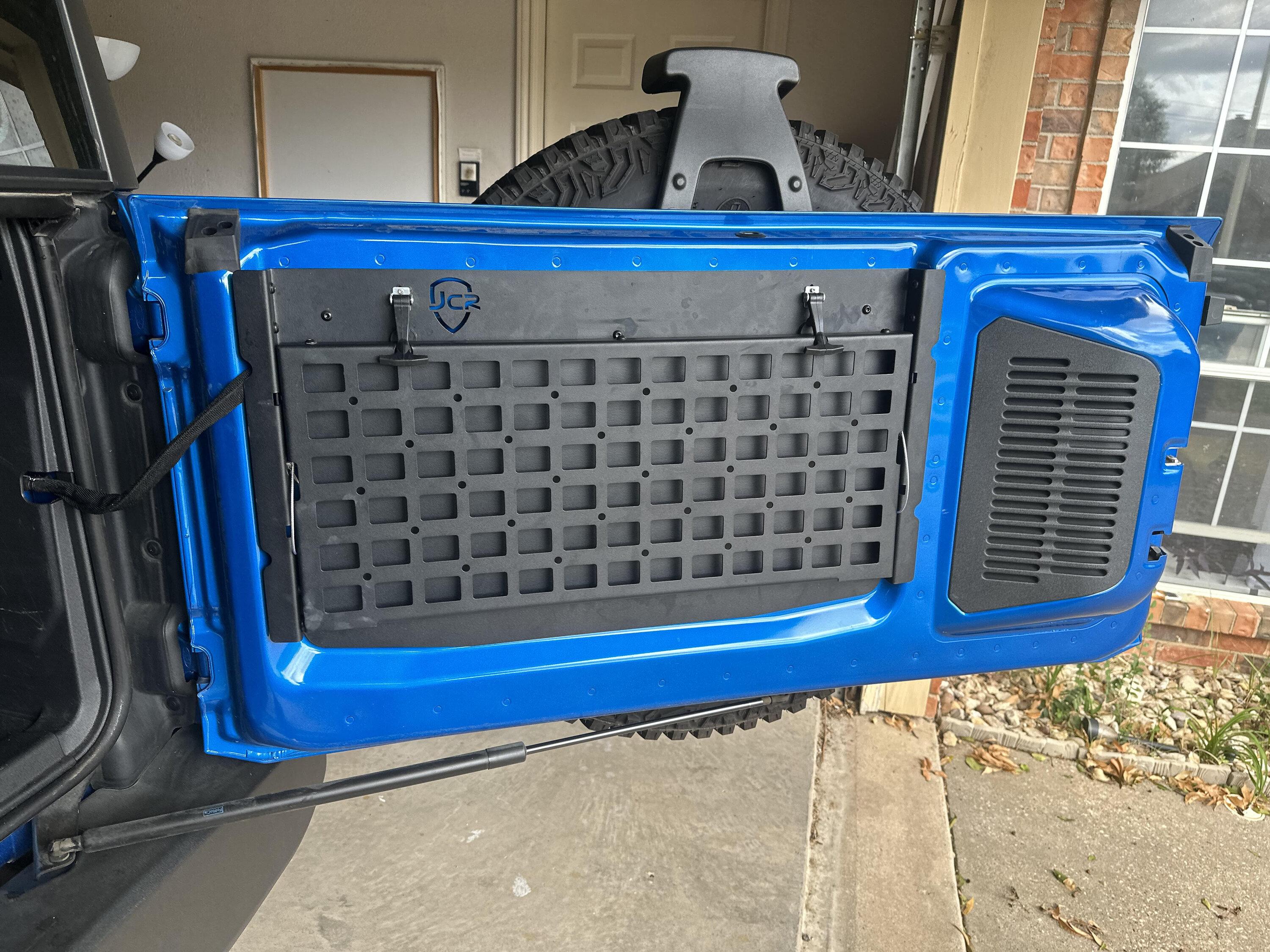

Mine did develop a slight rattle. I just added a little clear caulk in the very tight gap between the table top and frame. Not visible and solved the problem.
