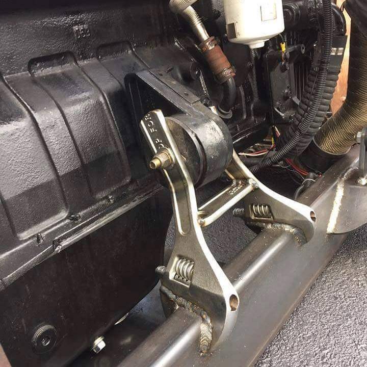

Yes, some mounts do have fluid. One of my Mercedes has these.
That's crazy!
On the other end of the spectrum is this low-tech option:
