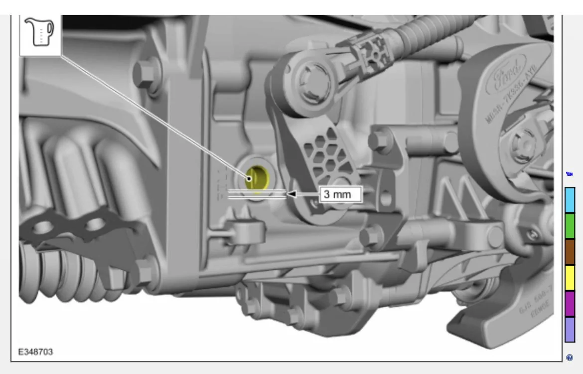

On the fill, are you going to do the 2.5 quarts or fill up to the bottom of the fill port? I've seen both, same with the Mustang MT82. Full is actually about 1/2" below the port.
Assuming if it’s brand new, there won’t be much residual left. So the 2.5 or to the fill. Whatever comes first.
I'm assuming overfilling to the bottom of the hole will not hurt anything like it would in an engine? Would just blow out the breather if an issue?

Ford Bronco Manual Transmission Fluid Garbage AD456004-5161-4B0C-AF73-E47165B1F294
“2.5 qt* - Approximate total oil/volume capacity. Actual amount could vary between fluid changes.”
I feel pretty safe on my fill. I would just give a few extra pumps after I reached what I thought was the 2.5 mark until a little dribbled out when I was removing the nozzle.
