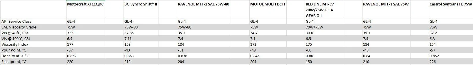

Gotcha, I get deep in the rabbit hole on this and then seemingly snap out of it realizing that in all reality I'm splitting hairs here. For example, the running spreadsheet I'm keeping.
Ford Bronco Manual Transmission Fluid Garbage Captur
@kodiakisland, still feel that the change to Redline is only different? No better or worse?

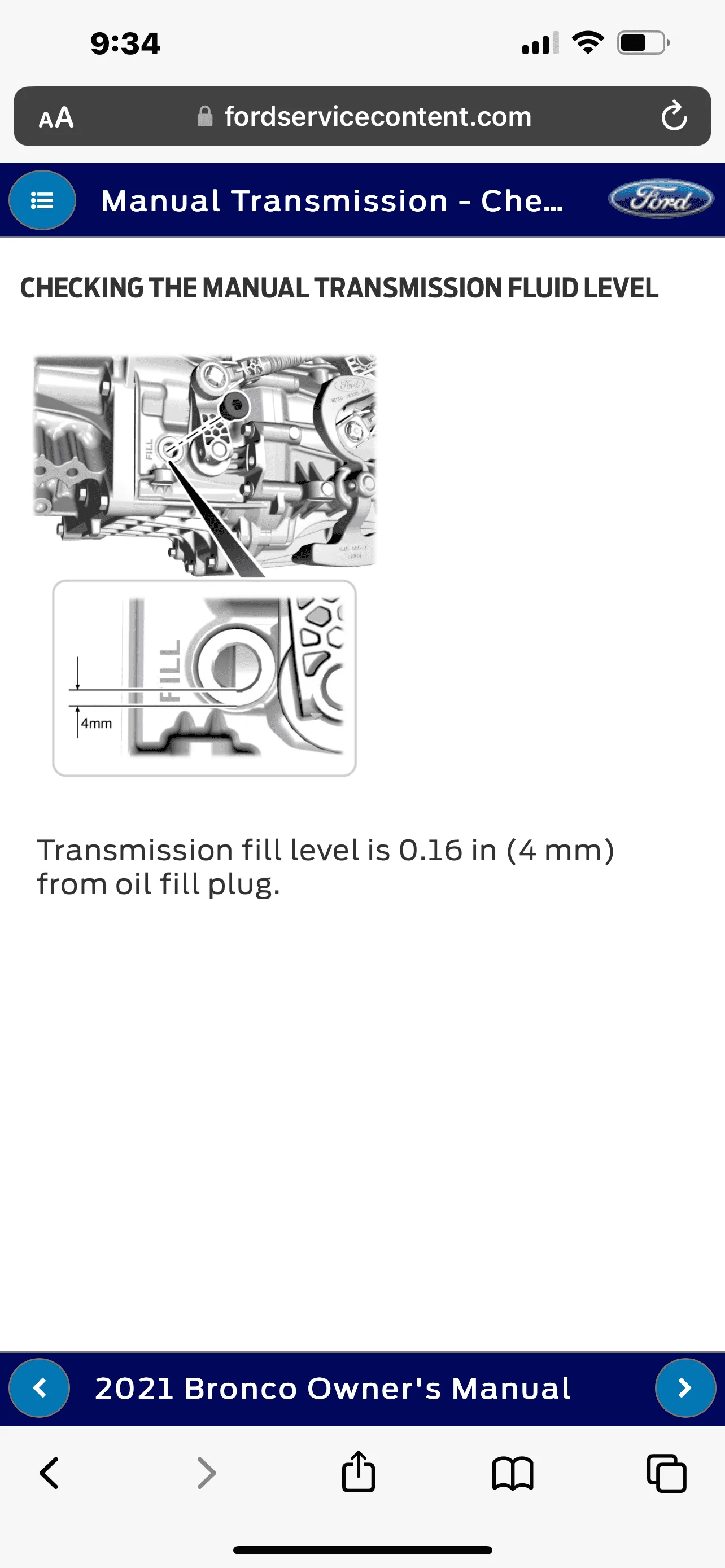

I believe the service manual says 4mm from top
What kind of fucking injuneer comes up with "4mm from the oil fill plug"?!?
Fucking non-gear-head bookworms!!!
No one should hire dipshits like this...EVER!!!
