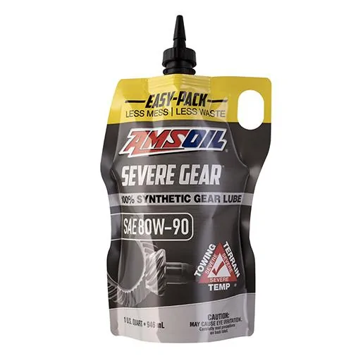

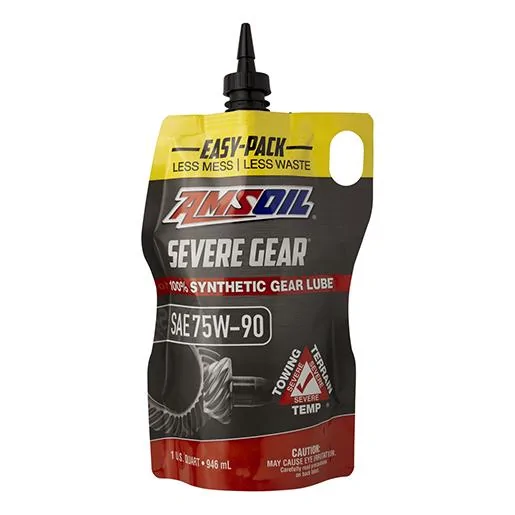

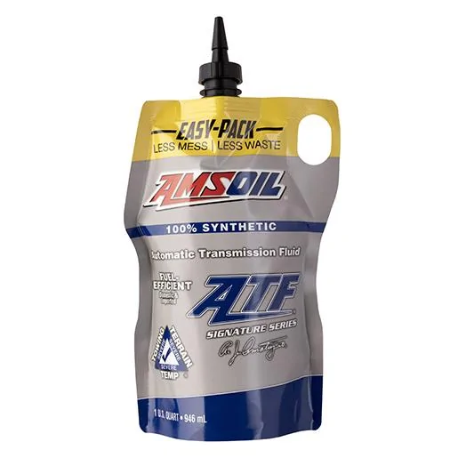

While we’re on the topic of gear oil…what about the rear diff? I’m about to change mine…I got a bottle of the Motorcraft…but a happy to be educated.
Amsoil 80w90 in the front. 75w90 in the rear. Amsoil ATF in the Tranfer case. Just did wife's Bronco and my F150.
I used Amsoil on mine but elected to use 75W-110. Kind of a middle weight between the recommendations from Ford and Dana.
