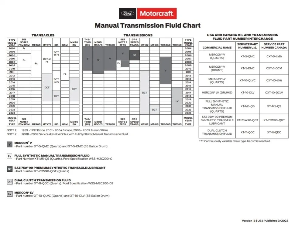

Please be careful what you are suggesting. "GL-4" is a gross generalization of what Ford is requiring for transmission fluid. Once you're out of warranty throw in whatever you like, but if you're wanting them to cover any failures, please use the exact specification of transmission fluid they require.
I have attached my previous posts (from page 1 and 2 of this thread) which document Ford's requirement for the MT-88 transmission and offered a few fluids which comply with their exact requirement, which is "WSS-M2C200-D2".

Edit to post Ford's recommended transmission fluids for MT vehicles.
In trying to assist further on other transmission dual-clutch fluids which meet Ford's WSS-M2C200-D2 standard, there are no Amsoil products currently meeting this requirement. EDIT: plugging in the Bronco to use Amsoil's search function will not document DCT as an acceptable fluid even though the tech sheet on that fluid indicates it meets standards.
Redline offers their MT-LV which meets the requirement despite being 70w75 instead of 75w80 as implied by "WSS".
https://www.redlineoil.com/mt-lv-70w75w
And what I intend to use on the first fluid change is the updated version of the tried and true BG Synchroshift (now in version II) which meets Ford's WSS-M2C200-D2. This was the stuff of legend in my old Evo days and is a real miracle worker for helping brass synchros work snicker-snack smooth and silky. Cold temps tend to be an issue for this fluid which is why they blended it with MT90 back in the day, I'll do a 66%/33% blend of BG SSII and the Redline MT-LV.
https://www.bgprod.com/catalog/driveline/bg-syncro-shift-ii/
