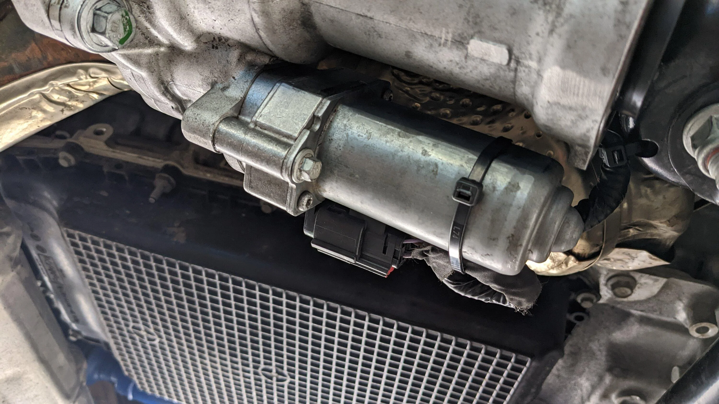

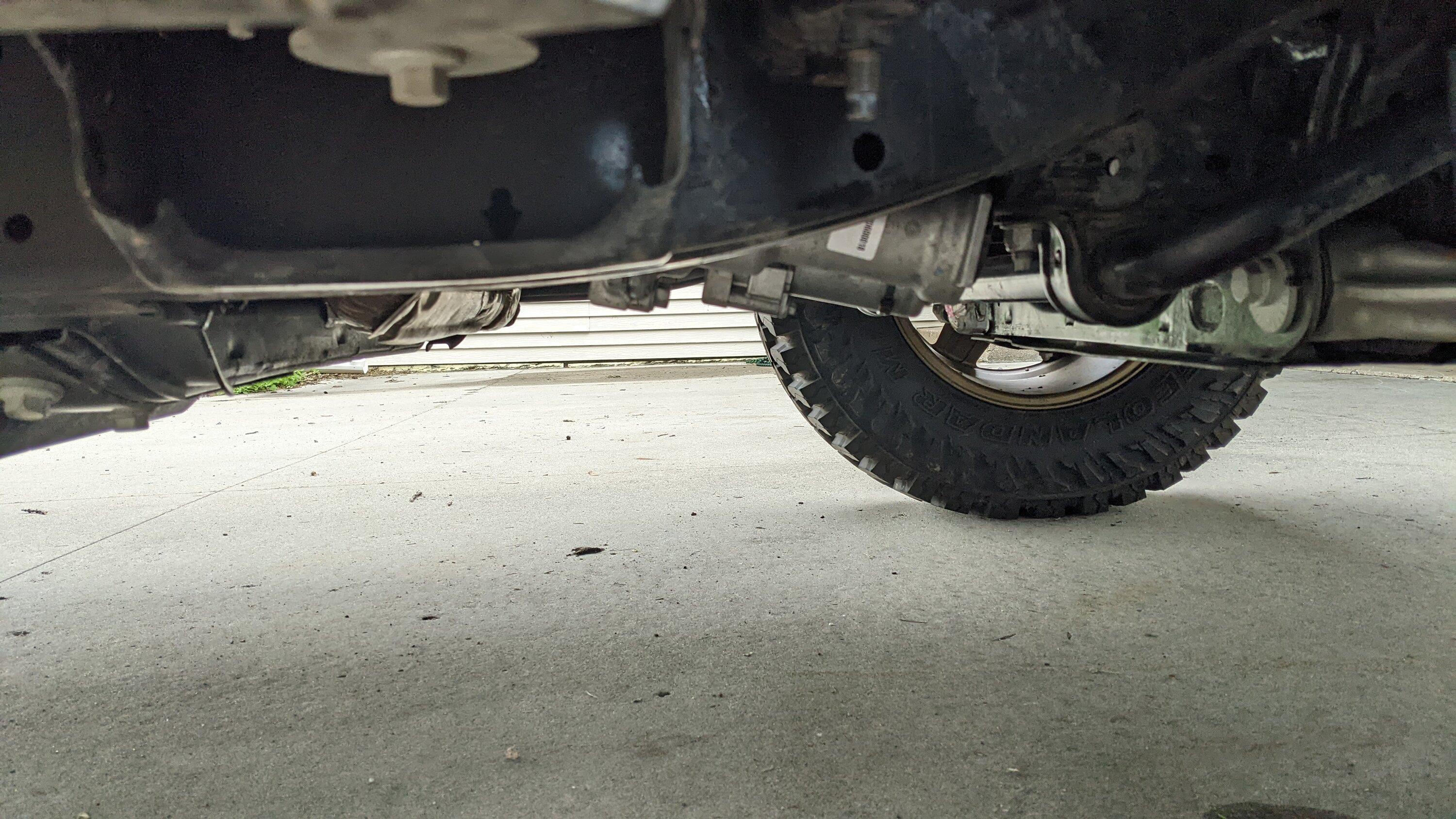

I'll have to see how warm this gets being next to the exhaust. It might need some header wrap or maybe just heavy foil.
Certainly not ideal for serious rock crawling, but it gets 4wd working again, and that was my primary objective until a proper FAD delete can be done.

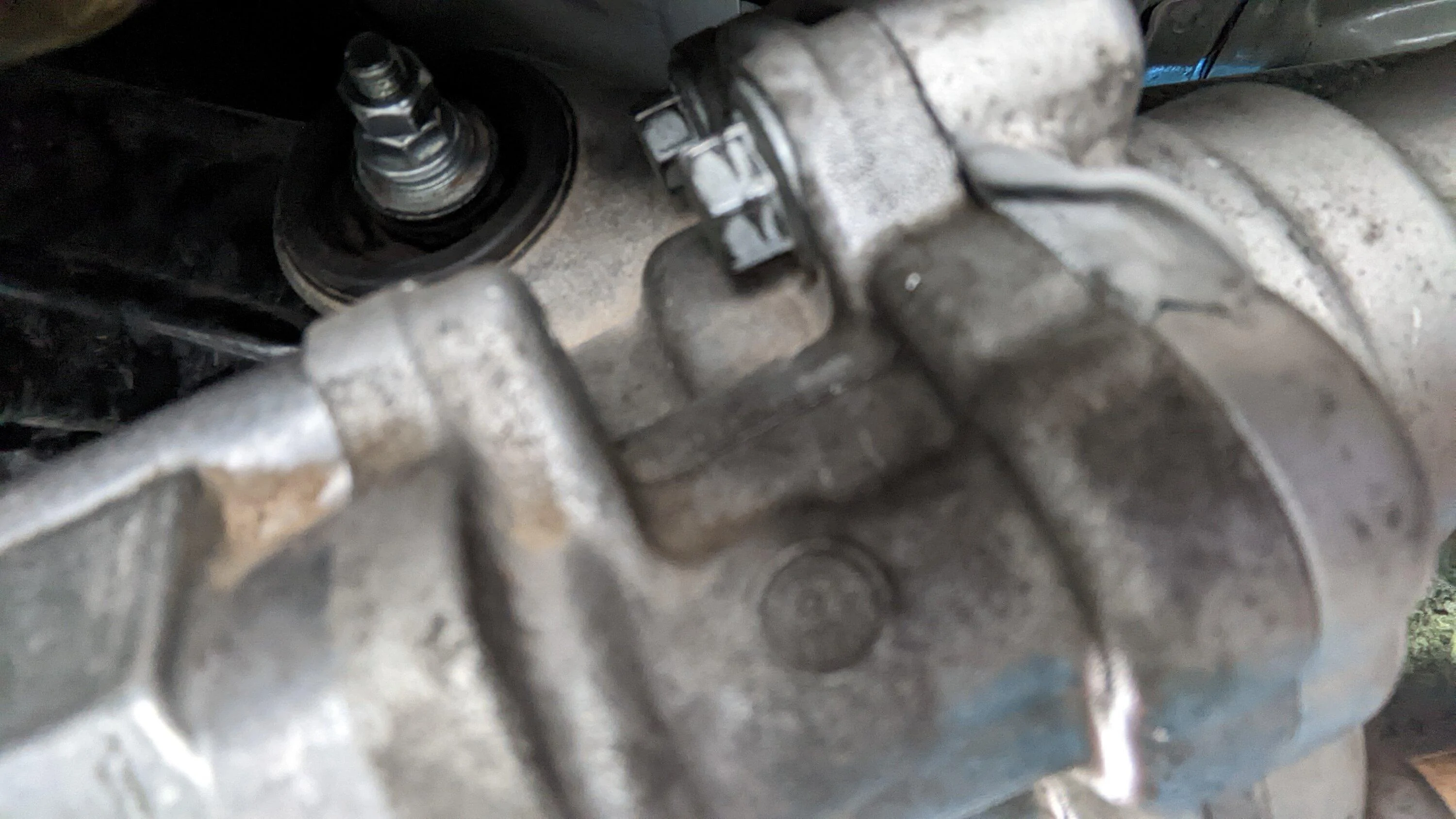

A couple zip ties to snug it up (it's bolted through a very flexible bushing after all) and tidy the harness.

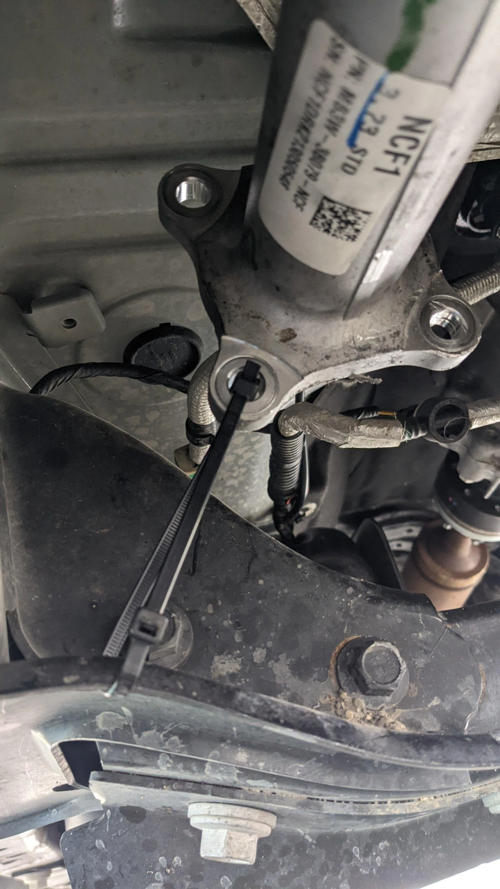

Ready to roll!

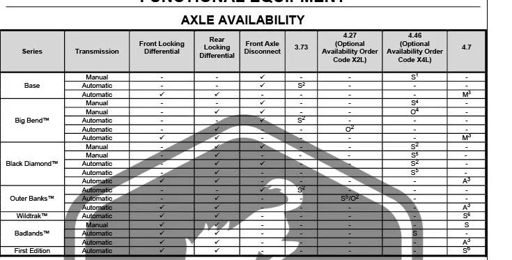

Here is a useful graphic too, to outline who and why one of them have the FAD.

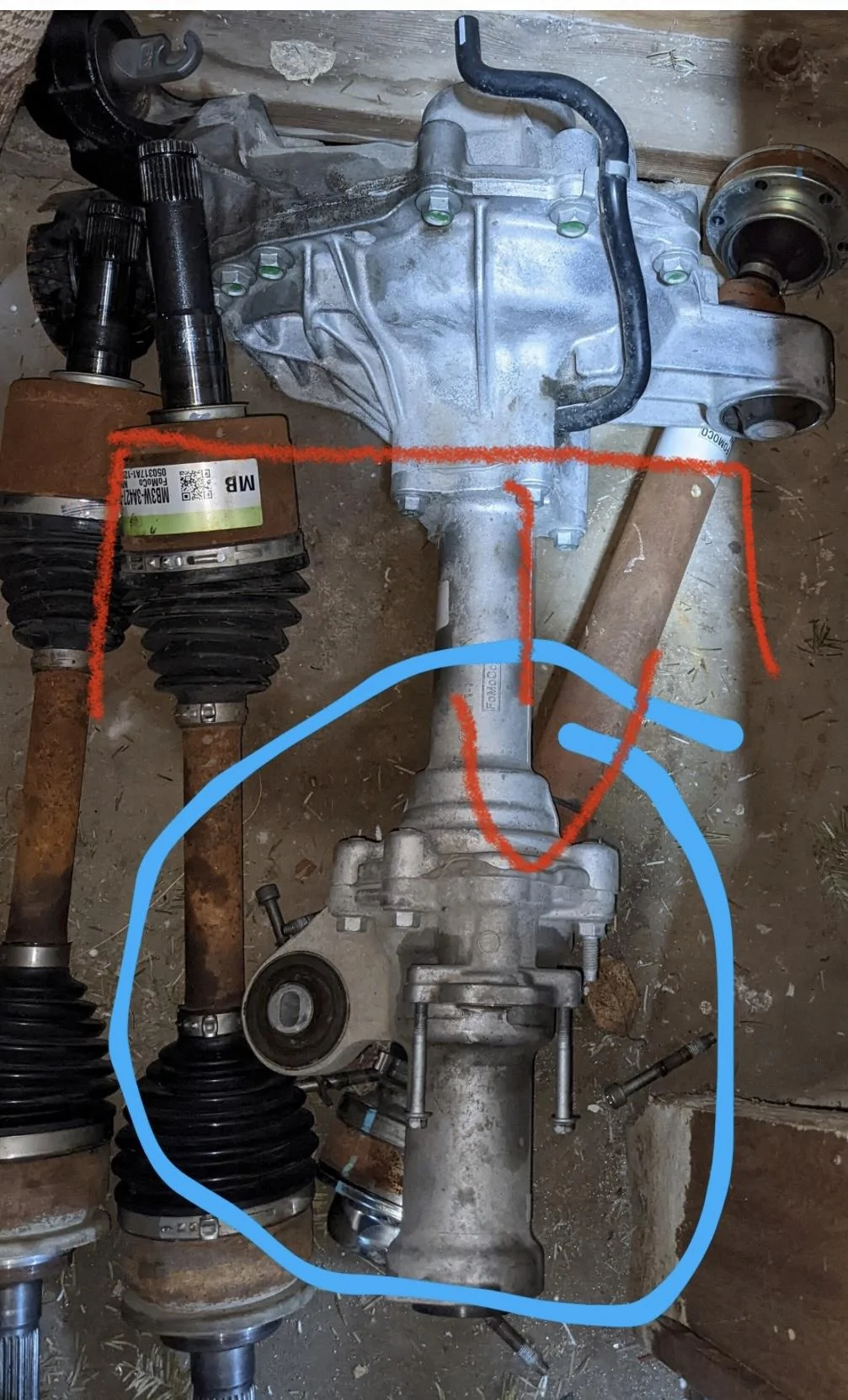

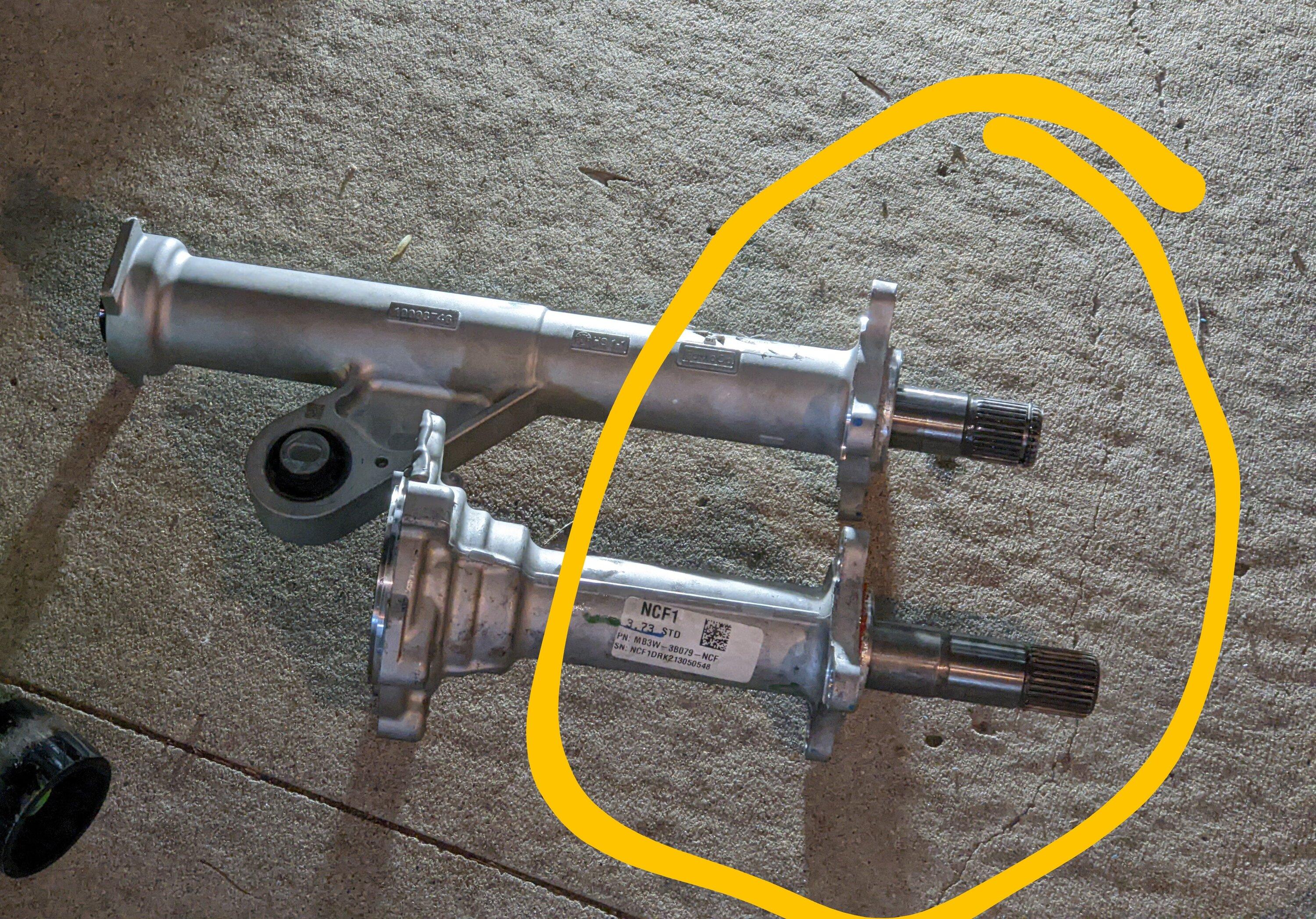

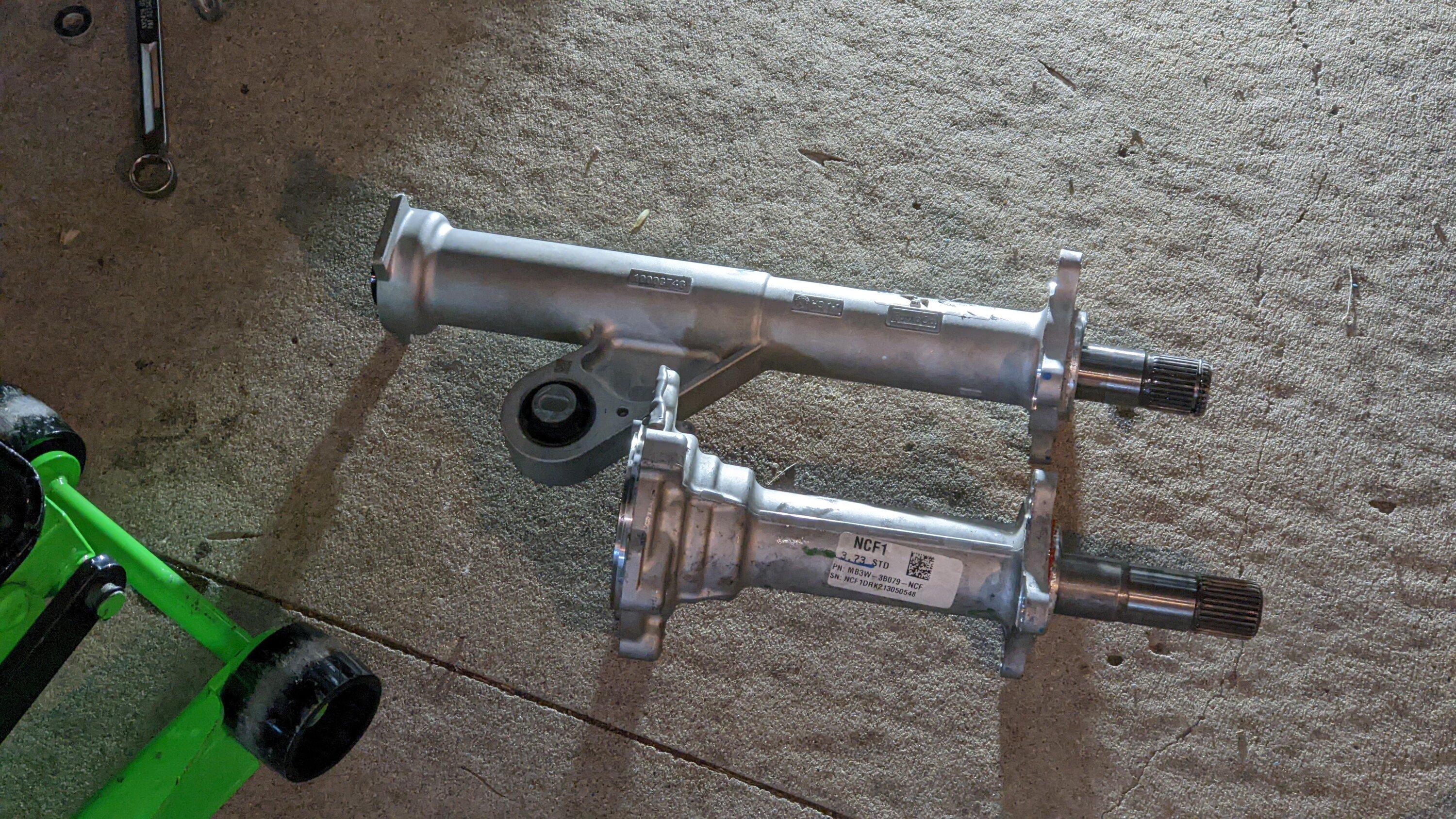

Well, the FAD off the m190 Does NOT fit the m210...
At least not without cutting the intermediate shaft down about an inch and resplining the outboard end.
The shafts are 29 spline. CV axles will interchange. The housings even match up. But the innards are a no-go.
Thanks for this thread as I was planning on the same mod to my black diamond. What internal part didn’t match? Could the entire right shaft assembly be swapped?

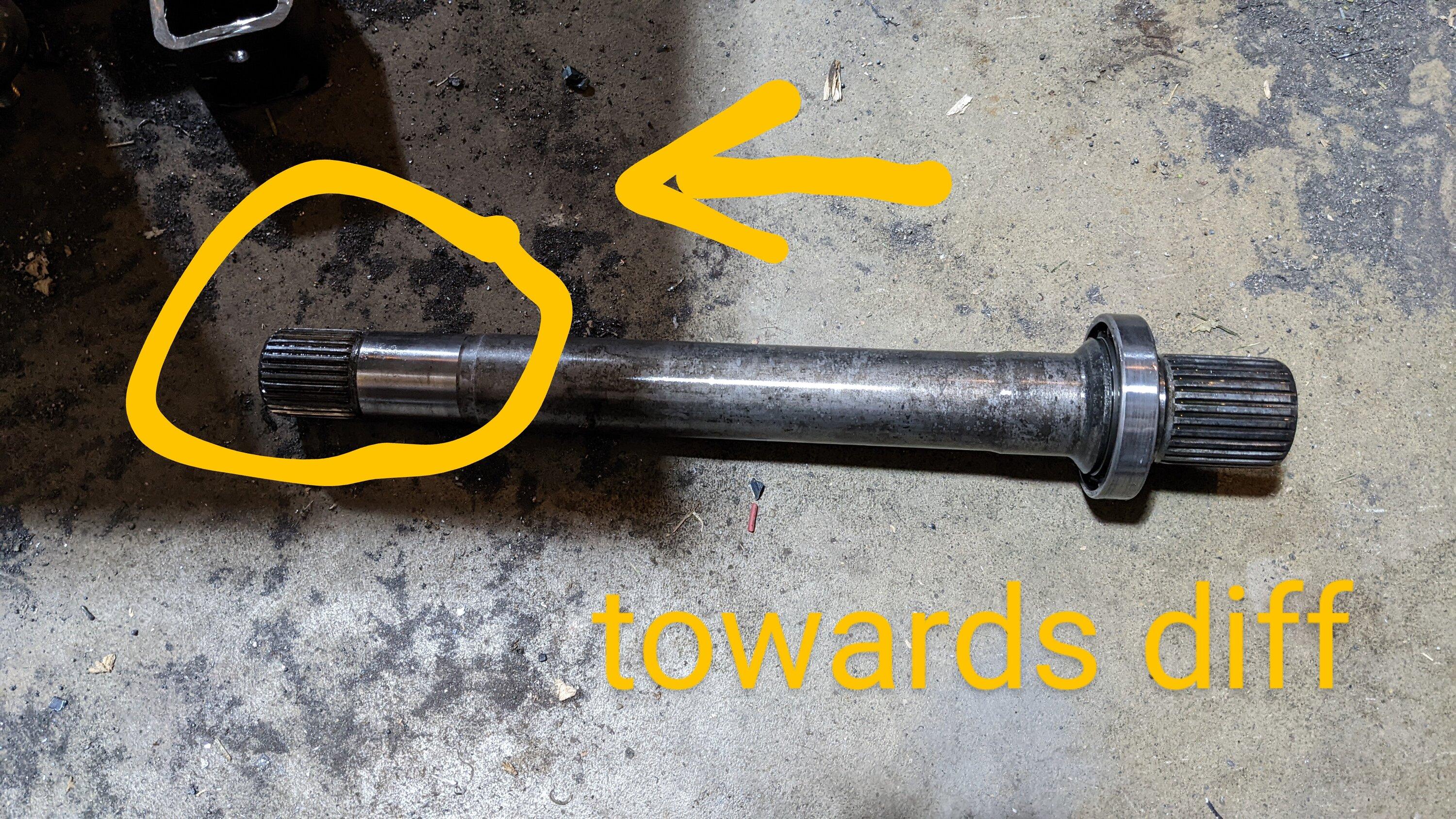

The shaft that goes into the spider gear is too long.
Ford Bronco M210 Front Axle Swap? PXL_20220703_051030298~2
This end could be modified to work.

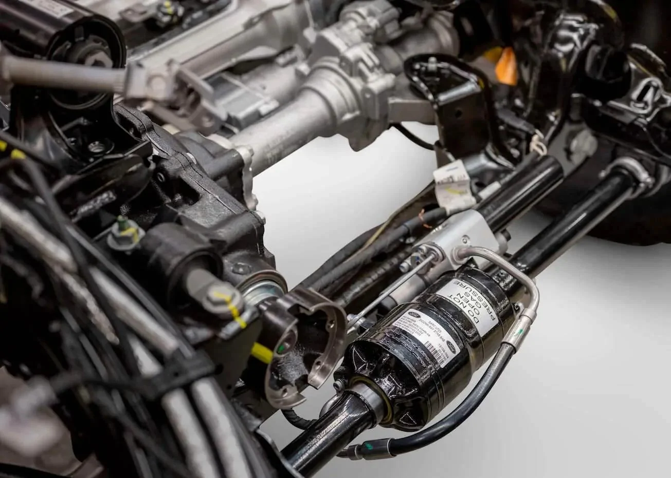

This pic was everywhere in the media release. 🤦🏻‍♂️ M210, FAD, and anti-swaybar disco. So it's been done at least once. 😆
