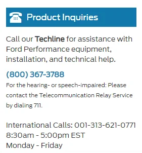

Did you call the Ford Performance Tech Line? I heard it was pretty helpful.
Will try now. But so far they have hung up on me once, and once on the shop helping me. But will call again now and see what they say.
The guy on the phone had zero idea what to do, he suggested I email the " super secret ford engineering email " and wait for a reply. I've already done this, and I believe Just_Jim did too and neither of us have gotten a reply. He did insinuate it may take weeks, not days, so I guess we wait.
