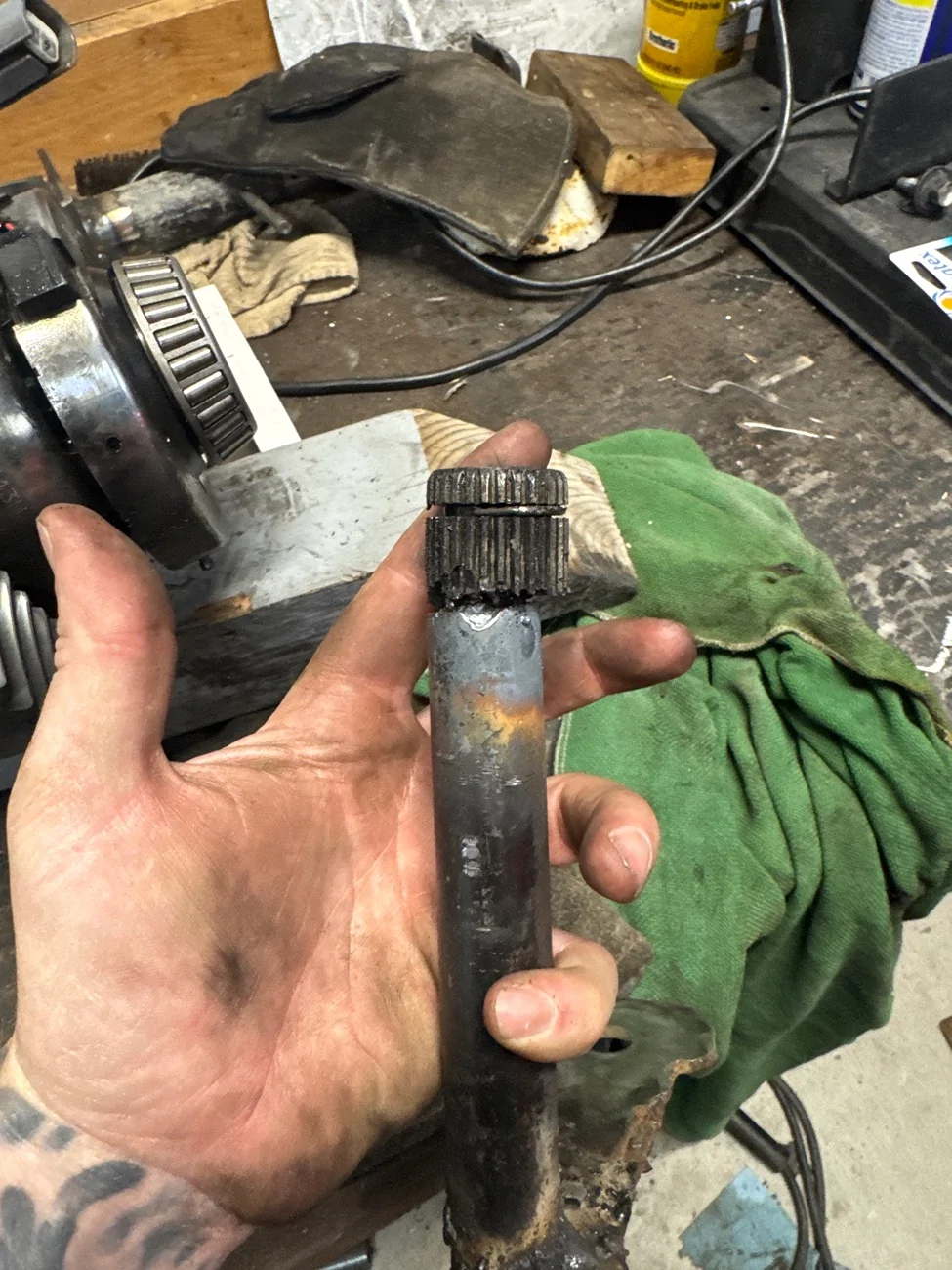

I got a tube from the scrap pile going to attempt to weld it to the broken axle and pray lol maybe get to it tonight

Good luck wit it 🙏.
Any link to the origin story or details on how you ended up here?

Good luck wit it 🙏.

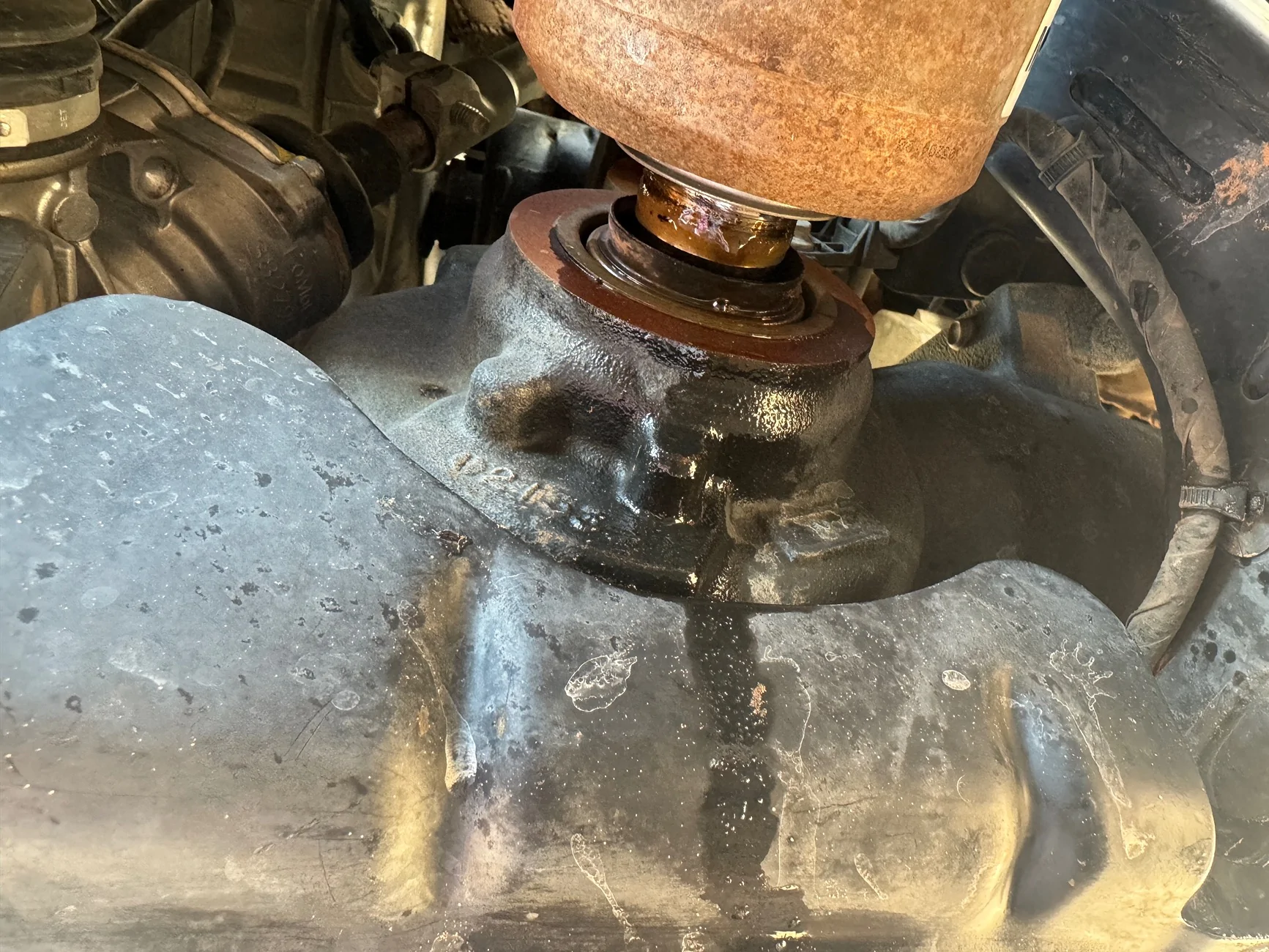

Don’t broke somewhere between double Sammy and the chute, I maybe a mile from the water tanks in sand hollow and herd a clunk after stopping and going, sound similar to when I busted my upper control arm. So I pulled into the staging area wiggles the control arm and it was fine so I slide under and saw the cv was about an inch and a half out of the diff …
Threw it in 2wd and risked the hour drive home lol

We did a lot since it did rain so a little more spinning on rocks then I normally do lol and a couple bounces tha I was like 😬

Heeeeeeyyyyyyyyyyyy! Hell yeah!
Get the intermediate shaft out now to check it out or just leaving it in there?
Leaving it in looked through the center looks clean and intact
