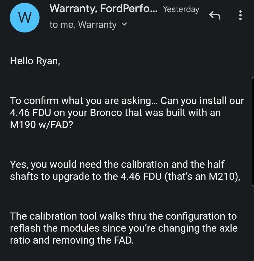

I emailed Ford Performance and they said they would know in the next few days about the non FAD upgrade.

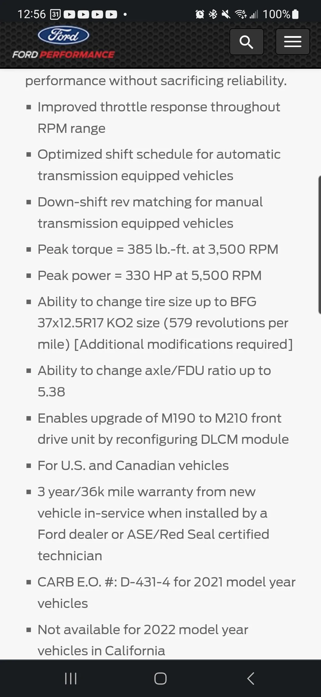

Looks like they're incorporating it into the ProCaL.
Here's hte link for the 2.7L.
It also looks like the price went up because of it. The ProCal with this added is $825 Retail.

Well it's confirmed that you can just program it with the procal. Hopefully the next thing they do is the Hoss 3.0 steering rack. Then my Bronco would be done
