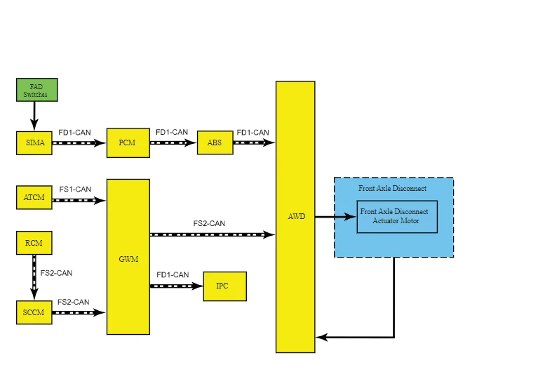

I believe the AWD module drives the advanced tcase torque bias. I assume the change above to AWD is related to this feature.

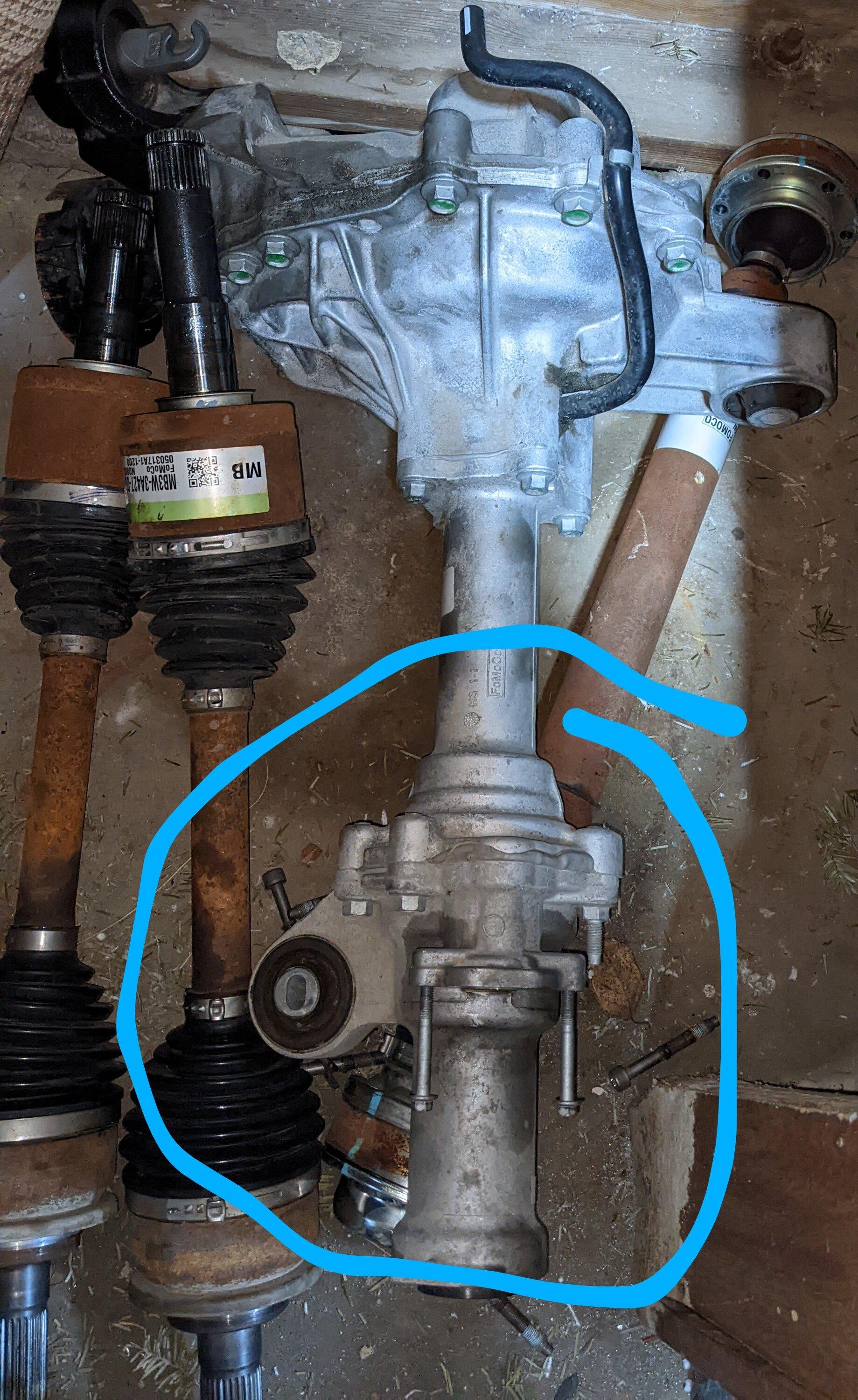

Can you post pics of the FAD? I don't even know what it looks like on a Bronco.

However, one's installed and full of lube. 🤦🏻‍♂️
*Presently missing the solenoid motor.

This just answered my question of why the hell the 190 would have both FAD and no FAD... it's due to the AWD t-case vs the 4WD option.
If I were to go the 190 swap route, there's no way I'd run the front dig through the BCM. It'd be a standalone switch, with a mechanical interlock safety. I plan to do this with my LWN Colorado by adding the Eaton front locker from the ZR2 on a standalone switch. I want the option to run in 4HI, which BCM parameters preclude.

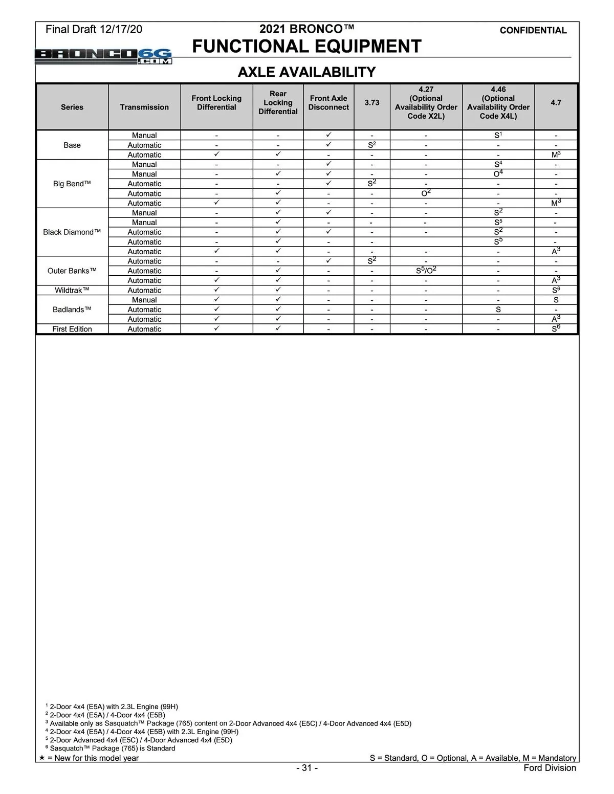

Here is a useful graphic too, to outline who and why one of them have the FAD.

What's the M3 on the BB?
M means mandatory, and 3 is the sasquatch package. So in order to get the 4.73 you had to have the sas mandatory I guess. I've attached the full image so you can see the legend

Well, the FAD off the m190 Does NOT fit the m210...
At least not without cutting the intermediate shaft down about an inch and resplining the outboard end.
The shafts are 29 spline. CV axles will interchange. The housings even match up. But the innards are a no-go.
