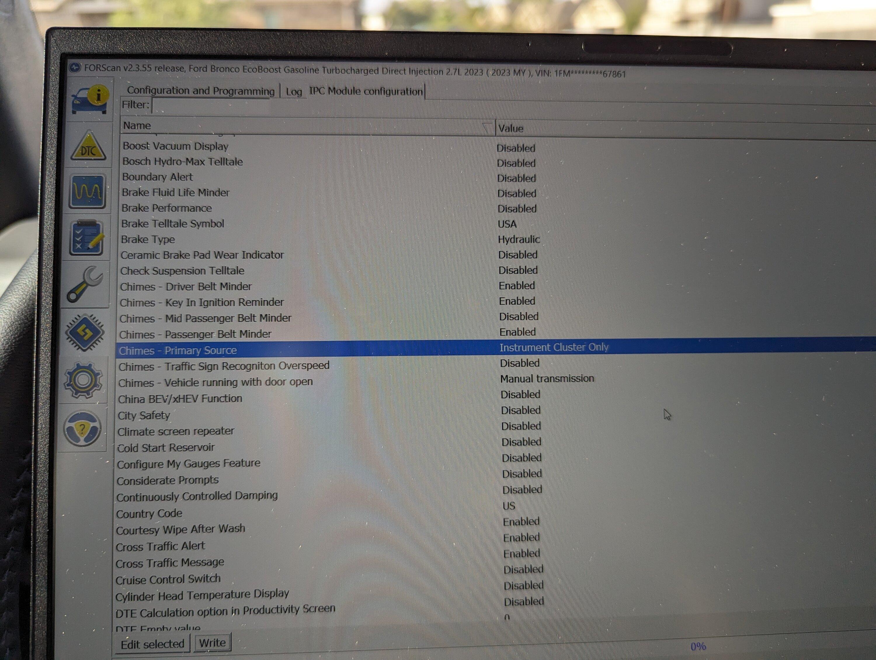

if you increased the gain on the key, and/or made eq changes in forscan, than the chimes will be obnoxiously loud.
to fix this, I changed the chimes to only play through the instrument cluster (using forscan)
What did you change in forscan to change the chimes?
