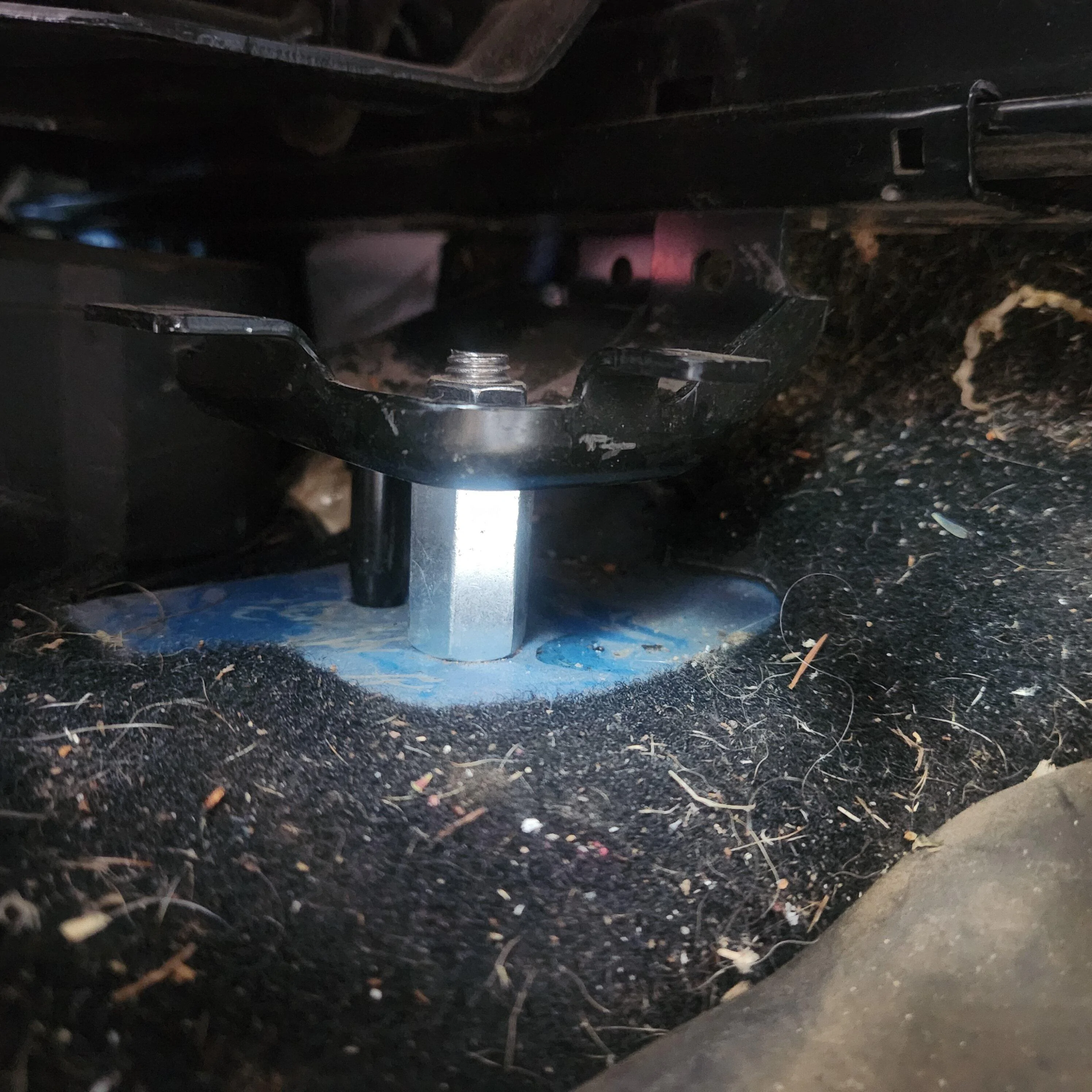

Dude that's badass...sorry yeah kicks not doors. Still thinking about copying you setup. Actually tested the HS10 for fit under the front seat yesterday...are you using 1" seat jackers? Thanks for your time.

Is that just spacer or is it threaded? 1" is all it takes to get a hideway sub under the seat? That seems like the perfect solution for my needs.

I used a metric threaded rod and a metric coupler nut...I think they were 3" and I cut them in half...leaving 1 ³/⁸ approximately...the threaded rod goes down into the original hole and a new flanged lockout on top.

Brilliant! Thank you
