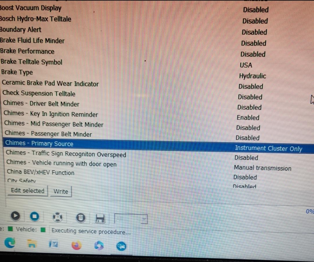

the IPC, not the as built, plain English settings. There are a few items named chimes…… can’t remember what it’s called exactly but it’s obvious. Change setting from speakers only to instrument cluster only.
I know things are less accurate there but I tried it and it worked. Lots of stuff said “disabled” that are actually enabled.
there are lots of tempting options to change but I refrained. Mostly. I also tried tilting mirrors in reverse, didn’t work.
Found it thanks!

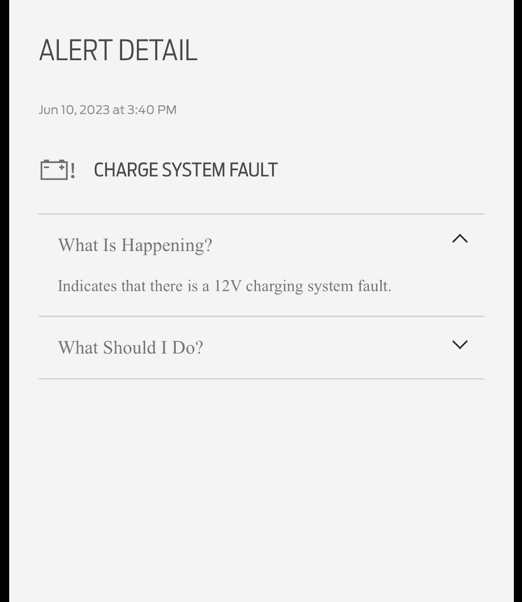

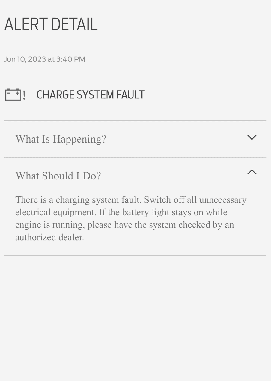

Installed my kicker key, using the direct wire to the battery and a PnP harness. Turned it on and everything seems to be working fine, but I have a battery error now (see screenshots).
Any thoughts about what I might have done wrong, and what I need to do to fix it?

Where did you hook the wire to at the battery? Where did you ground? Pictures of install please

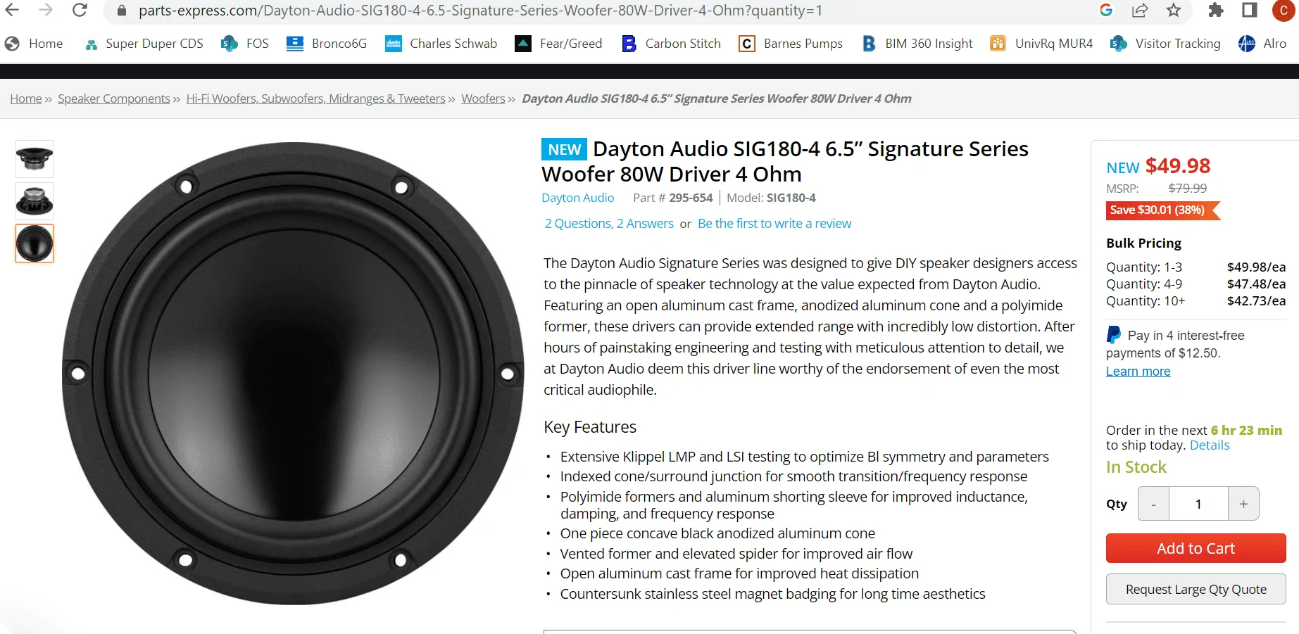

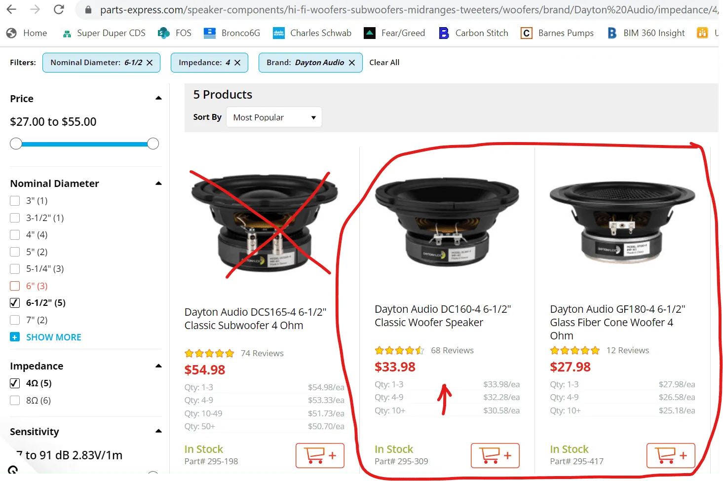

Do you have the specific model #? I see a few options but the free air ones look like they are 8 ohm
I went with the classic woofer - it is a paper cone and the fit is a little tight against the front (kick molding) but no noises or rattles. With the leather interior and carpet I will not be getting them wet.
I read someone who used the fiberglass ones and was happy (less front depth and water resistant) and a litte more sensitivity (efficient). I think that these might be my first choice if I did it again, but I am VERY pleased with the classics (bigger voice coil and thus more a litte more power handling capability). I don't think that you could go wrong with either, and both are as good as what you get from the big names...
Ford Bronco Kicker Key Amp 200.4 Install DIY Video - Do this first! 1687180271070
And here is a new offering that I would have considered if it had been available.
