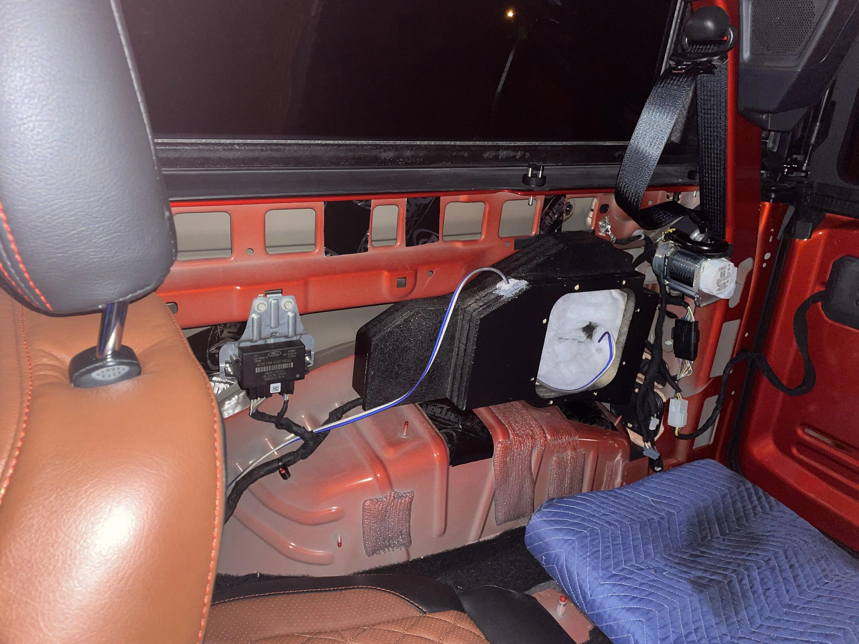

I installed the Kicker sub in the SRQ box. I just have the 500.1 at the lowest gain, low pass crossover at 10Hz and high pass at its max (160Hz, I think?) and the bass boost turned off and sub wired to 2ohm and it sounds great. Deep, tight bass more reminiscent of a 10” sub from my experience. I’d definitely recommend the SRQ box.
Update. For those who install this box, note that SRQ notched a couple spots on the bottom where some threads protrude from the wheel well to help the box sit lower. Mine wasn’t notched in the correct place. I used a drill bit to burrow out the correct location. I also had to take an orbital sander with 60 grit paper to trim about 1/3” off in the following spots circled in yellow to get the box to sit low enough for the rear trim panel to clear. The rear side trim panel needed the front edge of the box to sit 6” below the bottom of the metal lip that the top rests on as pictured.
