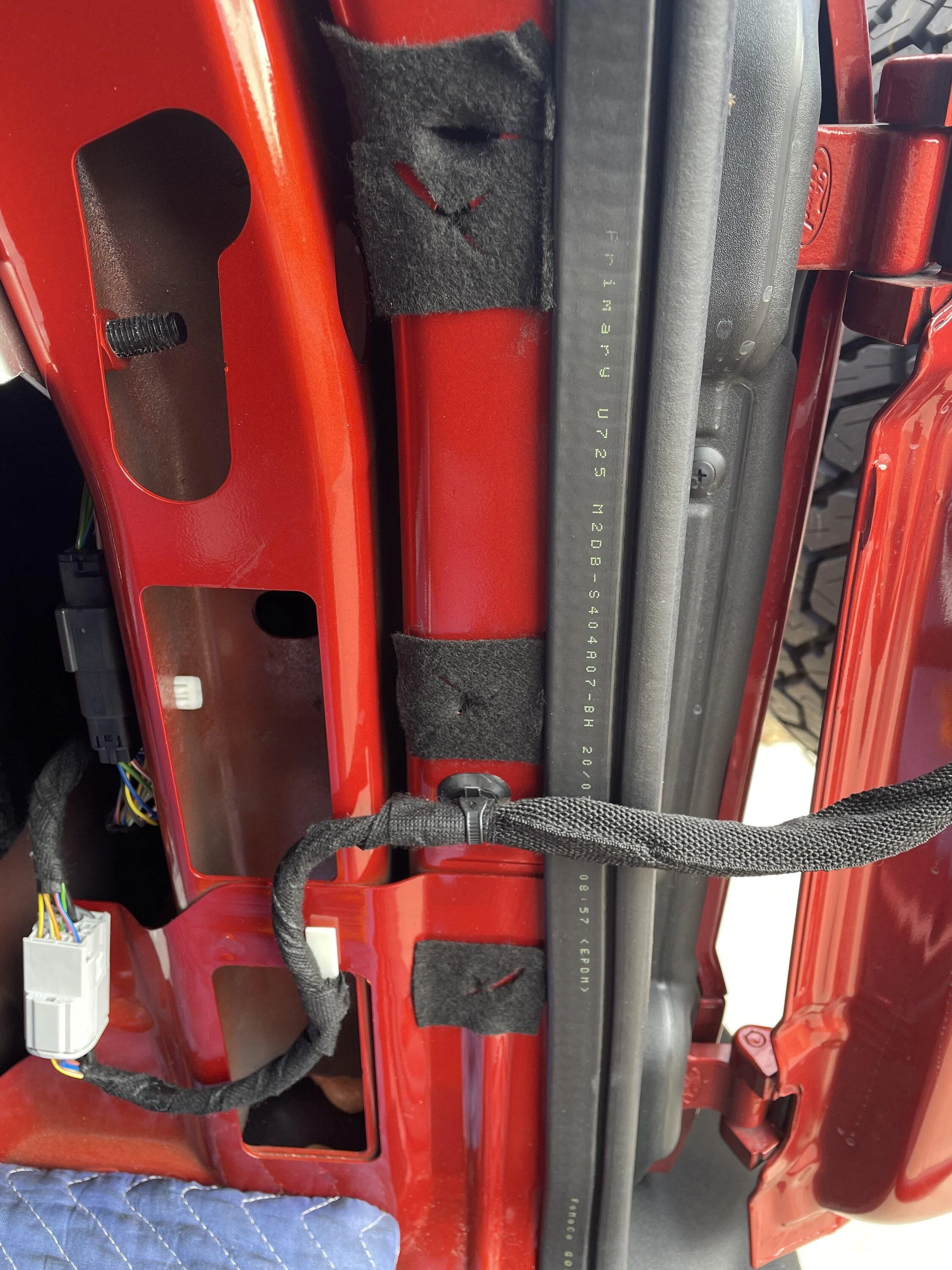

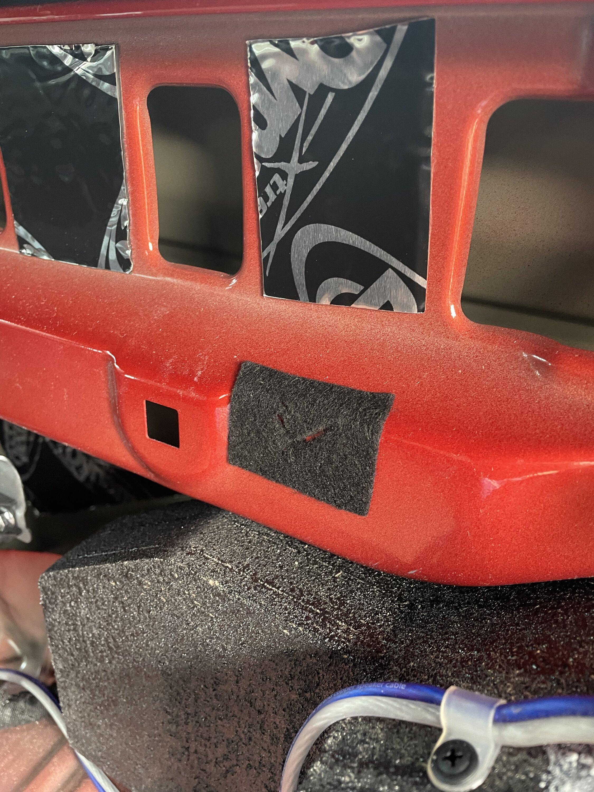

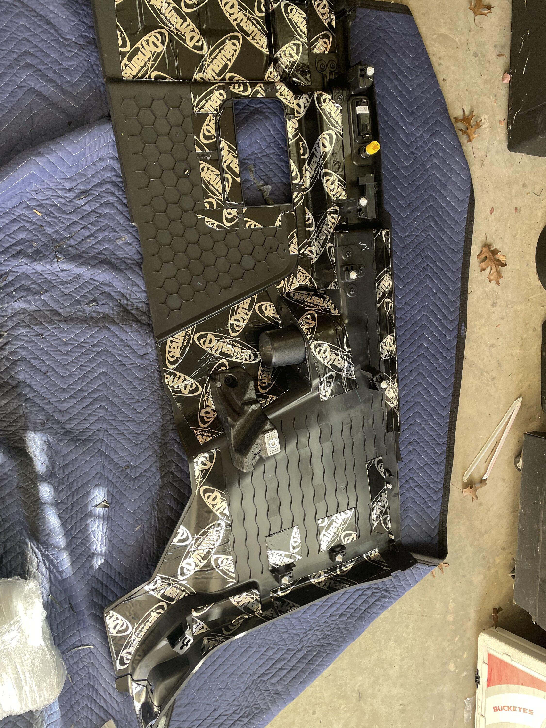

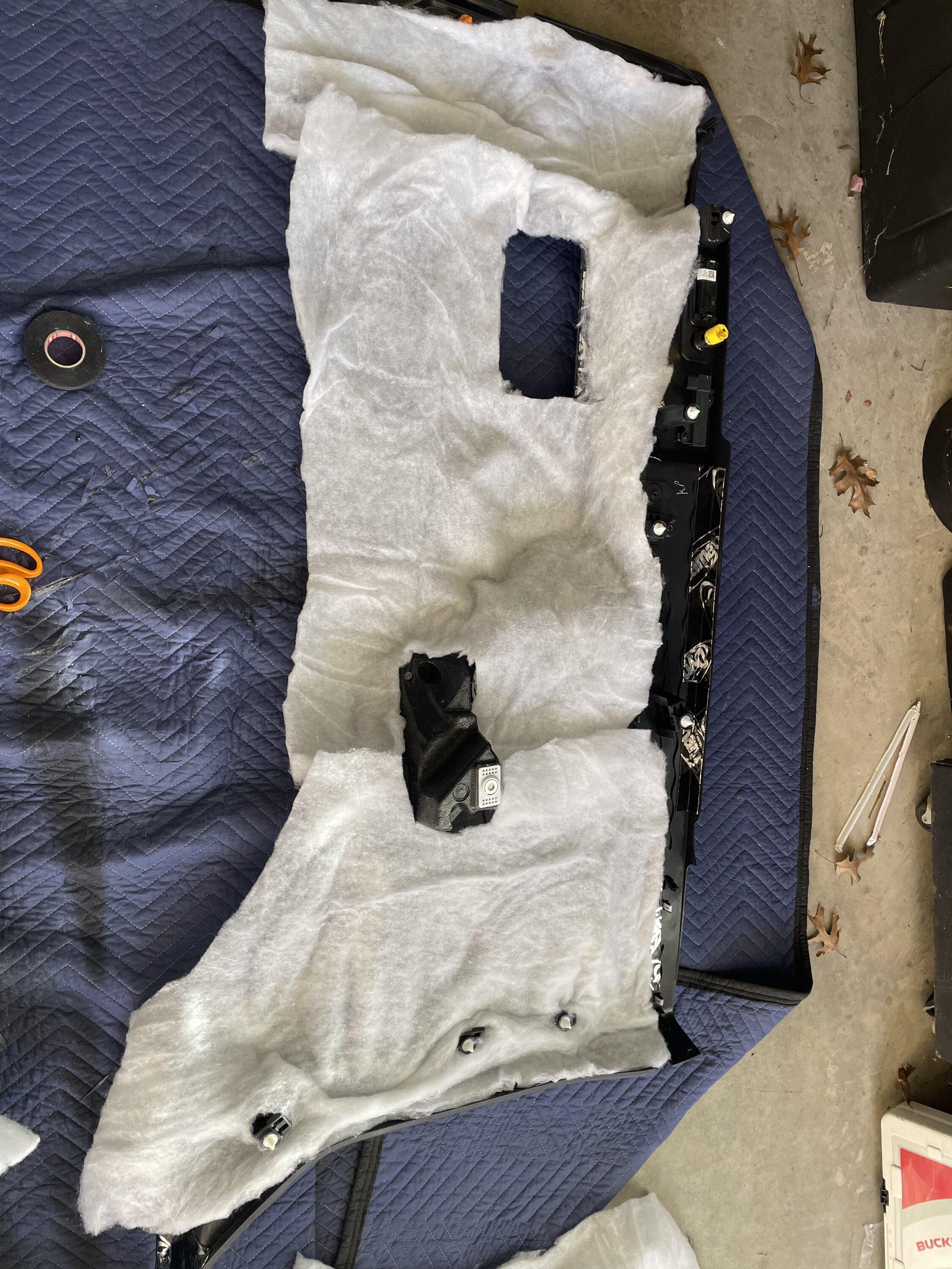

Update. For those who install this box, note that SRQ notched a couple spots on the bottom where some threads protrude from the wheel well to help the box sit lower. Mine wasn’t notched in the correct place. I used a drill bit to burrow out the correct location. I also had to take an orbital sander with 60 grit paper to trim about 1/3” off in the following spots circled in yellow to get the box to sit low enough for the rear trim panel to clear. The rear side trim panel needed the front edge of the box to sit 6” below the bottom of the metal lip that the top rests on as pictured.
Finally, here are some pictures of what I did to prevent rattles.
1. I put adhesive-backed felt over all holes/slots that clips fit into.
2. Where clips mounted to the back of the plastic trim panel, I put cloth tape either around the heads or on the panel.
3. I applied dynamat to all flat surfaces on the back of the panel and in a few spots on the sheet metal.
4. I applied quilt batting to the back of the panel with double-sided tape to prevent any metal on plastic contact.
Not pretty but I have no buzzing or rattles.
