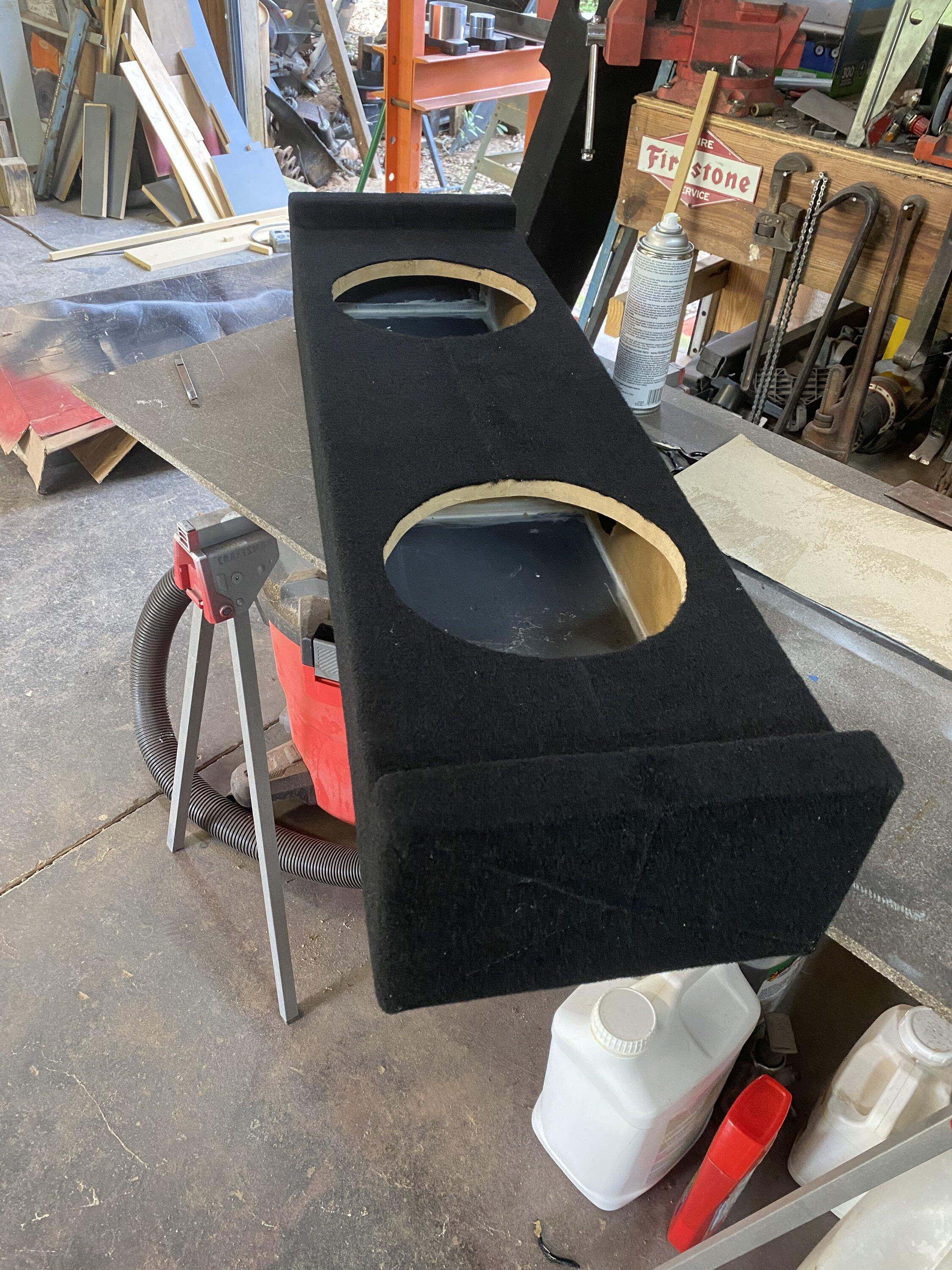

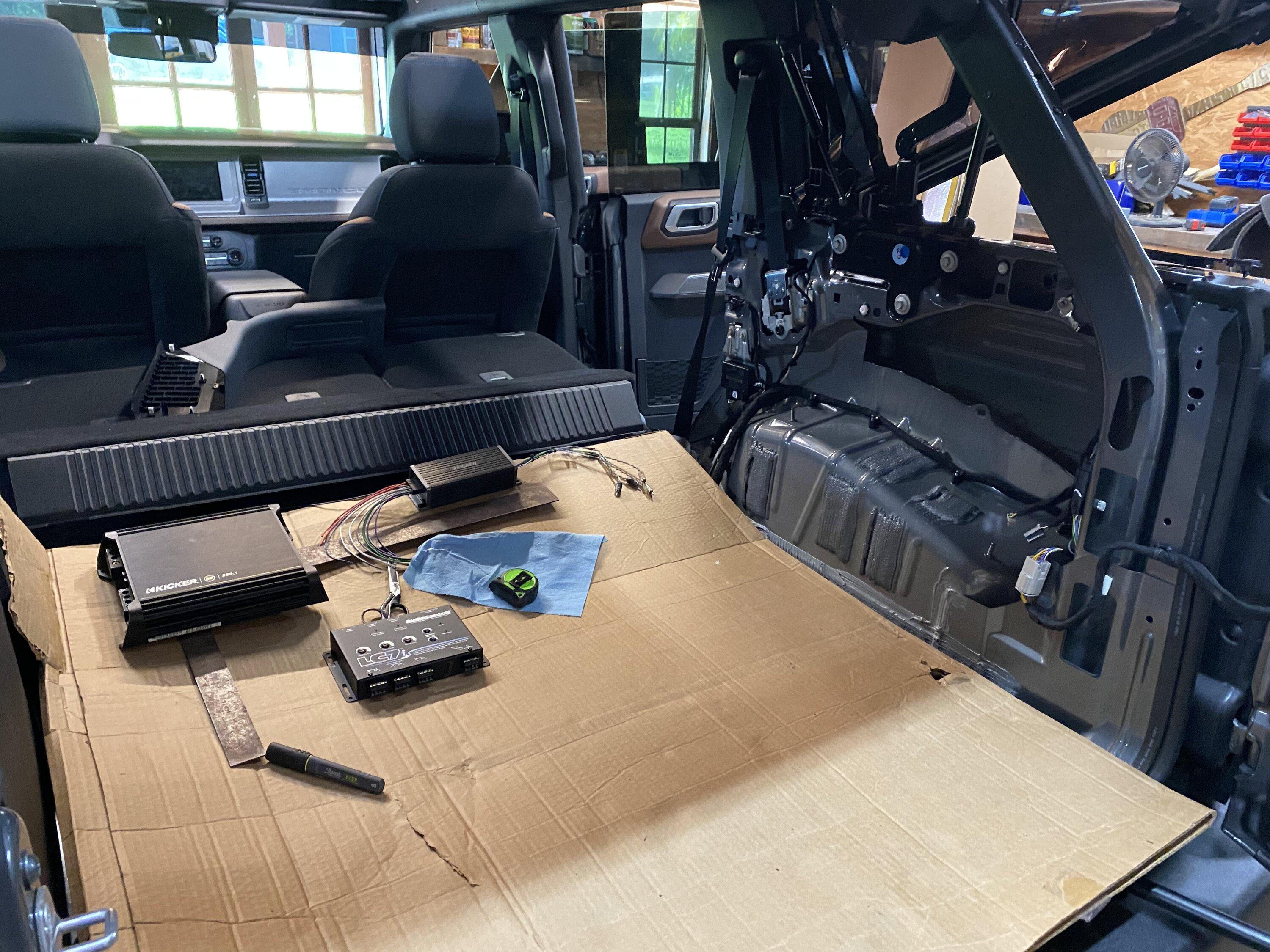

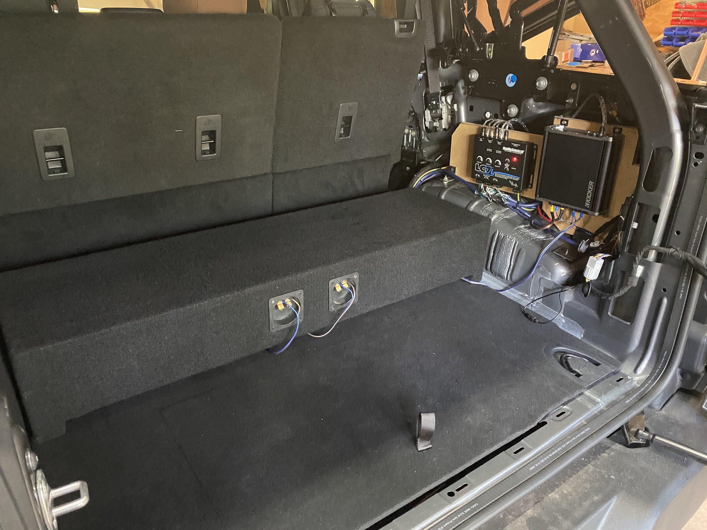

I haven’t read the entire 66 pages of this thread, but findings from my build. I didn’t use the plug and play but I did use the Key 200.4 for the highs and Kicker mono for two 10’s. Super clean sound with plenty of bass up to full volume with no distortion. There is nothing wrong with the Ford radio signal, you just have to design and use the right components. I think one of the main keys is setting up the signal gains using pink noise through the LCI7. Here is a few pics and link from my build.

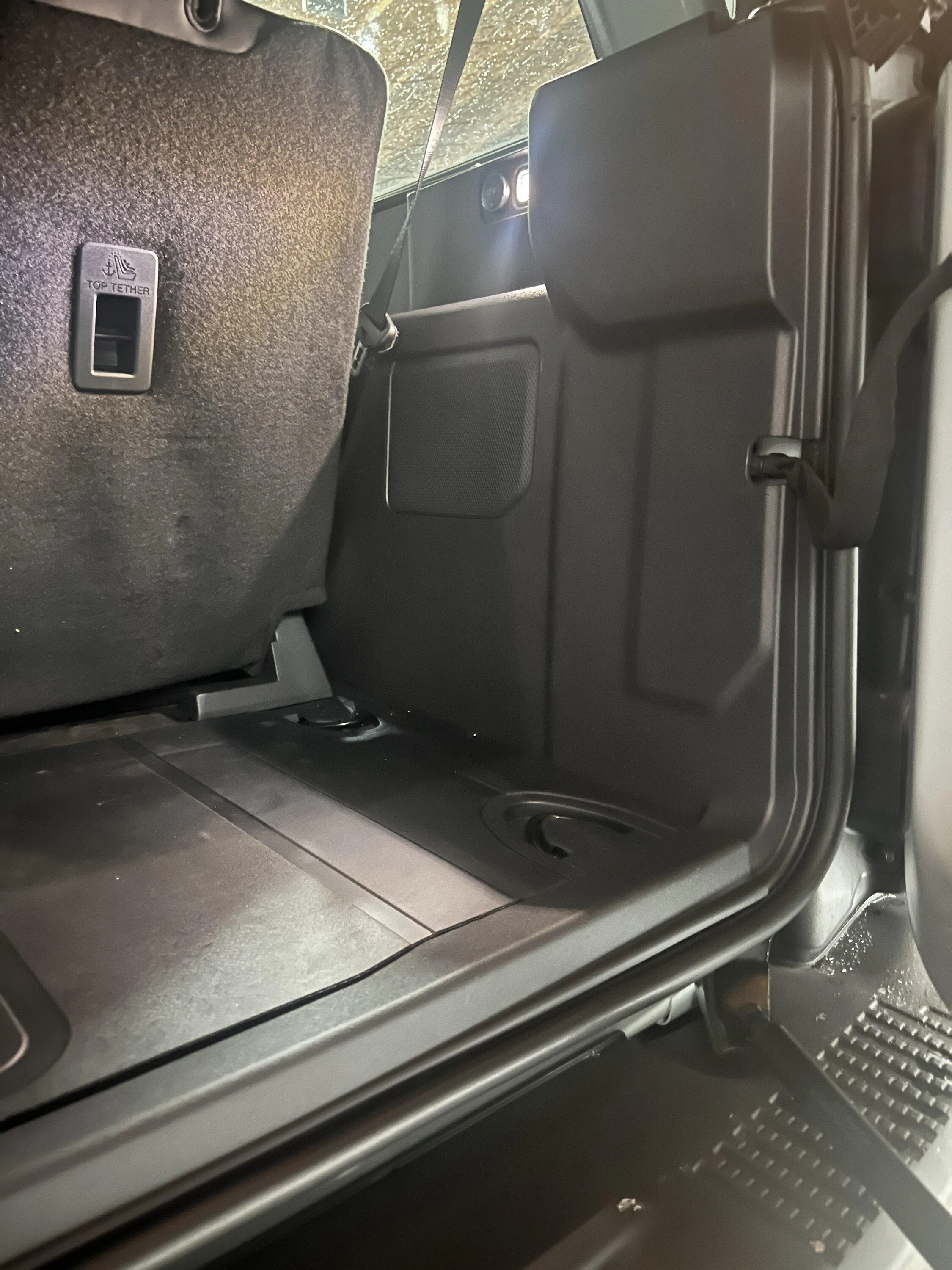

I never thought of lifting up the seat more. When I look under mine, they are packed with wires and levers and plugs. No way at speaker box was going to fit under it.

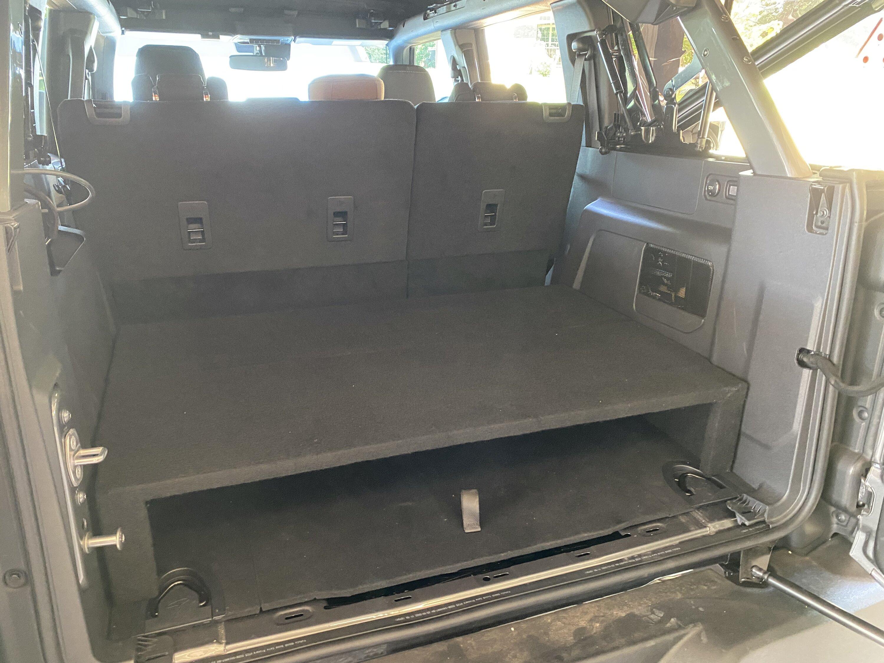

I'm likely building a false floor in the back for a bit of storage and sub hiding in the near future, just waiting on scrap lumber from another project.

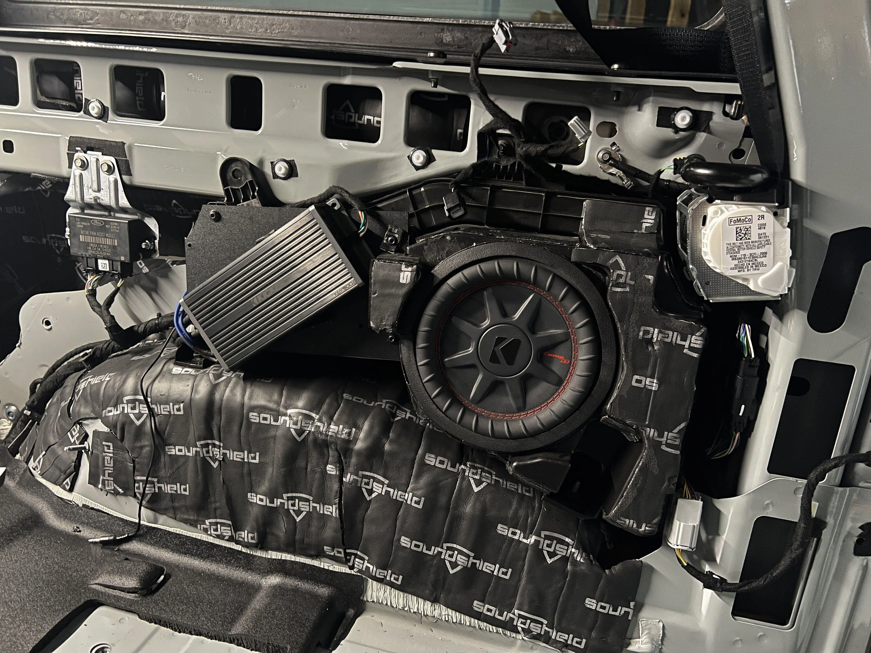

Not the prettiest but sounds way better then I anticipated with the factory box, I did purchase a whole rear side panel to look factory since I have high package
Cool. You don’t happen to have the part number for the side panel that you can post, do you? I’ve been hit or miss on finding part numbers. I literally have the sticker that should show the part number on the back of the drivers footrest cover that I snapped a clip off of and it won’t come up on Ford or any dealers’ sites. Depending on the price, I may do what you did. Yours appears to be a two door like mine.
I've thought about this as well. Build a floor with some drawers, and use the back section for a subwoofer. I have an old 10-in along with an amp that I had years ago in a vehicle and I've been hanging on to it. But now with these modern amp So much smaller, I almost think purchasing a 500.1 would be a no-brainer.
