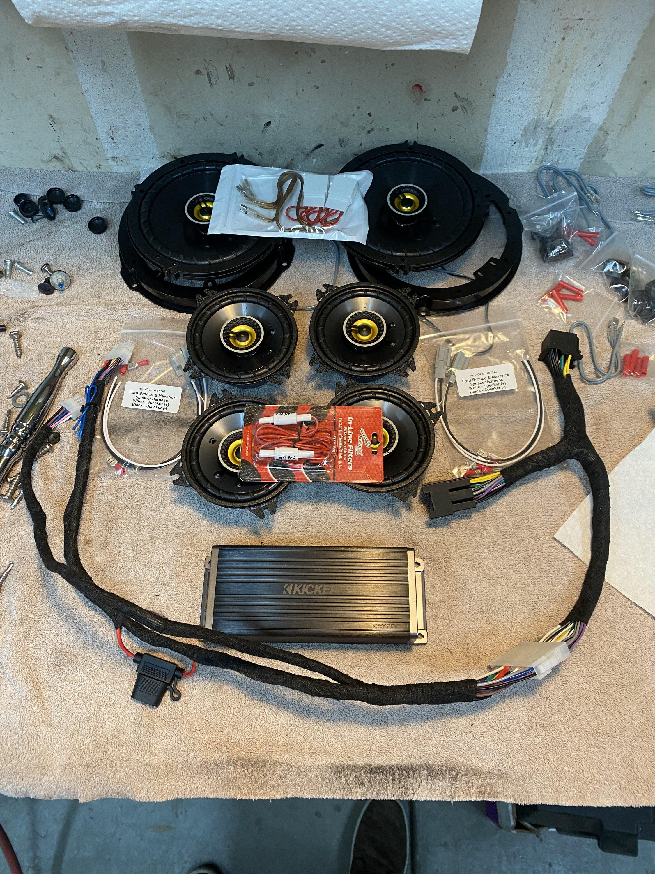

Cool! I’ll think I got everything for the switch?
I cant wait to try it out! Have time off between Christmas and new years.
I am curious to
First try it with the stock speakers to hear the difference.
And then add the Kicker speakers and dash Bass blockers!
Ford Bronco Kicker Key Amp 200.4 Install DIY Video - Do this first! A4509063-3552-4310-B3A9-07DA25E66FA6
