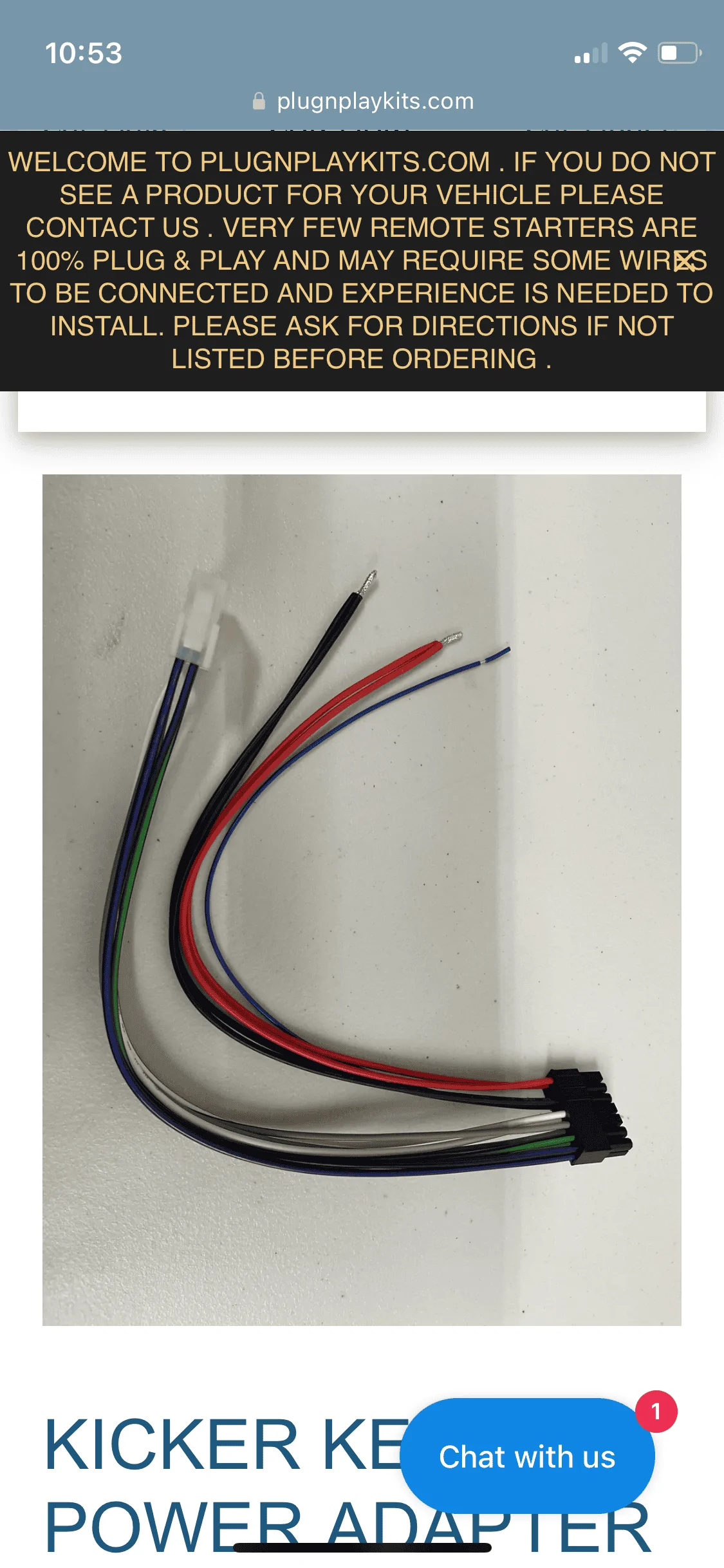

That is what I thought, but on page 64 several people are talking about a $10 power adapter for the kicker key 200.4. That they had clipping at volume 17, then installed that and it would go up to about 22 before it did.

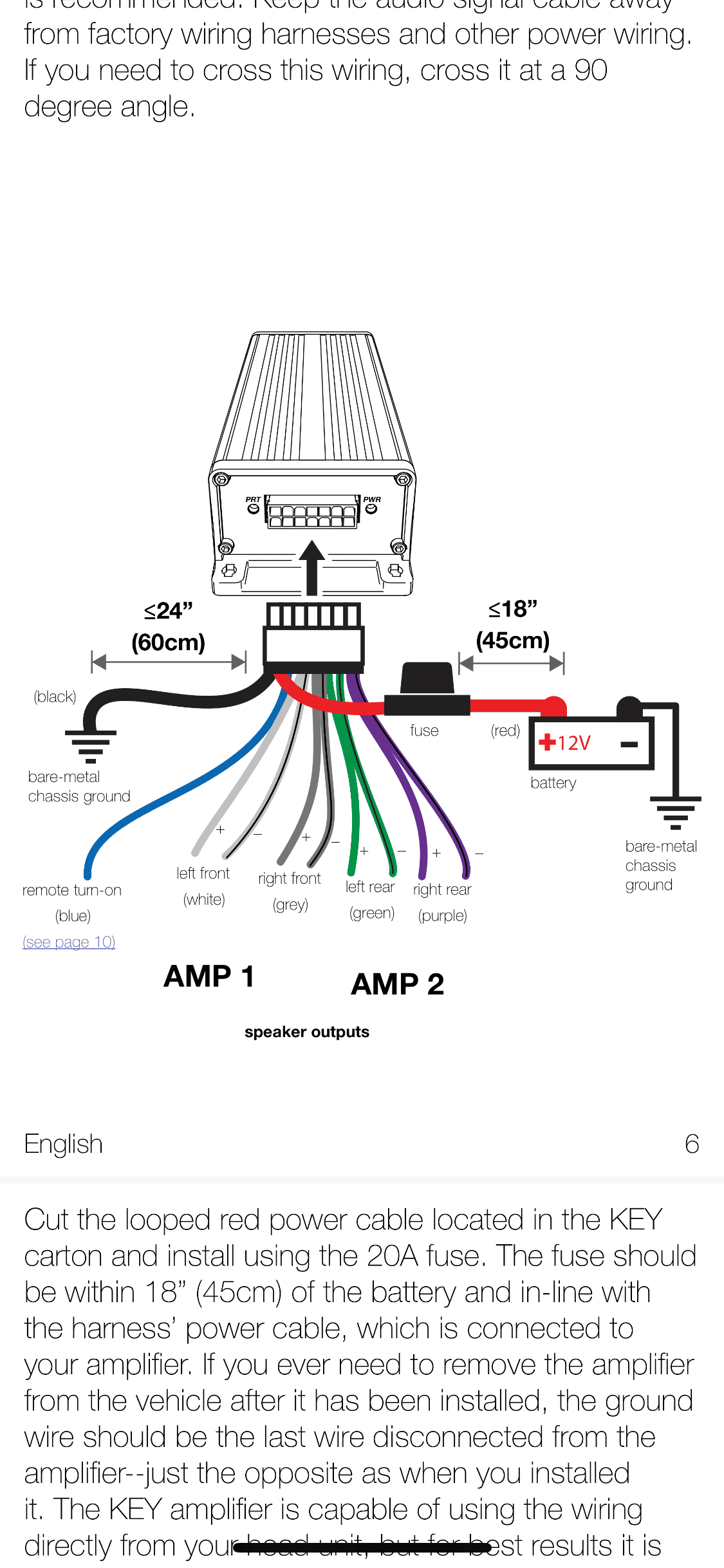

The black end of the $10 harness plugs into the Kicker Key 200.4. The white end plugs into the plug & play harness that runs to the radio. This leaves you with the raw black ground wire to ground to a place on the body of the Bronco, the red power wire to run to the battery with a 20 Amp fuse inline within 18” of the battery and the blue remote turn on wire that isn’t needed because the speaker level audio inputs provide enough signal to turn on the amp. If you don’t use the $10 power adapter, the power and ground are fed to the Kicker from the radio. I can’t speak to the clipping issue as I used the power adapter, not radio power and ground, and didn’t have that issue.
Awesome, thanks. I was confused at how two plugs, plugged into one plug. Didn't consider one plug went into the other plug, then into the amp. I'll probably try today to get everything in and see if I need to go above 17 or not. Really feel like it should have been included though.
