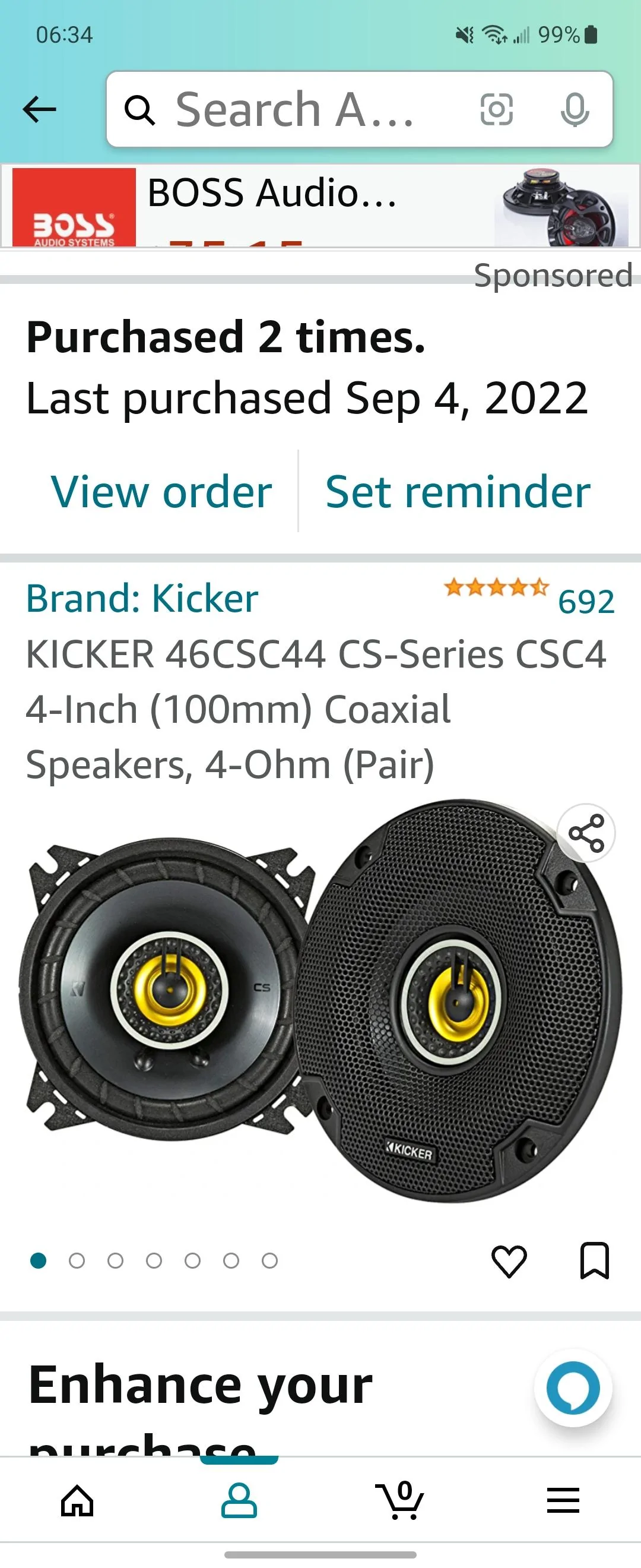

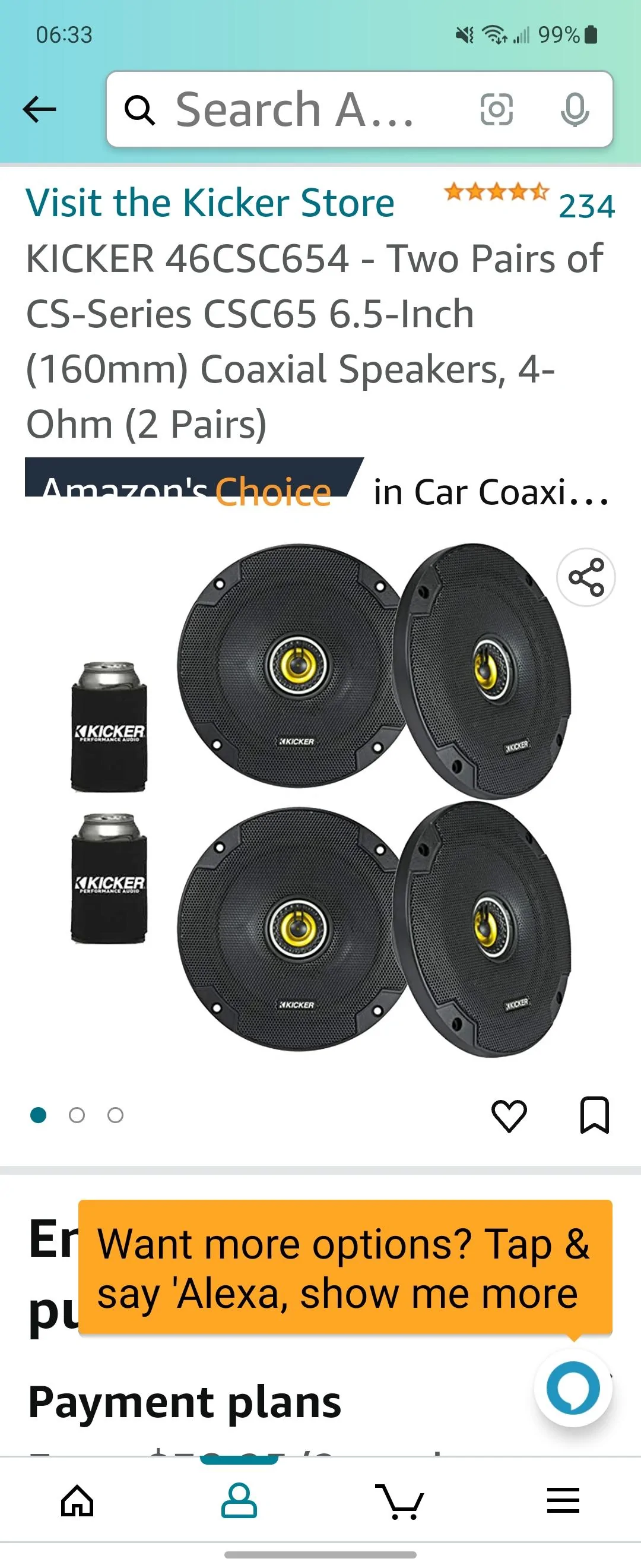

Which series kicker speakers did you go with?
fallguy
Mar 13, 2022
422
710
Tennessee
2020 Defender, 2022 Outerbanks SAS, 1968 Mustang
Here are pics from my Amazon order. I also put in Boom mat behind the speakers.

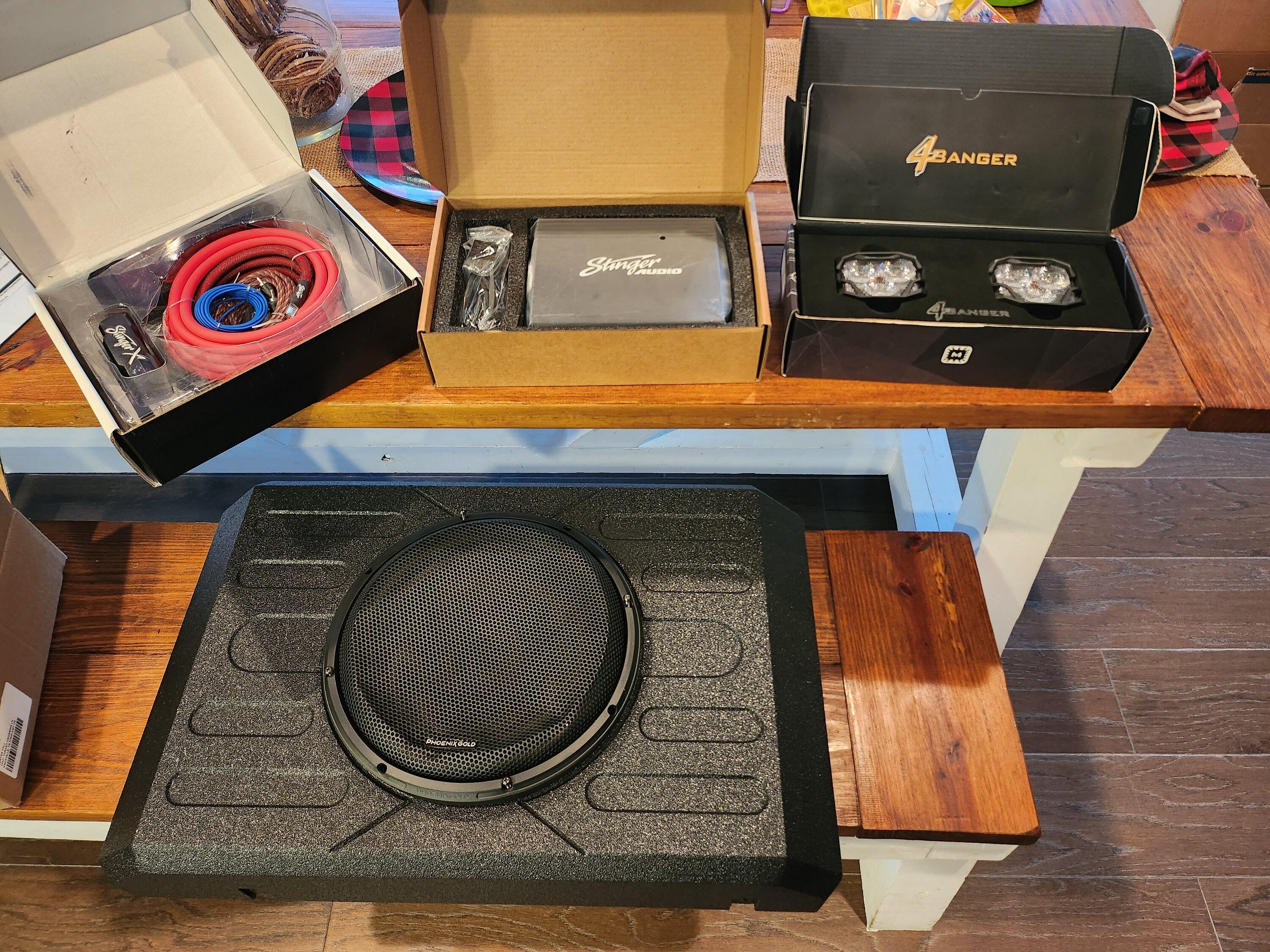

Then I just bought the tailgate sub, amp and wiring kit. Sub came damaged though, screen dented in. Watched some more videos.. Hopefully install goes smoothly too.
