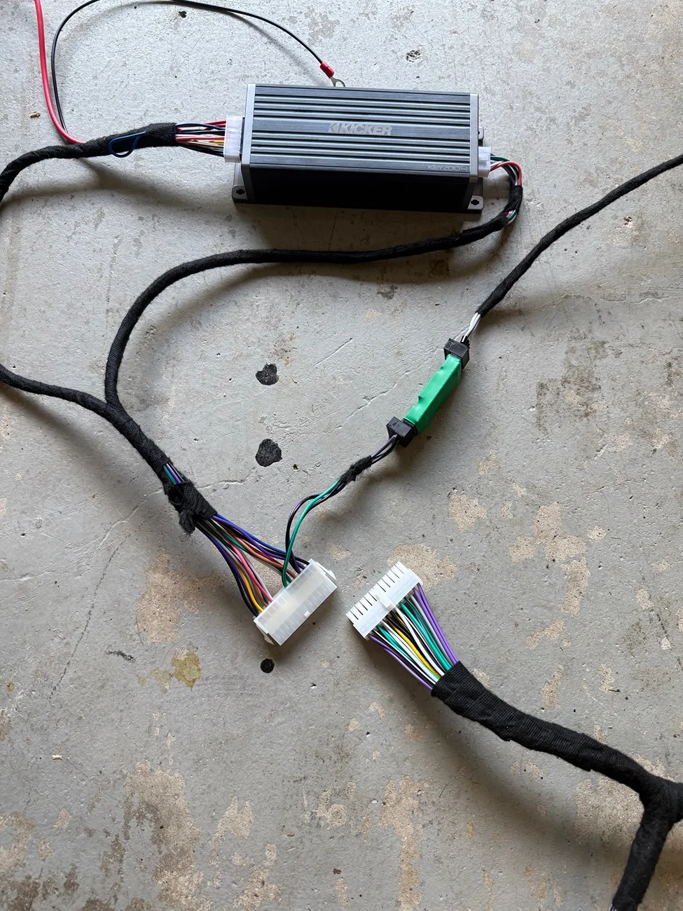

It is the Plugnplaykits 19-1 that Ragnarkon used in his install. Here is a picture showing the signal wire running to the amp in the back
Edit: After looking at your picture on page 7 #99 I see these are in addition to what you have on the plug, and I shouldn't have any difference than your setup.
Awesome. Be sure to note post #101. You want a remote power wire from the 200 to the 500. It’s the only dependable way to turn on/off. Without it there are thumps and late signal detections.

On page 9 #135 I think, someone mentions needing to complete the loop where the old kick panels plugged in, I haven’t done that, I just taped up the ends and wrapped them away, could that be my issue? Stock wiring to the dash. New wiring to the kicks
yep, dash speakers have nothing, I’ll order the metra’s

i used the old wires to the dash and ran new wires to the kick panels. The 200 handles all that. My amps are on separate power wires so removing the fuse for sub handles that. Balance should be full front when doing auto EQ and DSP setup.

What did you do with the old kick panel connections? Right now mine are empty and I’ve got no output to the dash. I’ve order some connectors and will loop them to continue the signal up to the dash. Kick panels are on my own wires like you outline. I’m assuming the pnp harness I have is tapping kick outputs so when I remove it, it interrupts the signal. I’ll try again tomorrow once I have the OEM kick connections looped
Have you modified your harness at all?
I disconnected my stock wires at kick and taped them up. I still get sound to dash.
I disconnect everything except the front floor speakers. Troubleshoot that. Then connect up the sub and go from there.

I’ve got the harness modified like you’ve laid out, I’m getting stock HU sound from the rear pods. I changed the dash speakers before I had attempted any of this and they were working before. On Pg 9 #135 he says he installed connectors that looped and it restored signal to the dash.
I forgot to post this reply yesterday, but I was able to restore the dash speakers with the connectors. Still no bi amp mode. I was able to tune it without bi amp mode but there’s an obvious need for bass blockers in the dash now. At this point I feel like it has to be the subwoofer signal line. It’s the key difference I seem to have from the rest of y’all’s plug n play harnesses. With the subwoofer amp disconnected I have to use DC or I won’t get the 200.4 to turn on. With the 500.1 on and hooked up the 200.4 turns on with 12V signal.
Is my only solution to get bi amp to get another harness without the subwoofer signal line and tap my factory subwoofer amp output? (2025 with A2B sub amp)
edit: I figured it out, I’m certainly not proud of this, but instead of wiring my kick connectors positive to positive I completed both. Miraculously didn’t fry anything, corrected and I got bi amp mode to work, sounds amazing!
