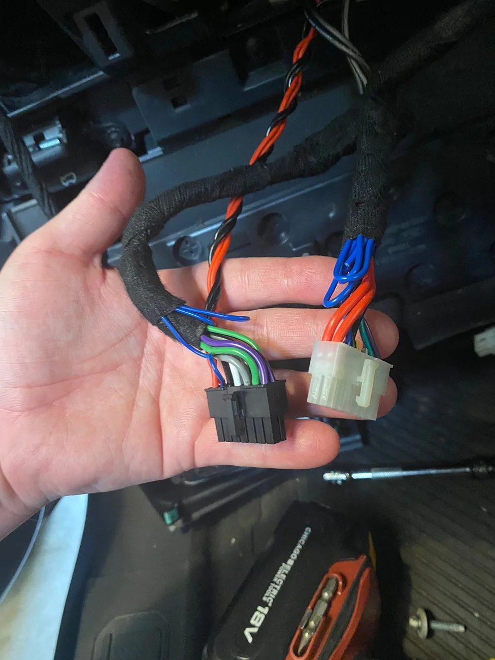

I was going thru all my connections to see if something was loose or unplugged and came up with this. The black one is plugged in to the input side of the amp and the white one was tucked away. They’re both the same type of plug. Been looking for the female end of the white plug. I don’t remember leaving anything unplugged tho.
Thoughts?
Thoughts?
It’s been a minute since I’ve been under my dash to look at the connectors. So the input side is plugged in and the output side is not? When I was done, everything was plugged back in since my harness sit in between everything.

Those look like plug-and-play amp harnesses, not anything Ford OEM.
Amps usually have a speaker-level input harness, and an output harness (or sometimes terminals). Low-level inputs are usually RCA jack and/or Toslink.
Power is usually hard wired to a terminal.
Remote Turn-on is a toss-up though.
So my guess is one of those is your speaker-level input (just guessing off the size of the wire, probably the black), and one is your amped speaker output (again, just guessing off size of wire, maybe the white one).

I remembered that I had purchased the Plug N Play dedicated battery power adapter, and it basically bypasses the white connector, so it stays tucked away.
All connections looked good and the system is working but not outputting like it used to. Could having the battery unplugged from the vehicle reset the HU to factory settings? I was thinking of increasing the Treble, Mids and Bass equally. Hmm...
Do you have a link to details about this? Everything should be plugged in with all the harnesses I’ve seen.
