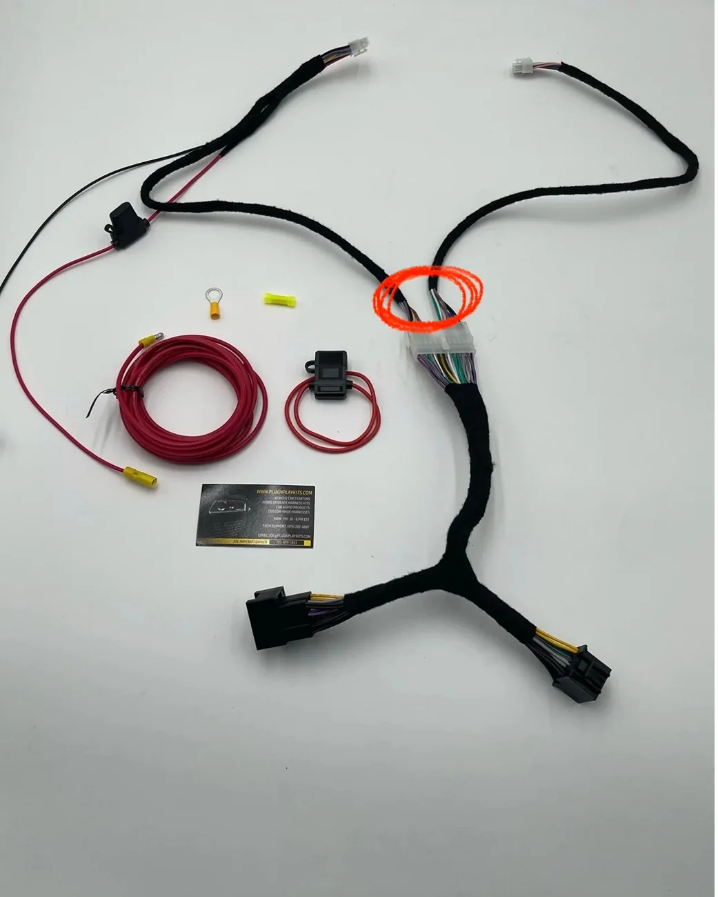

@AZCoyote
Your loops are here, correct?
CORRECTION. Page 7 post 99.
that looks like the correct place. Mine was a little hacky but you will get the idea.

kicker EQ doesn’t have to be turned off. Totally preferential. It adds highs and lows. Classic smiley face on a graphic EQ if you remember those. Turning off may sound good to you and remove harshness in highs. Just an option. Your ears decide though.
That harness looks more DIY than PNP. As long as your rears pass around the amp and use head unit power, the rest should fall in place.

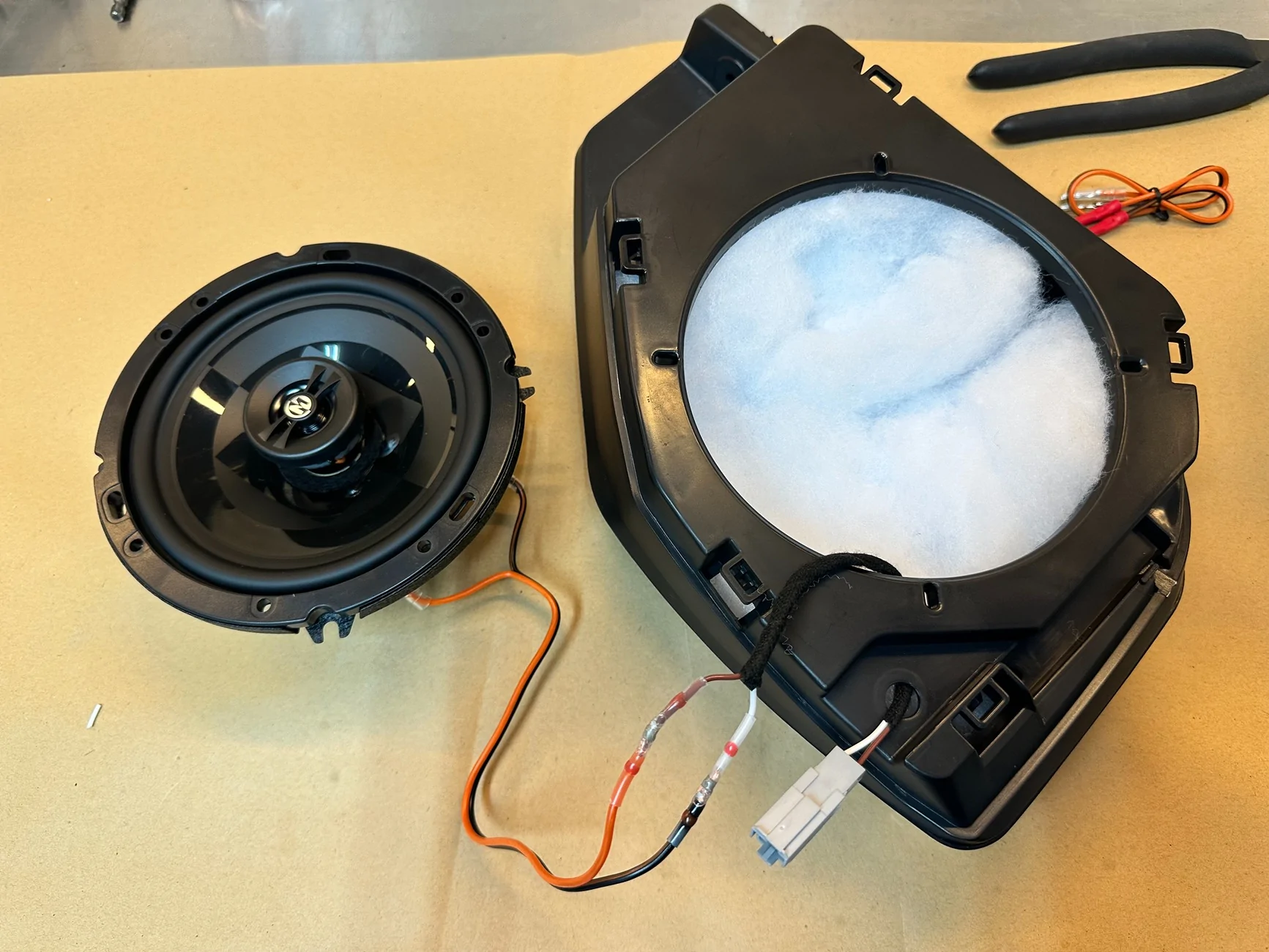

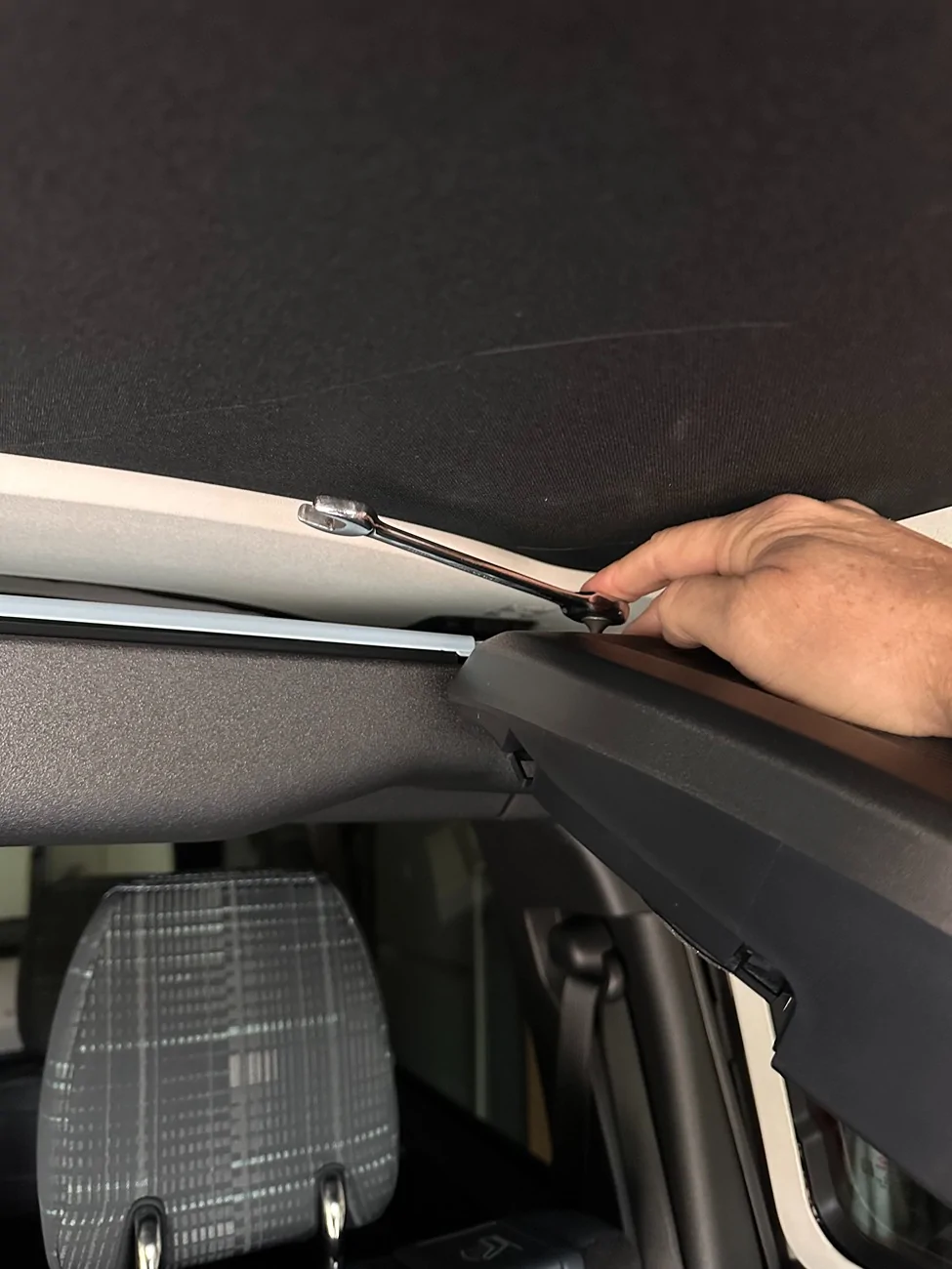

Round two with DSP. All dip switches are down, except for the 60Hz crossover. I may add compression as I'm still getting clipping at volume 19. Again, 15 is pretty much my highest listening volume but I want to test so it all is working properly.
The systems sounds MUCH better now. The tweeters are balanced, not bright. I also have some 6.5" coaxial speakers in bigger back pods, and moved the fader so they're noticeable but not overpowering. I like.
Ford Bronco Kicker Key 200.4 Done Correctly IMG_5278
Ford Bronco Kicker Key 200.4 Done Correctly IMG_5276
Ford Bronco Kicker Key 200.4 Done Correctly IMG_5054
Ford Bronco Kicker Key 200.4 Done Correctly IMG_5056
I read online that lower clipping levels can be normal on the Bronco head unit, and that a Line Output Converter (LOC) between the head unit and the Key 200.4 can help. Maybe later.
My next steps are to figure out the subwoofer and to cut a hole in the protectors behind the Memphis kick speakers so they can move freely.

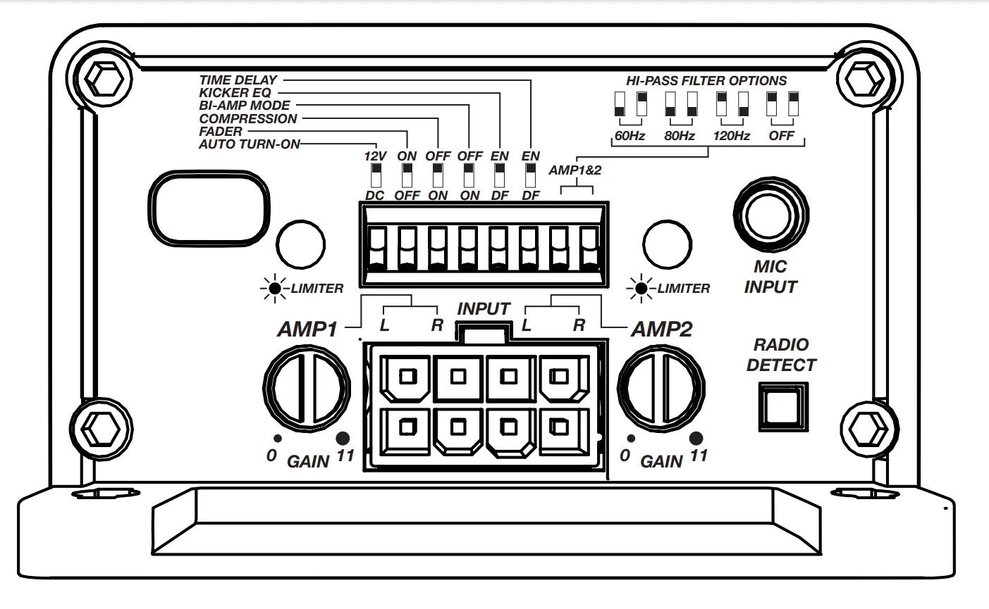

If the toggle switches are white, that means BI-AMP on is in the down position, right?
In other words, the picture below is showing all toggles are down.
I wanted "ALL DOWN" except for 60Hz setting to be my baseline. I was planning on turning on compression based on the clipping, and I could turn on time delay as well.
Correct?

Yup. You should have Down, Down, Down, Down, Up, Up, Down, Up.
