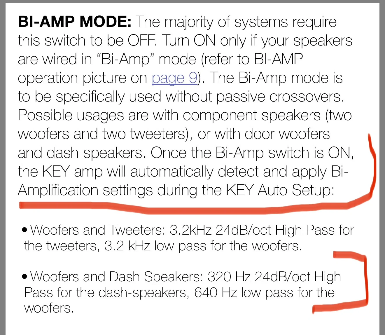

@AZCoyote
I'm trying to get my audio shop to reconfigure the plug n play harness and get setup the way you have suggested with Bi-Amp mode. The installer emailed me the following before performing the job:
What Bi-Amp mode is actually doing
On amps like the Kicker KEY 200.4, Bi-Amp mode:
  • Sends separate power + signal to tweeters and woofers
  • Uses active crossovers (built into the amp) instead of the passive ones
  • Time-aligns and EQs each driver individually during setup
That’s why the manual says “without passive crossovers” — the amp is taking over that job.

@AZCoyote

you should probably find a new shop. The people you’re talking to are too fucking stupid to do car audio well. If you choose to stay with them, tell them RTFM page 9 and page 12.
The amp will use internal crossovers to send the front channels 320 hz and up. Perfect for our little midranges in the dash.
it sends 640hz and down to the rear channels so your kicks are in the perfect frequency range for the kick panel speakers.
Be sure to set the dip switch for cutting sub frequencies entirely. I prefer 80 on this setup. Your ears may like something else.
I'm on the verge of finding another shop. I sent them the manual and even highlighted those pages. Basically what they're telling me is that since I have coaxials in the dash and in the kicks, that I don't need Bi-Amp mode. I asked grok and this is what it spit out when I told it I had JL coax in the dash and Kicker coax in the kicks:
"Do NOT use bi-amp mode unless you're separating woofers and tweeters with no passive crossovers (the KEY has a bi-amp option with auto 3.2kHz crossover, but your coaxials already have passives, so it could cause issues or thin sound)."
What's your take?
What's your take?
Grok is not all knowing. Back to page 12.
There are two ways to use bi-amp. the key auto detects and uses the correct crossover points. It will know you have dash coax and kickpanel mids.
the issue of not using passive crossover isn’t about the bass cap filtering on your coaxial tweeter. It means don’t use a puck sized inline crossover that would come with a tweeter/woofer combo set.
320hz up heads to dash midrange and that is the end of crossover stuff for the fronts. Key is indifferent to the cap on the tweeter on the coax. It literally does not see or care about the tweeter cap.

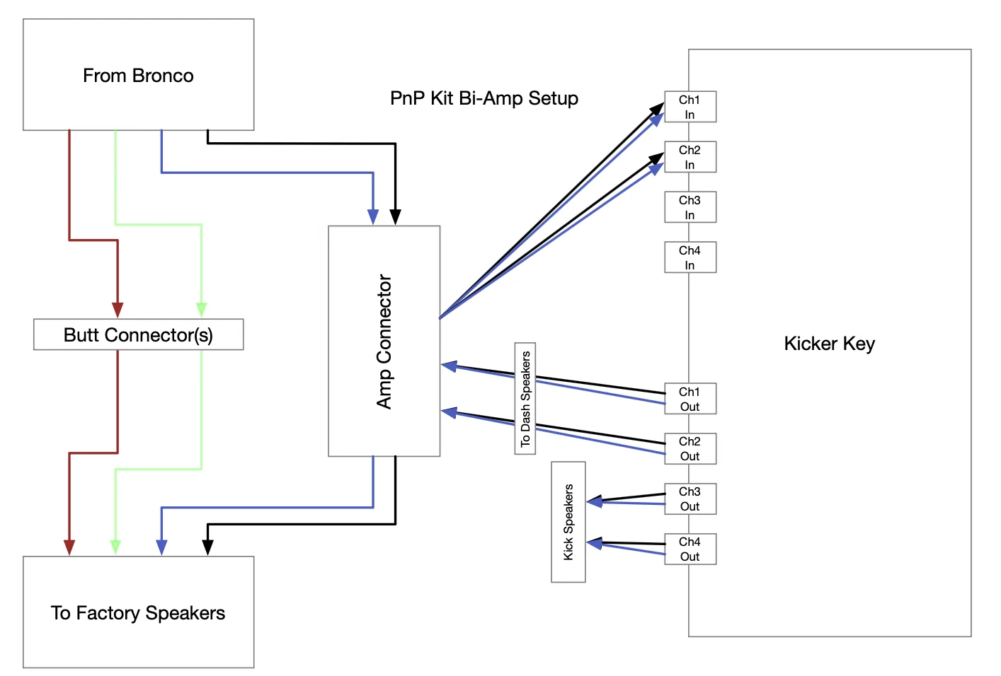

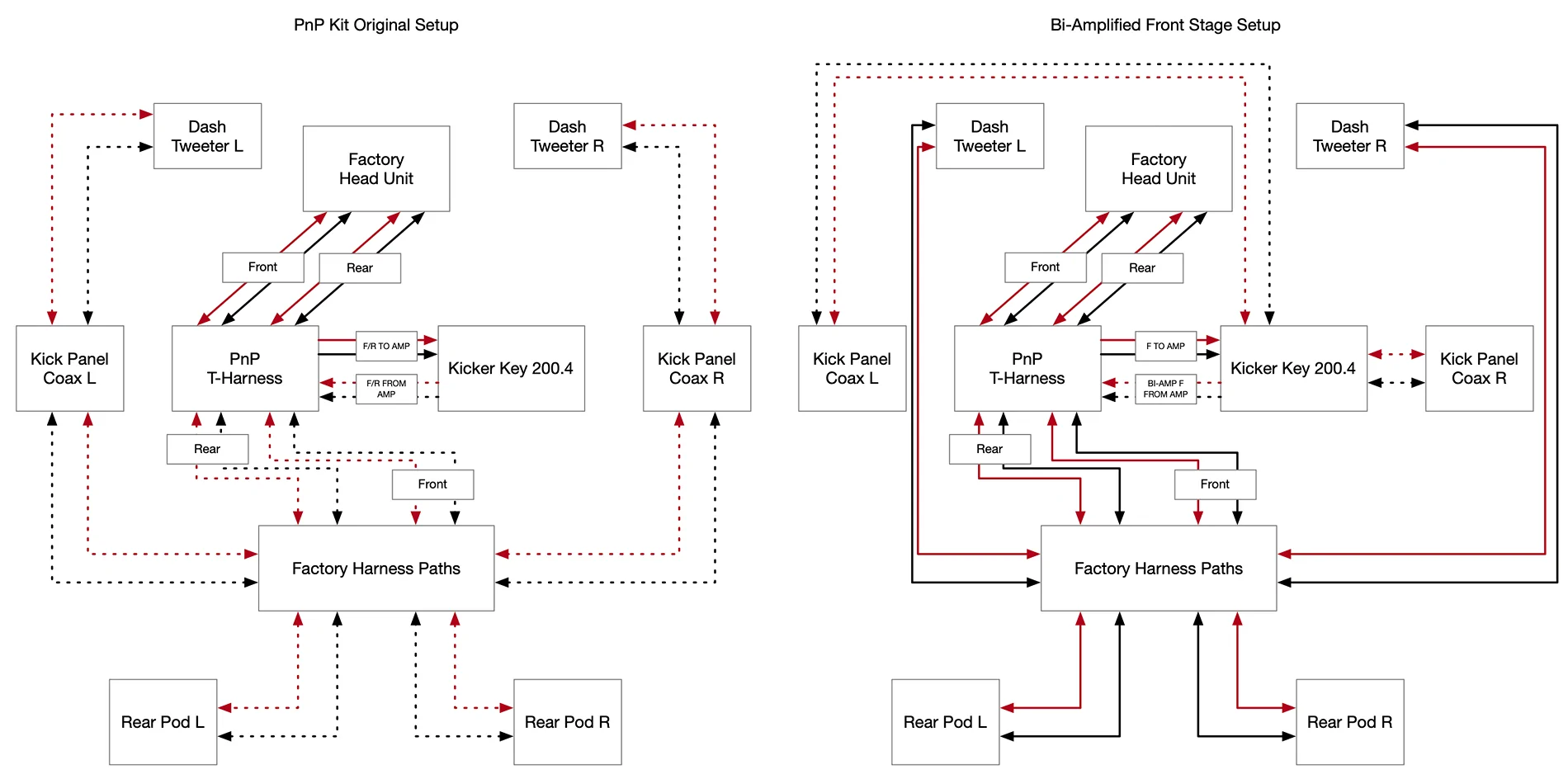

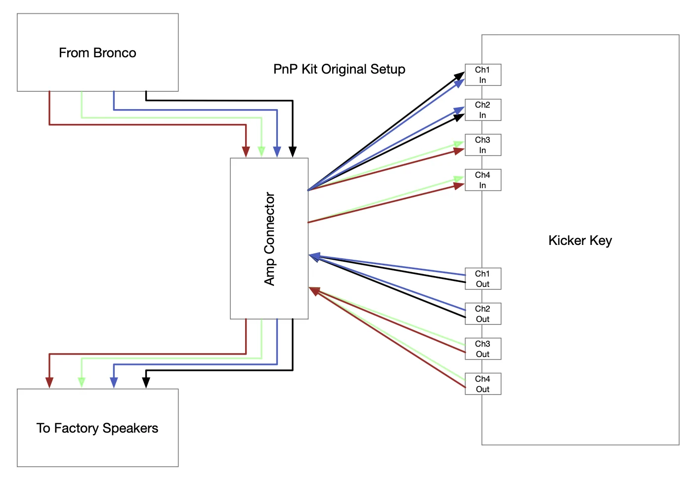

Thanks to @AZCoyote I was able to write up a step by step guide using all the information and knowledge be made available to us on this thread and forum. Here it is. Thank you @AZCoyote you're the man! If you see anything I missed, please point it out.
KICKER KEY 200.4 Bi-Amp Mode Wiring Instructions for 2021+ Ford Bronco w/ Plug N Play Harness (w/o B&O)
The harness is a Plug n Play "T" harness. (One connection coming out of the head unit, one connection to the factory harness and one connection to the Kicker Amp) You will see that color coding should exist the same way for both the factory & "T" harness. If it does, configuration will be very easy. If it doesn’t, you need to map it channel to channel.
1.) Access the plug n play harness "T" harness & Kicker amp under the steering wheel and under the head unit by removing the necessary panels. Disconnect and remove the plug n play "T" harness (this will make the install easier) Then start carefully removing the cloth tessa tape around all the wires for the plug n play "T" harness.
2.) For the rear speaker pods, you need to take apart the incorrectly wired plug n play "T" harness and just send the head unit power to the rear pods. (This will cause seat belt chimes, back-up and other vehicle alerts to be very loud and highly amplified. That's okay, it will be addressed later via FORScan programming) For the rear input channels, you will cut the corresponding wires about 2 inches from the end of the input plug going into the amp. Tape the stubby wires that were heading into the amp on the amp plug individually so they don’t short or touch anything.
3.) If the "T" harness wires match the OEM harness, cut purple, purple black stripe, green, green black stripe. So now you have freed up the two channels from the head unit that we’re feeding the rear input on the KEY. They are now disconnected from the KEY.
4.) On the amp output side of the "T" harness, the wires that are sending power out to the rear pods need to be freed up. Check to see if they are color-coded or mapped identically to the factory harness. The process is the same. Leave yourself a plenty of wire to work with so you can connect your kick panel speakers easily, about 3 inches of wire. You’ll cut the exact same colors on the output side. Purple, purple black stripe, green, green black stripe. (NOTE: Other possible color combination: (+) Right is Purple, (-) Right is Black & (+) Left is Green, (-) Left is Brown)
5.) At this point nothing should be going into channels (3) three and (4) four on the amp input and nothing connected to channels (3) three and (4) four on the amp output. You should have color matching sets of disconnected wires on both side sides of the plug n play "T" harness.
6.) Connect those "T" harness wires to each other by color. You probably note that you have long wires on the "T" harness. (If you don’t like that, the loop can be made shorter.) Do not tape anything up at this point.
7.) Pull the fuse on the Kicker KEY power wire near the battery. We want the amp off while you verify sound to the rear pods from the head unit power.
8.) Verify all your connections look correct, plug everything in and check for sound on the rear pods. (Test with radio & head unit fader) If you don’t hear the rear pods, go back and check crimps or connections and make sure your colors and polarity match.
9.) If you have sound to the pods, tape up the harness so it’s clean and compact and proceed to do the Kicker bi-amp set up.
10.) The easiest and correct way to wire the front kicks is to unplug the kick panel connectors. (Dash and kicks are connected together and wired in parallel from the factory, hence the aftermarket Metra adapters at the kicks.) Wrap the Metras in bubble wrap, or foam and tuck those connectors out of the way. They will not be used. This will leave AMP1 running just the dash speakers using stock wires. We'll need to run new wires to the kick panels and attach those directly to AMP2 left and right outputs.
11.) Set the dip switches. (Leave EQ, Bi-AMP and Time Delay ON, Compression Setting & Fader OFF, AMP 1&2 filter at 80Hz) Run DSP with head unit volume approx. level 24 (Right before clipping occurs). Reset gains using pink noise also at 24. (Gains only get set after DSP is done)
12.) Everything ready to be cleaned & tidied, finished for panels to buttoned back up.
NOTES:
IMPORTANT - During tuning, you set the head unit fader full front so the rear pods are silent and you pull the fuse for the subwoofer (if applicable). This keeps the tuning algorithm happy as it listens to the kick and dash speakers only.
*The only thing getting altered is the wiring on the third-party harness. No cutting, splicing or tapping the OEM factory wiring or harness.
** Part of the process of using bi-amp is flipping the switch to turn off fader. With fader off, you only need the left and right front inputs to generate all four of the output channels.
*** Be sure to set both gains equally as you raise them to just before clipping begins. (For example we don't want one at the 12 o'clock position and the other at 1 o'clock, they should be the same.)
**** Sound Deadening Material - Be sure to use plenty behind the kick panel and try to seal off all the holes and gaps in that space behind it. Then use a foam ring around the front of the driver so that it blocks the rear wave from the front. Use plenty of sound deadening material inside of the cavity behind the 4 inch dash speakers
NOTES:
