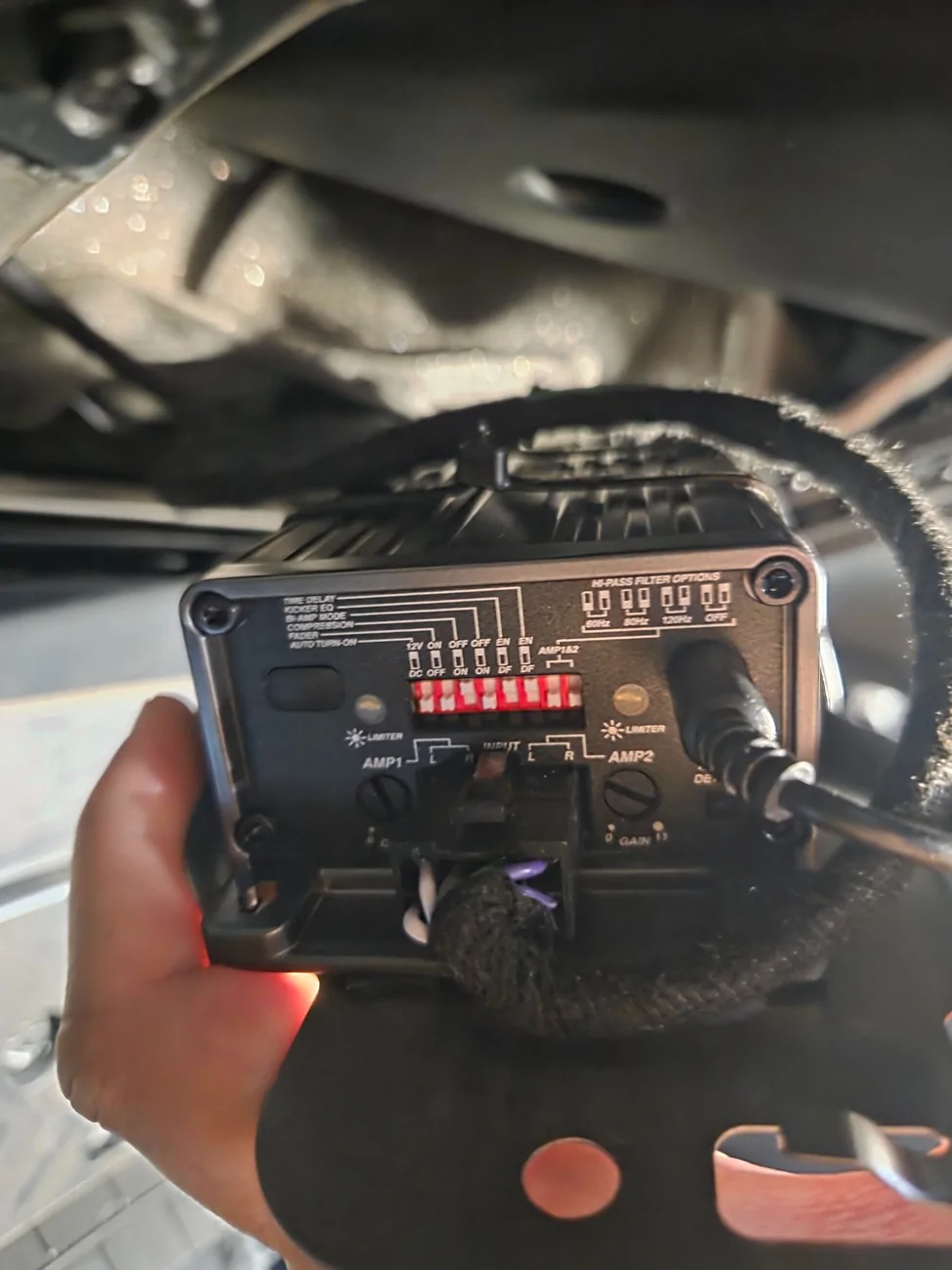

Thanks for the quick reply! Yep fader is set to off on kicker key here are my key settings but I will double check and update if not:
Power is dc
Fader off
Compression off
Bi amp on
The 2 other kicker settings are on i don't remember names
Cross over 80hz
Radio detect is on
Power 14g directly to battery
Ground connected above woofer on driver side
Ford Bronco Kicker Key 200.4 Done Correctly 1000019654
(I know amp 1 isn't at 0 was testing giving it a little more gain to see if it would pass eq setup in front middle)
Harness only have the front channels high input (cut rca) into kicker
Have Grey and white outputs to tweeters and green / purple to woofers. Green and purple from hu going to rear speakers.
**Update**
I double checked tweeter speaker wire it was correct. I swapped pos/neg
Ford Bronco Kicker Key 200.4 Done Correctly 17620653077747734925604309555057
(Original speaker cable going to tweeters cut harness to swap pos/neg to reverse for testing as suggested. Blue speaker wire going to woofer off green/purple new speaker wire runs.)
eq still fails when fader set to front middle (4 beeps). If I go just a tap left or right from center it passes eq. I cant do default (middle middle) since it picks up rear speakers and fails for ambient noise (6 beeps).

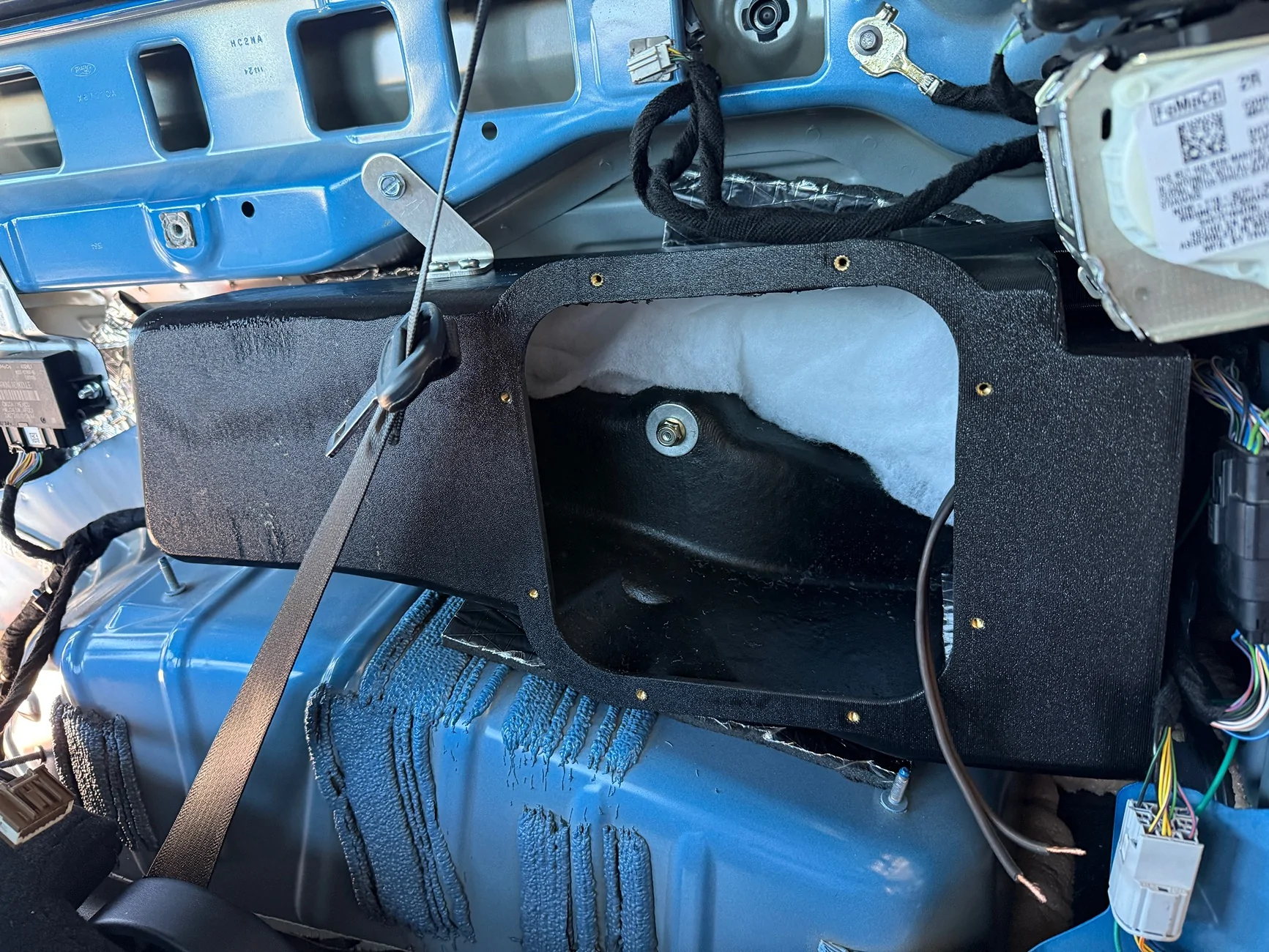

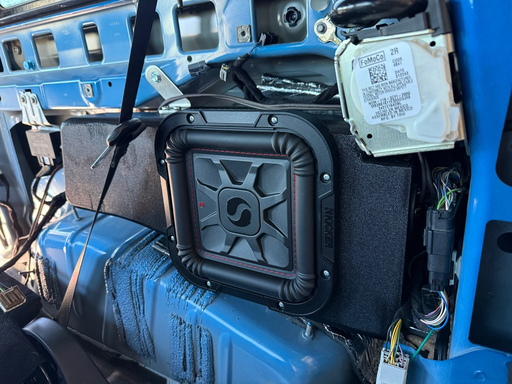

All told, the Key 500 install with Additve Audio 3d box and Kicker L7T 8” went pretty well. Taps off the factory sub harness gave good low level signals. Fitment is excellent. I put tons of deadener in the area with focus on any area the box might touch.
now, I almost came on here to complain about poor performance. Then I went for a drive to assess why I wasn’t getting as much bass as expected. I did the gain setup. Check. I did the DSP setup. Check. What could be the problem….
Alas, I committed one of the classic 3 blunders. The first two of which are….
1. Never get into a land war in Asia
2. Never go in against a Sicilian when death is on the line.
3. Make sure your fader is set to center before you do your gain and DSP settings on your sub amp. I had my fader to front checking out balance of the kick panel to the dash and forgot.
Realized this during my drive and fixed my fader. Blammo! It is fantastic. Tomorrow I have to pull the panel and reset my gains and DSP but at least I know that there’s plenty of output there now. It has more than enough bass keep up on all of my test tracks and my favorite music. Two thumbs up highly recommend.

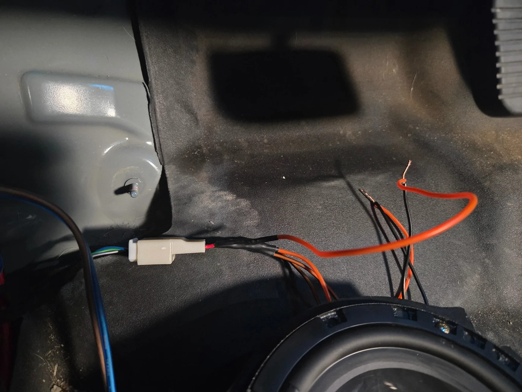

Ok, need a little help. I have done this - I thought about going bi-amp when I installed the Key in 2022 but didn't and now this thread has prompted me to go ahead and do it - but I have lost sound in the dash speakers. I have sound in the rear pods and the kick panels but not the dash. This is what I have done:
1. Cut the four wires from the input side of the Key that powered the rear speakers. The cut wires are all individually wrapped and left as 2 inch stubs in the input adapter of the Key.
2. Cut the four wires from the output side of the Key that ran to the rear speakers and joined the rear speaker wires to bypass the Key altogether. I have sound in both rears.
3. Unplugged the two kick panel speakers and wired each one directly to the cut wires on the output side of the Key. I have them wired directly - no adapters between the kicks and the Key. I have sound in both kicks.
4. Tapped into the rear speaker wires that now bypass the Key with my sub speaker wires - I have sound to my sub.
5. Dash - no sound to the dash in either bi-amp mode or non-bi-amp mode.
What am I missing? Is there some opened circuit on the unplugged metra adapters from the kick panel speakers?

Did you set the Fader dip switch? That tells the amp to send signal to all four output channels using just the amp 1 inputs. Also, you have Dash on Amp 1 and Kicks on Amp 2, correct? See post #1 for images.
MannyG20
Ted
Aug 6, 2020
743
1,454
F-150
I do have the fader set to off and the kicks on on amp 2 and the dash to amp 1.
I am stump at this point. I can’t figure out what went wrong.
I will recheck everything tomorrow and report back.

So when you unplug the kicks you have also unplugged the dash speakers. The kicks and dash are wired in a parallel. The current goes to the kicks and flows thru the kicks and onto the dash. If you look at your stock kick panel speaker it has 4 terminals. 2 go to the kicks and 2 for the current to flow on to the dash speakers. Easy fix, you need the Metra 72-5602 wiring harness. This is the harness you would get if you replaced your kick panel speakers. Just plug it in. You will not use the 2 spaded terminals as they would normally be used to go to your "new" kick panel speakers. The harness has a loop that will allow the current to flow onto your dash speakers. It is unimportant how I know this information. LOL Hope the above made sense. Metra Electronics | Products
