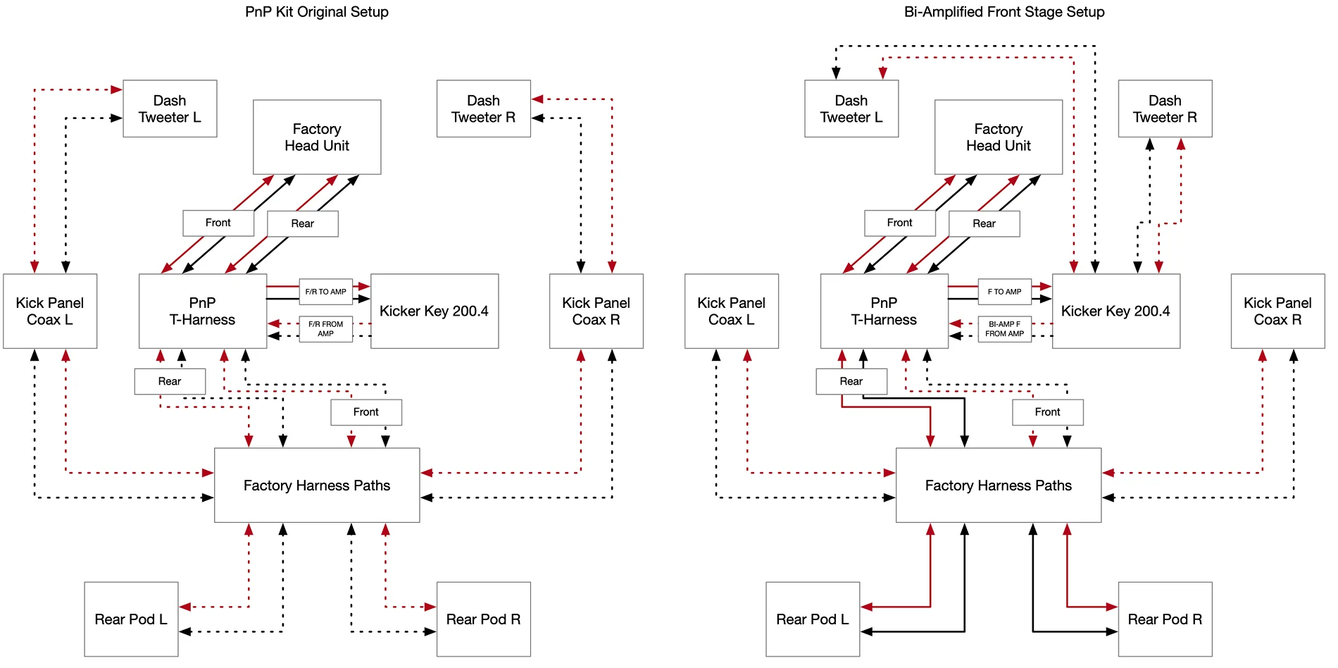

I have not seen a PNP configured for bi-amp but some manufacturers would make money if they made one. Call it an enhanced version that is “mostly” plug and play.
I think what I will probably do is re-order the newer version of the PnP harness, and modify it prior to install and then bang out the tweeter runs and the positive lead to the battery in one pass. Thanks again, I'll circle back to take more notes once I have that harness in hand.
At least, this is how I've understood what's being described here:
what is the newer version? Is it to deal with A2B stuff on newer radios?
Second image is incorrect I think. Dash and Kicks are attached to the Key.
The dashed lines represent what is powered by the kicker. The T harness is used to reuse the wiring you to the kick panels.

OK. The kicks get entirely new wiring and the dash uses what was wired to both dash and kicks.
