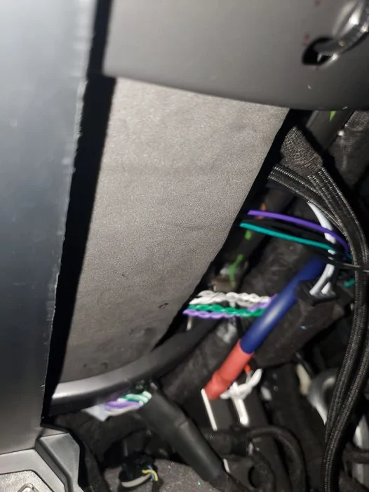

I called and just had him make me one that met my specific needs. I had a 3 or 4 foot harness with the ACM amp and then an additional 17 feet of high level speaker wire to hook up the amp that I have in the back for the sub. The amp easily fit under the dash, above the glovebox on a scrap acrylic sheet plate and some CCF glued to it for cushion and zip tied.
Ford Bronco KICKER KEY 200.4 IN STOCK . 363987478_10227453527337326_2619387097144721399_n

Just received my Key 200.4 and harness in the mail today. Thanks PNPkits for making this an easy upgrade for us!
We don’t even have 1000 miles on my wife’s 2023 yet, but it only took about 5 min to realize this OEM high package audio was underpowered distortion filled crapola!
