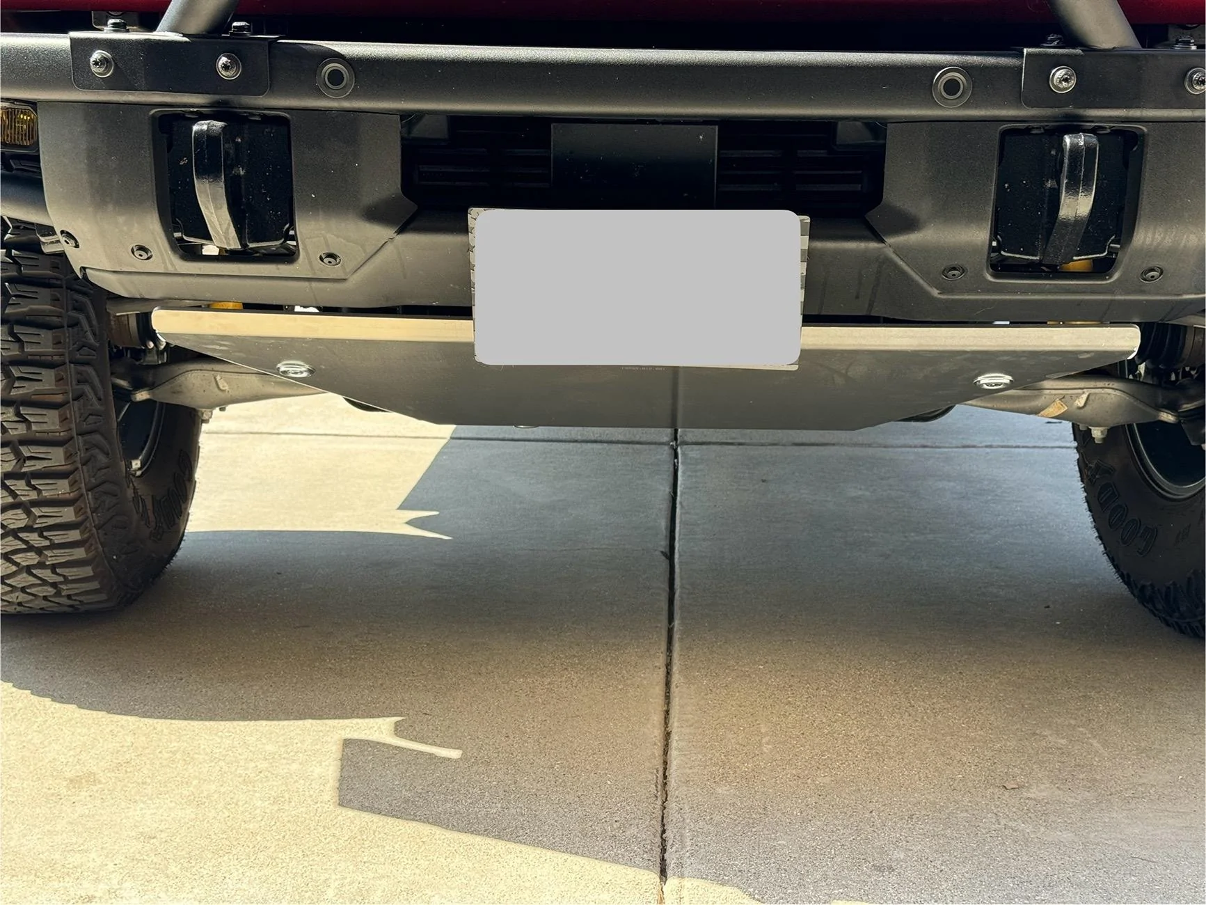

Just an FYI for anyone considering ASFIR skid plates.
There is a lip on the bottom of the steel bumper. The front edge of the OEM skid plate and (at least some) after-market ones (Talon for example) fit behind this lip for a seamless look. The ASFIR fits in front of the lip leaving a 1/4 to 1/2 inch gap.
I’m not ripping on ASFIR and this gap may not matter to some.
Corrected major typo—first line should read ASFIR, not Talon.

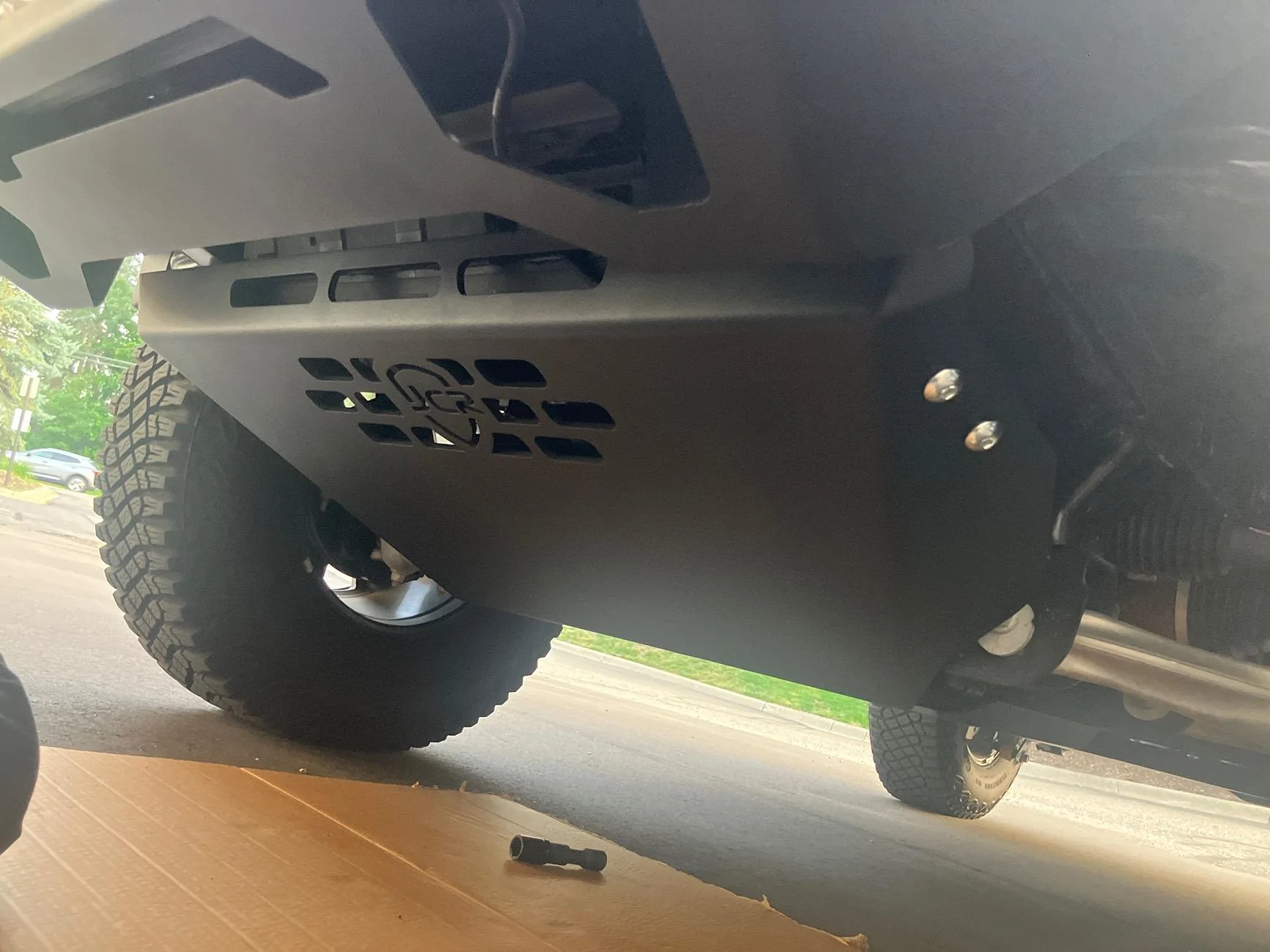

JCR aluminum front/engine plate with an aftermarket front bumper. Fits like a glove. I like that it's one piece and replaces two stock plastic skids on my Big Bend.

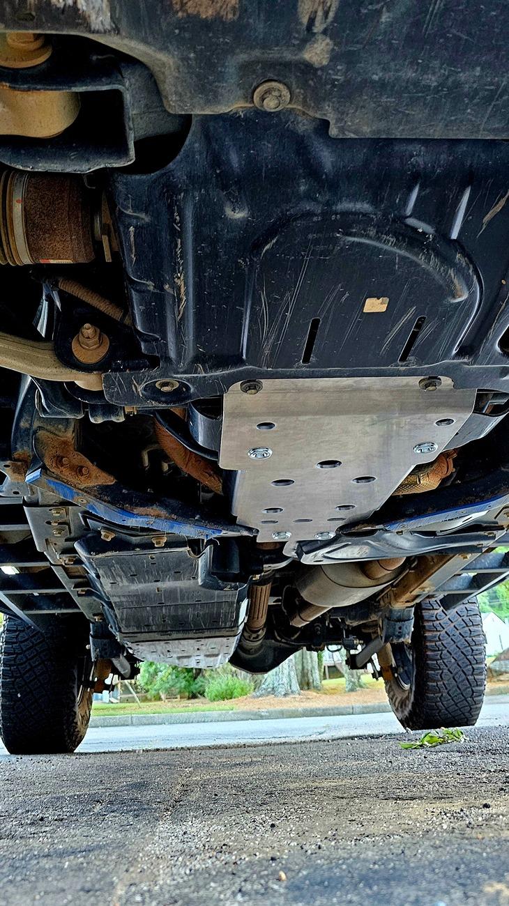

I just wanted something lite and simple to cover the trans on a badlands. I went ASFIR. Simple straight forward design and fitment.
The only concern are the pocket washers they use. Easy to over torque and damage. They offered new replacement ones for free... plus $42 for shipping. It was my fault, I'll deal with the damaged ones.
But if anyone orders anything from them, ask them to throw in 2 M10 pocket washers and I'll pay for US shipping 😉
