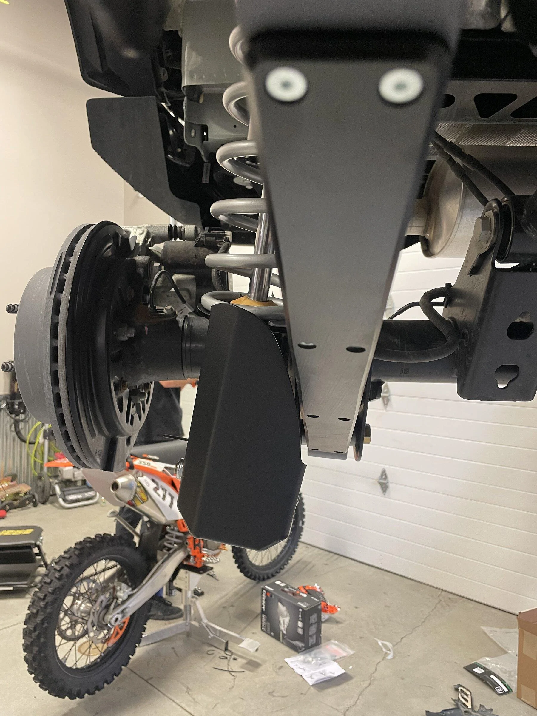

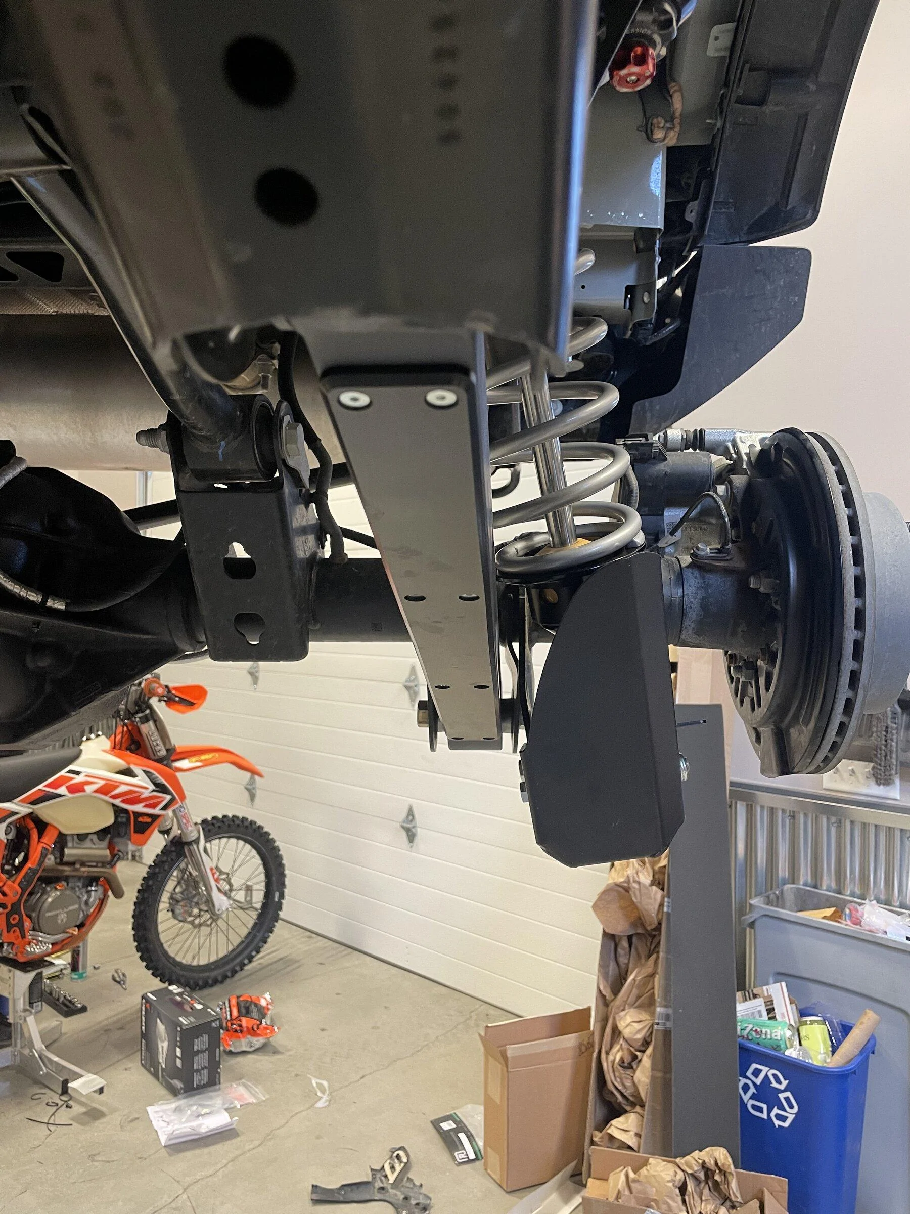

Due to the slight variations in the lower shock mount angles these JCR shock skids can be way off from being lined up with the shock. After sending multiple photos and emails of how crooked the passenger side skid is on my Bronco Mitchell at JCR said “ I don’t see an issue with that” LOL. He doesn't see an issue with the skid mounting so crooked it looks terrible and it will hit the trailing arm. You'll be taking a chance if you buy these and they won’t take them back.

I spoke with Mitchell this morning and he filled me In.
1.) Those are aftermarket control arms
2.) You have aftermarket coils
Is the axle centered? At droop, the axle is going to shift down to the passenger side, making the skids closer on the passenger side. It will be worse if the traction bar has not be changed to accommodate additional lift.
These were designed with factory control arms. If aftermarket control arms are larger in shape, that can make things tighter.
Have you checked the positioning on the shock mount from the factory? Is it slightly angle vs the other side? The skid bolts to that. A slight difference from the factory can cause it to be angled.
