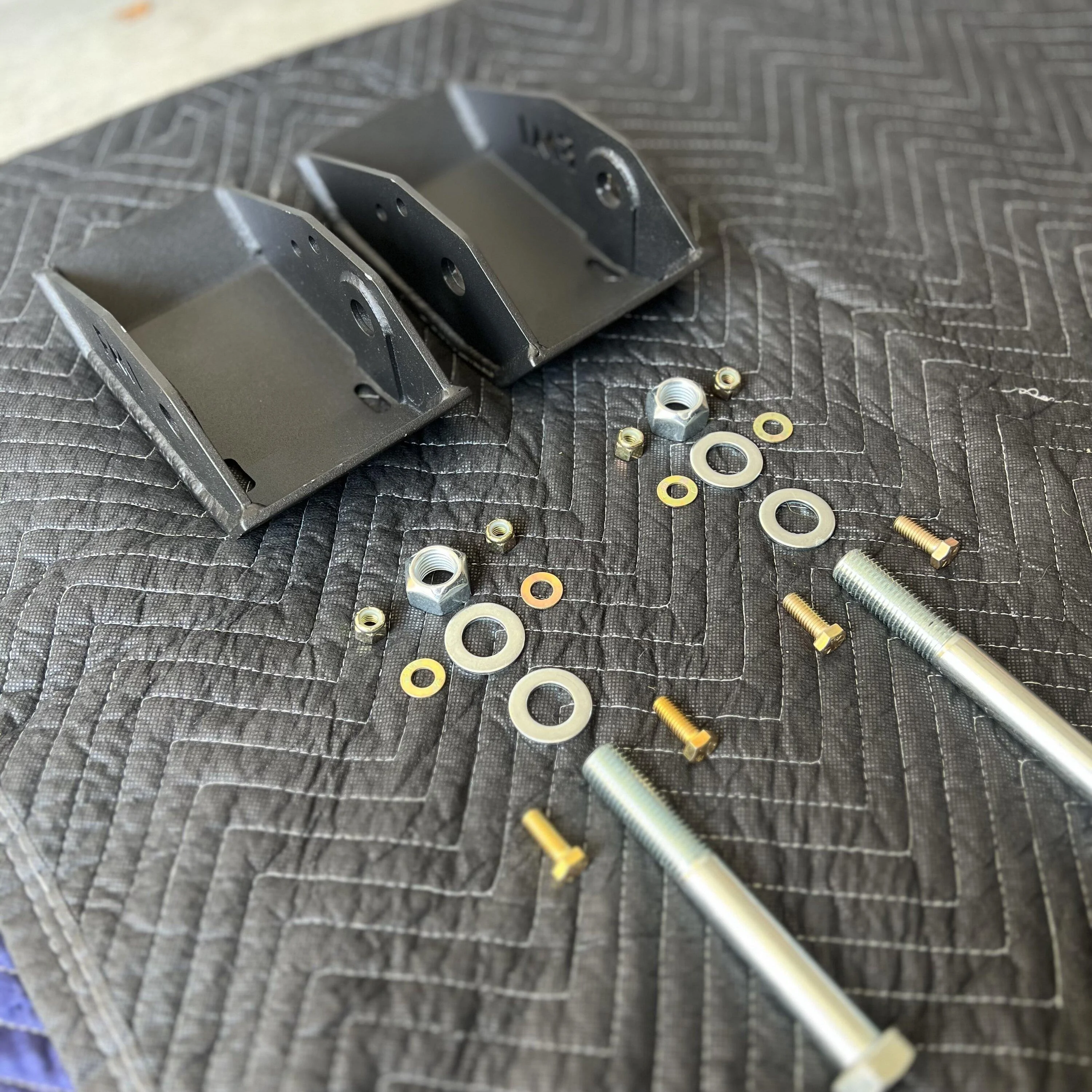

I used the Foutz and they are amazing. I like how the bash plate extends past the side plates thus covering/protecting the weld connection. Mounting directly to the lower shock mount feels like the most robust design, albeit a challenge with the 350 ft-lb torque spec. I'd say a 30-minute install.
Ford Bronco Rear shock skids... which ones? IMG_2287

These images explain one mystery for me. Some of the shock skid install videos say to add washers on the inside of the skid to enable proper torque against a flat surface, others don't. The images above show that the Foutz ones clearly have the washers built in, which makes them easier to install. The MetalCloak and BroncBuster ones do not, and the install videos I have seen make no mention of spacer washers. The JKS and JCR install videos call out the need to add spacer washers.

jks supplies the inner and outer washers
