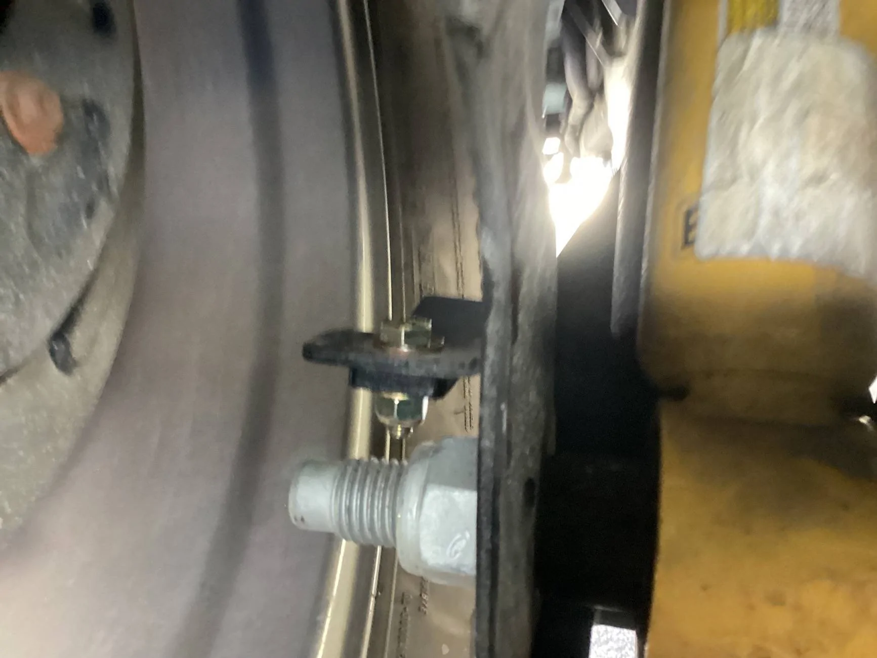

So I went to install these yesterday thinking it would be easy peasy (thus not really leaving myself enough time), but even after taking the wheel off I could not get my fingers in between the shock mount and shocks to hold the nuts (so that I could ratchet the two screws in from the inner side). Tight tight space...combined with my big hands :wink:
How did you guys get these installed? Maybe by taping the nut to a small wrench/ratchet wrench to hold the nut in place? Looking for a plan before I try again...

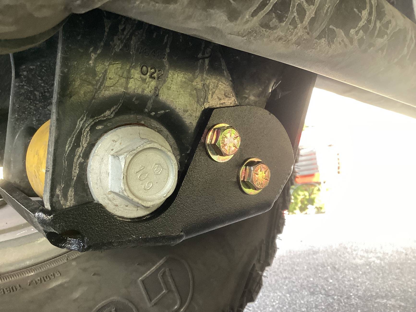

Thought I would ping this thread again before I craw under the Bronco today. Looking for a strategy to hold the nuts (tight tight space) on the backside of these two bolts so I can tighten them:
I may not be seeing the entire picture, but from this angle sure looks like it wouldn’t be an issue if you pop the tire off?
Yep, I just borrowed Barnes stock pick. With the tire off getting to the nuts is actually not any easier, because the skid up next to the shock (when in position) creates such a tight space - I can't even get my finger in there (though I do have large hands), and last time my standard size wrench (maybe its big too :ROFLMAO:) could not even squeeze in their usefully. I'm thinking maybe the solution is to stop by Harbor and get the smallest/thinnest wrench/rachet wrench set they have, and then maybe tape the nut into the wrench and see if I can wiggle it on and hold it long enough to tighten...wondering what others have done.

Hmm

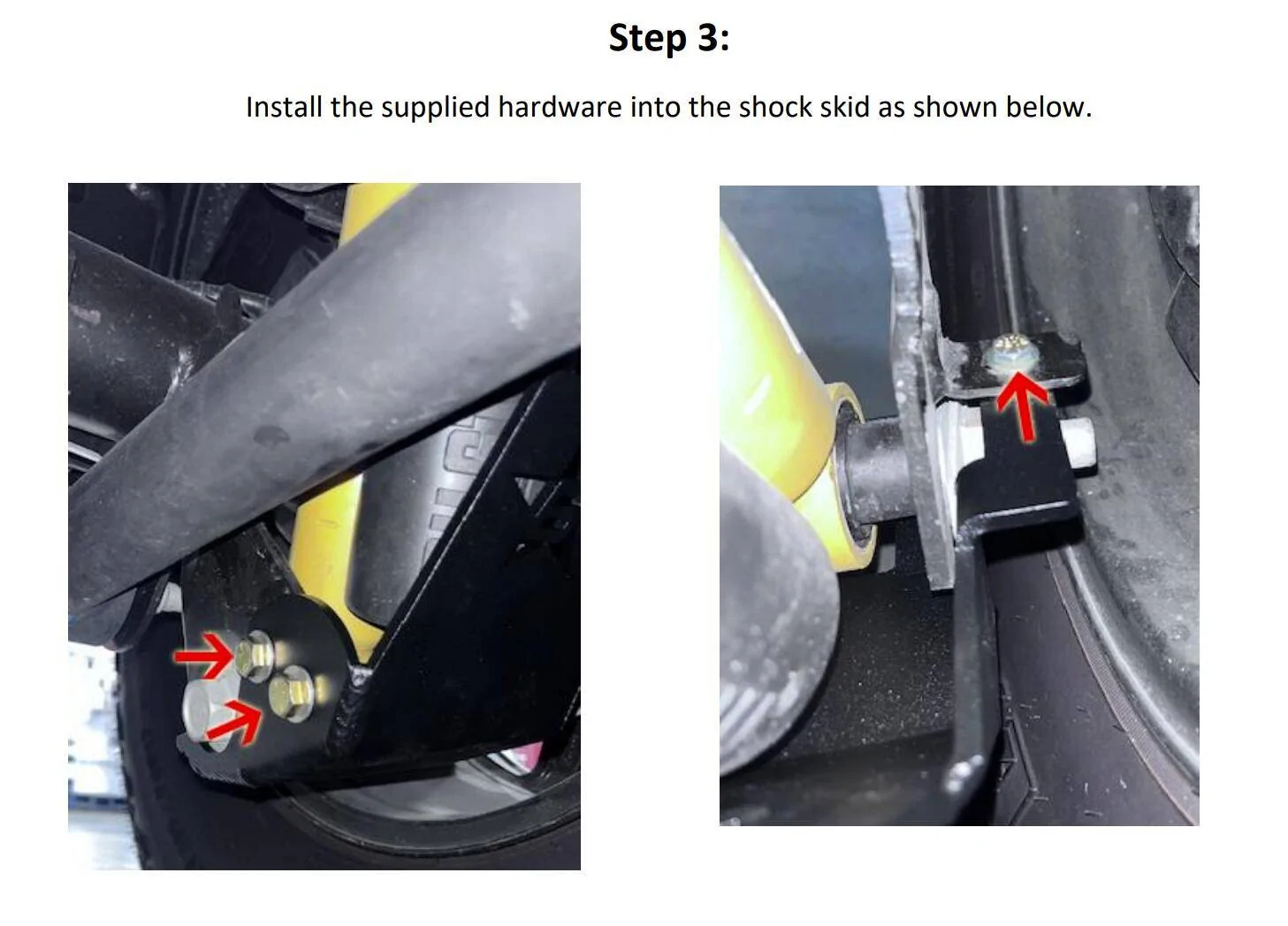

This is from the install instructions, which look straight forward:
Ford Bronco Barnes 4wd shock skids 1734193527956-
I see your issue now - the bolts don't go all the way through, they are just short and bolt to the inner plate of the shock mount - so the shock itself is in the way.
Well, first thing I think of looking at it that way, but probably not the easiest solution there is: get yourself a cheater bar and pop the bottom bolt off the shock - that's a 300ft-lb nut there, but with it off (and some finagling of the shock) you can drop the rear end down a bit further on a jack or hydraulic table, get the nuts on there without pulling the entire shock out, and then lift it back on once you do.
Apart from that, I think your idea of something skinny to hold the nut would be the other option and not a bad idea. Popping the shock off isn't hard (other than you need either a big impact or a nice cheater bar), but it certainly adds a lot to this installation that should otherwise be straight forward.

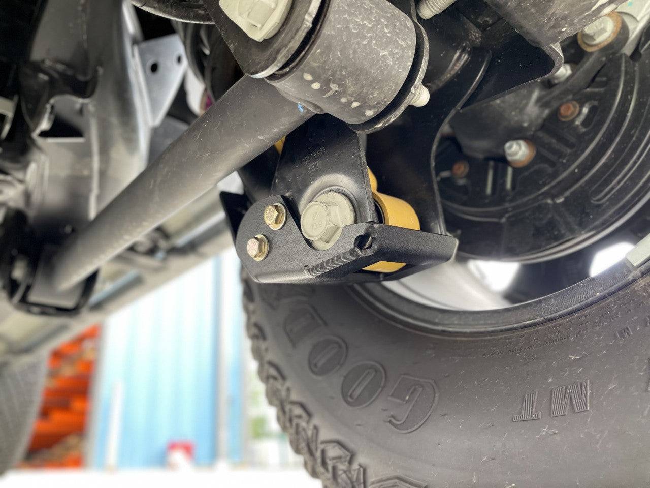

Got my Christmas present put on this morning 😀
Do tell, how did you hold the nuts (while you ratchet) on the backside of the two bolts shown in your first pick...I still have not circled back to this yet.

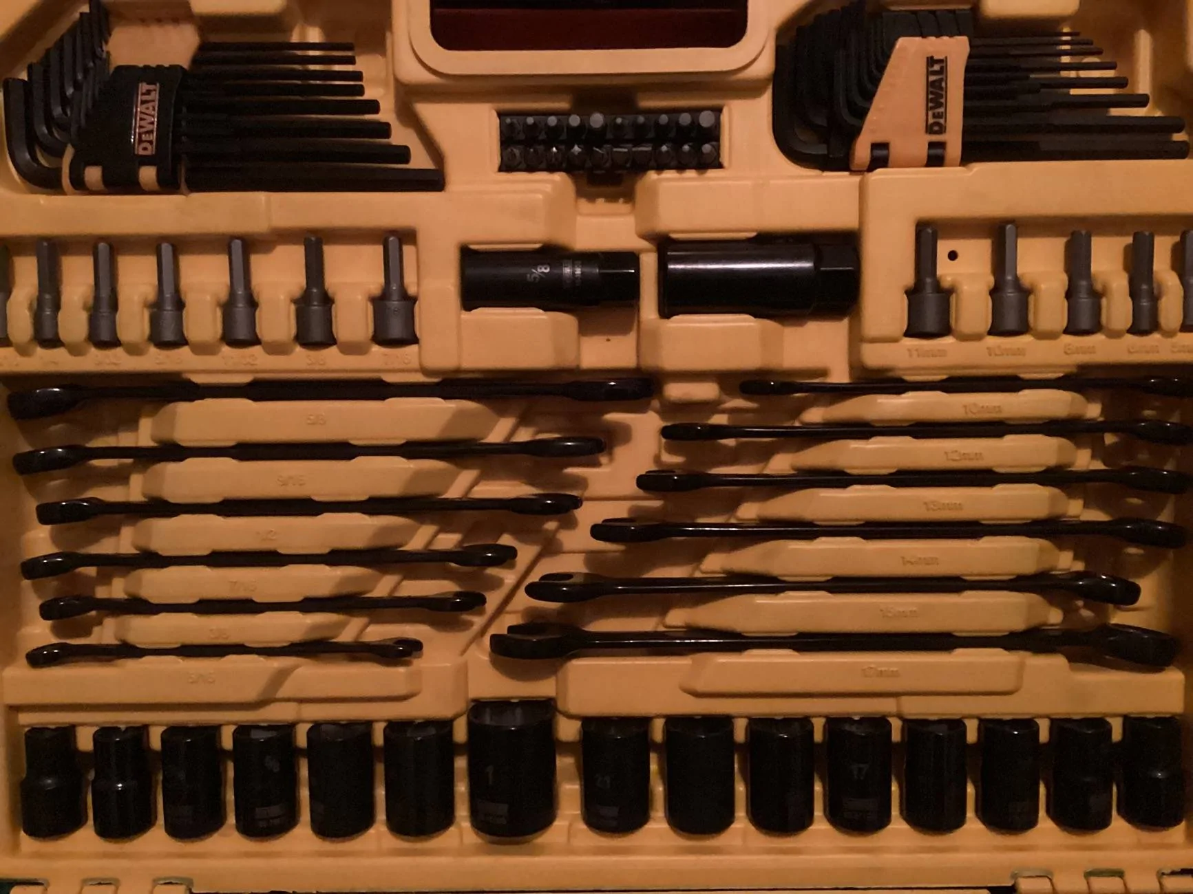

These are the wrenches I used, from a set labeled with the Dewalt name bought at Costco about six years ago. Not sure if they still get them in or not.
