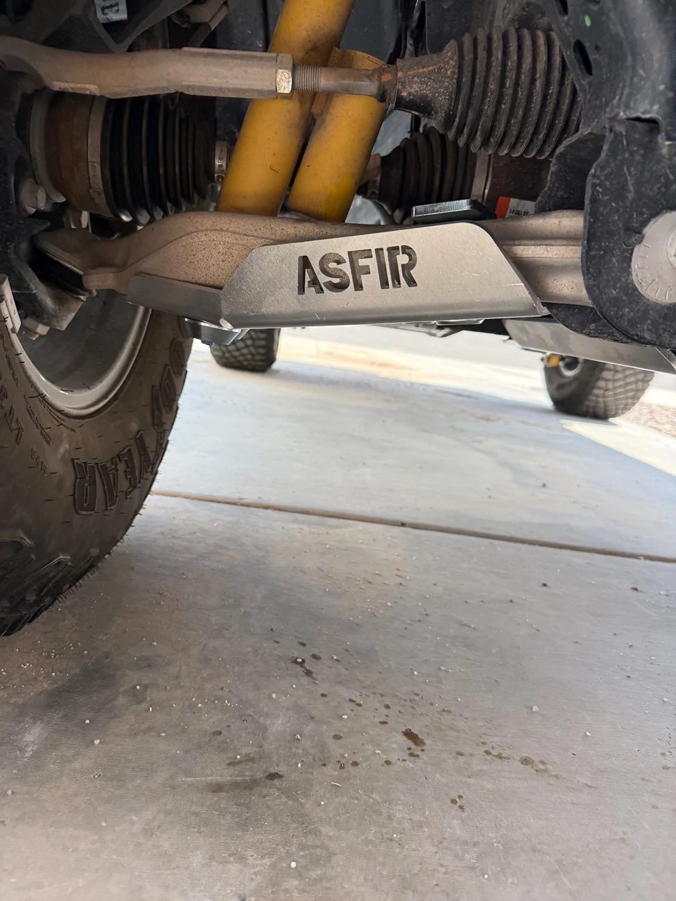

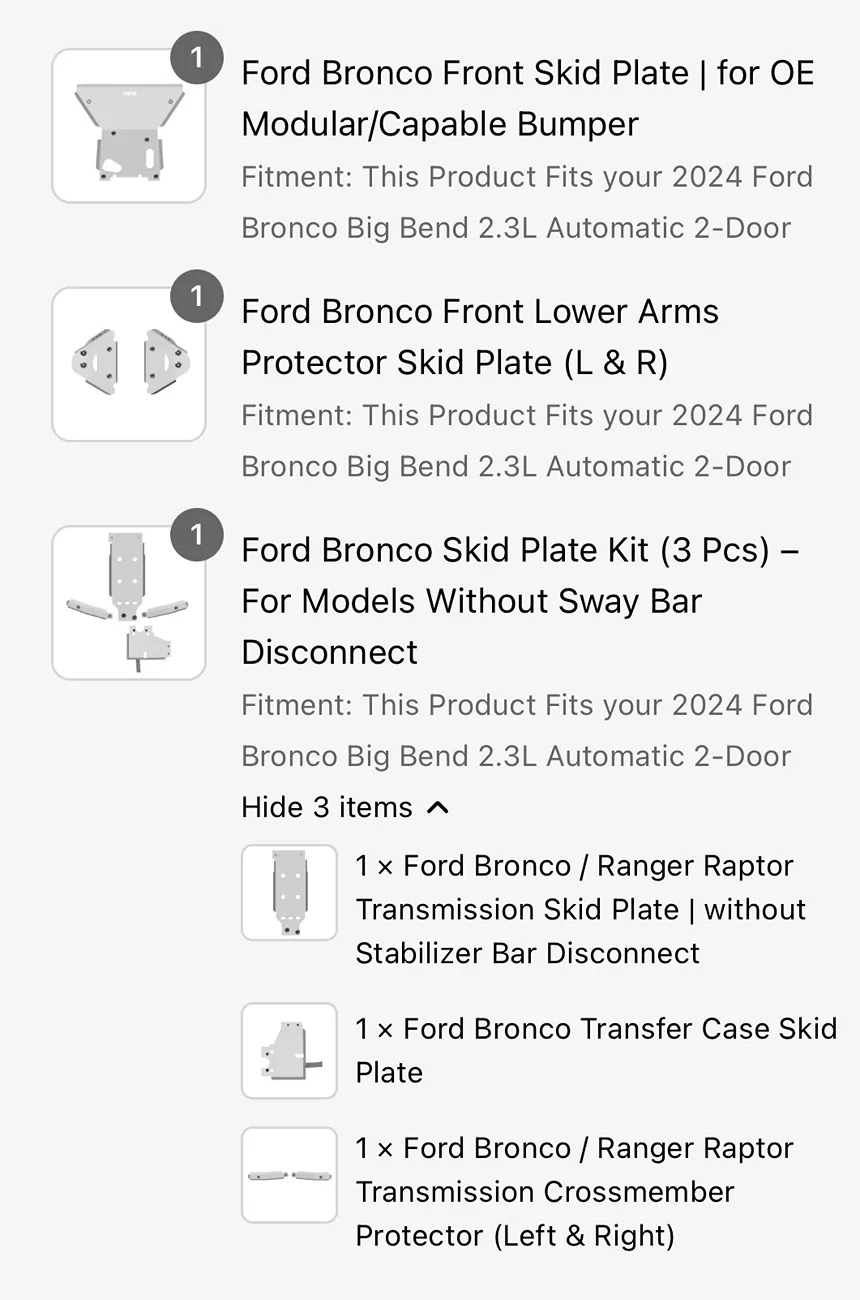

My ride is a 2 door with a 2.3 so no need for the crossmember skids. The rest of the skids are excellent quality.

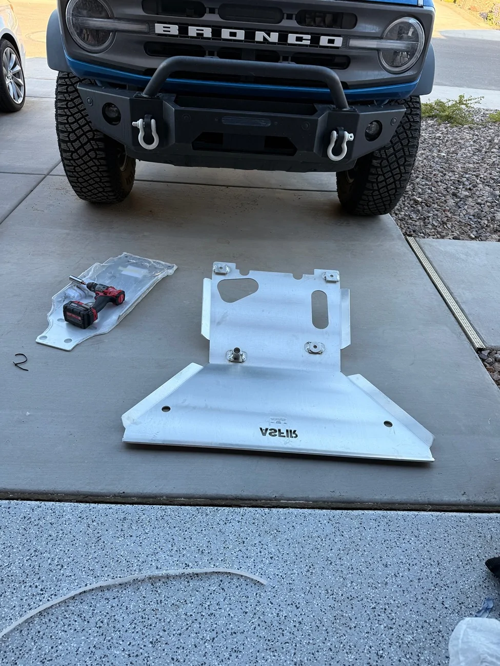

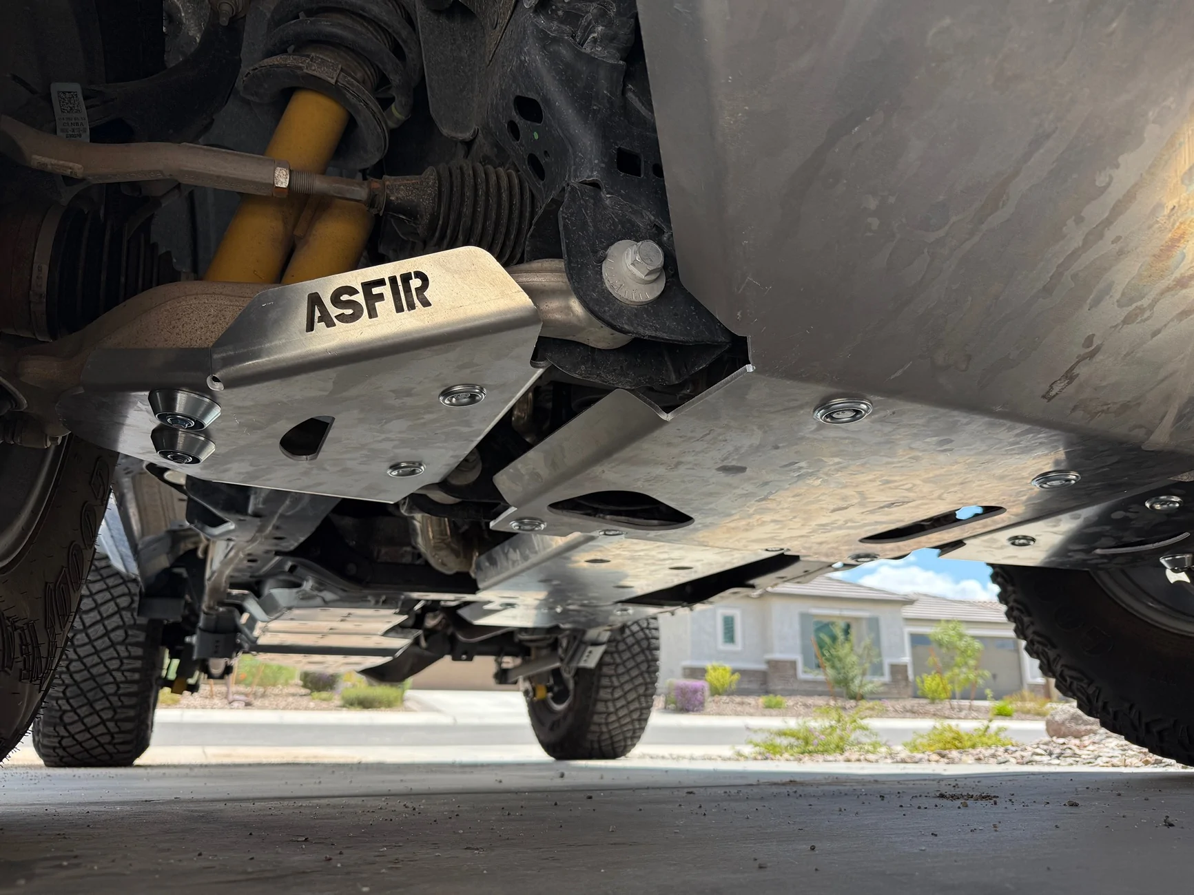

some tips on assembly.
Start at the back and work your way forward.
apply LockTite to every bolt and nut to stage them
leave everything loose until each panel is in position. Start at the rear as you tighten so overlapped parts remain aligned
apply even pressure to bolts on each skid. The tolerances at do tight that Any uneven pressure can make getting dependent parts very difficult to align.
torque everything last as a group. Enjoy converting newton meters to pound feet.

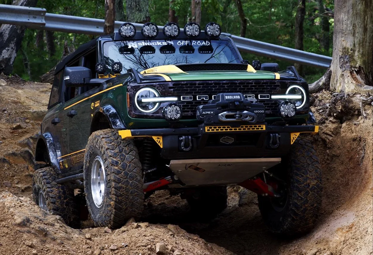

I run all their skids and their sliders on my 4 door, love them!

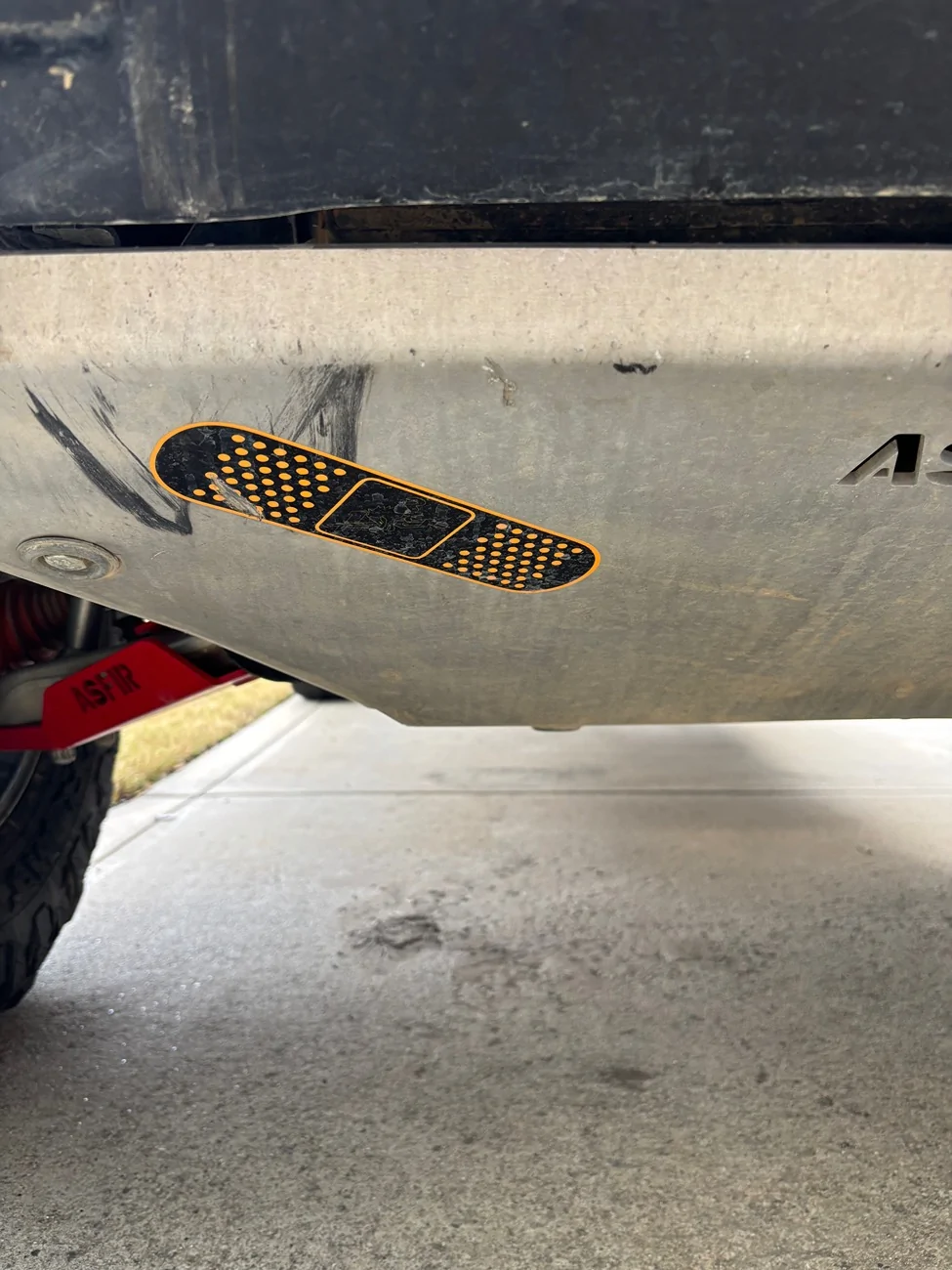

The aluminum doesn’t get bent to shit?
there are a few dents for sure, but they’ve held up nicely. The gas tank skid has taken a tremendous beating. The front skid has been full force dropped onto boulders a few times. I just put a bandaid on it and keep wheeling.
