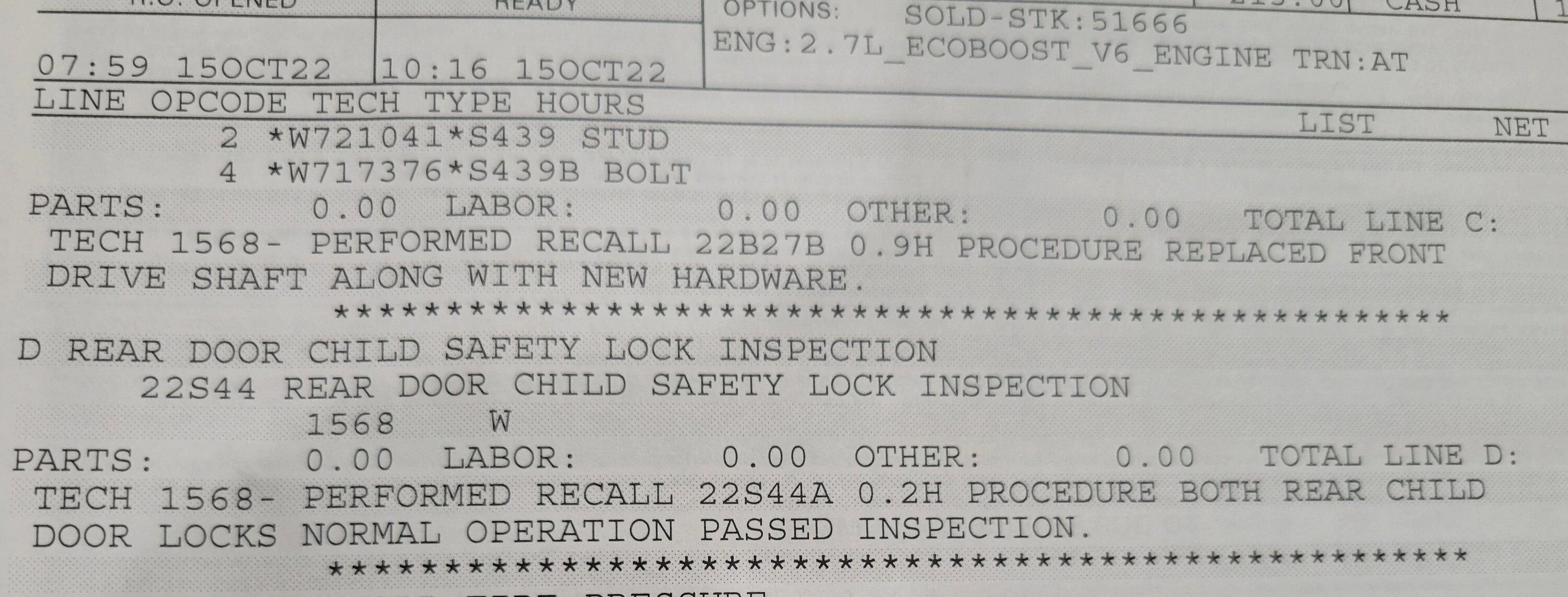

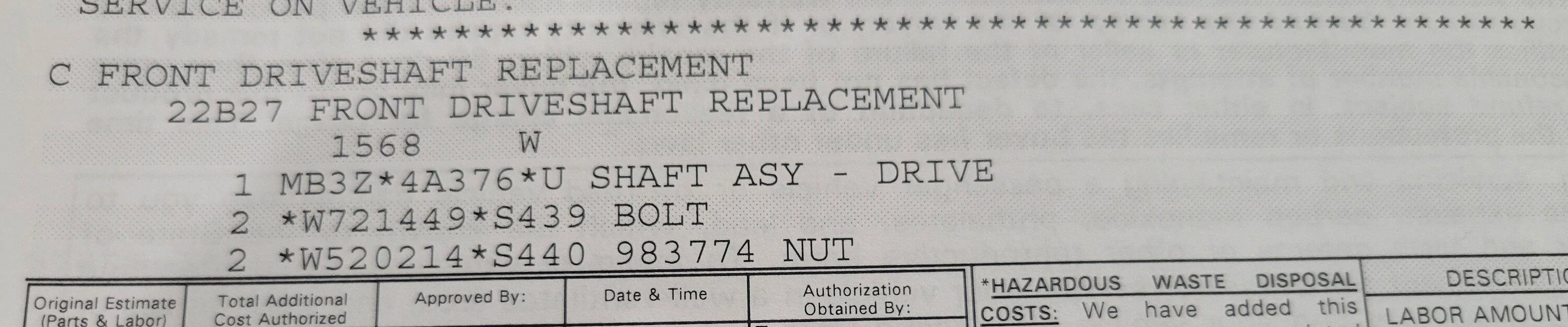

Took my Bronco in for service today. I had not seen this post before so I only knew about the rear door child safety lock recall. It was taking a little longer than I expected so I went and checked and was told about this new recall. Tech said my boot was torn but I didn't get to see it. Here's the parts they replaced from the report.
Ford Bronco INCOMING: Driveshaft Recall (Customer Satisfaction Program 22B27) - replacement needed to avoid cracked boot 20221015_121342
Ford Bronco INCOMING: Driveshaft Recall (Customer Satisfaction Program 22B27) - replacement needed to avoid cracked boot 20221015_121357
