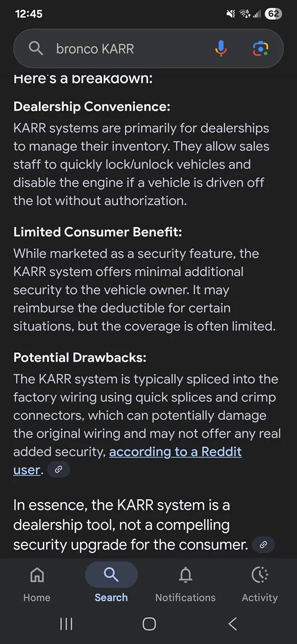

I would say the KARR is the problem. This is quoted from Google A.I
"The "KARR" system mentioned in relation to the Ford Bronco is a dealer-installed security and convenience package, not a factory feature. It's designed primarily for dealership use to manage and control vehicles on the lot, with limited benefits for the consumer. The KARR system often includes a kill switch and a single fob for multiple vehicles, but it doesn't offer significant security enhancements for the vehicle owner."
Unless it's a condition of your purchase or something I'd ask for it to be removed for starters. I've never heard anything factory that's caused a horn to honk that fast 3 times
Ford Bronco Horn alert Screenshot_20250706_124540_Googl
Unless it's a condition of your purchase or something I'd ask for it to be removed for starters and start unsplicing things. I've never heard anything factory that's caused a horn to honk that fast 3 times
Unless it's a condition of your purchase or something I'd ask for it to be removed for starters and start on splicing things. I've never heard anything factory that's caused a horn to honk that fast 3 times
Well there you go, I'd absolutely start there!!
One of my previous vehicles, can remember which, would do this if the battery was low, to alert you. Not a standard feature in Bronco, but maybe that is something baked into KARR. In any case, that add-on system is def probably the culprit.
