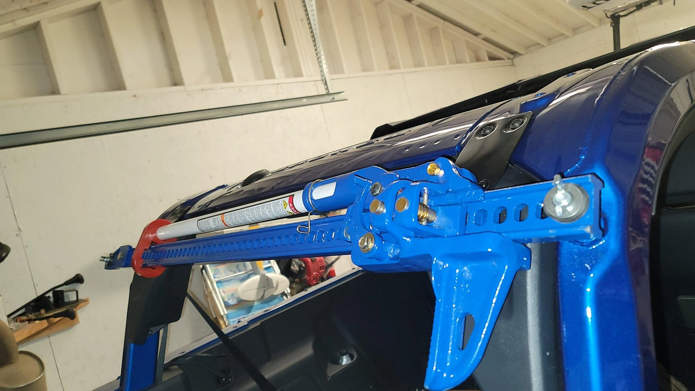

Think I'm interested in something similar (in location and orientation) to the Jeep mounts that stand it up on in the right rear corner. I believe those piggy back off the tailgate hinges.

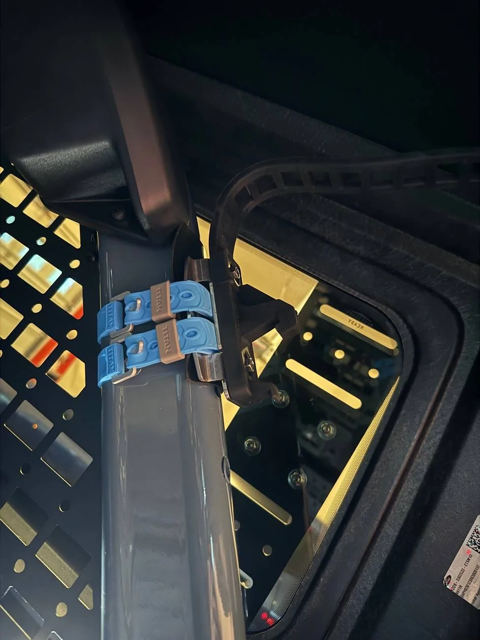

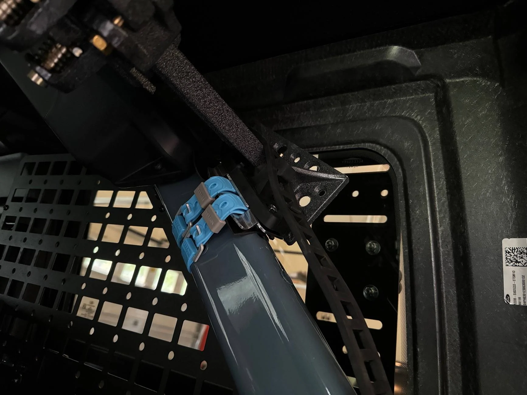

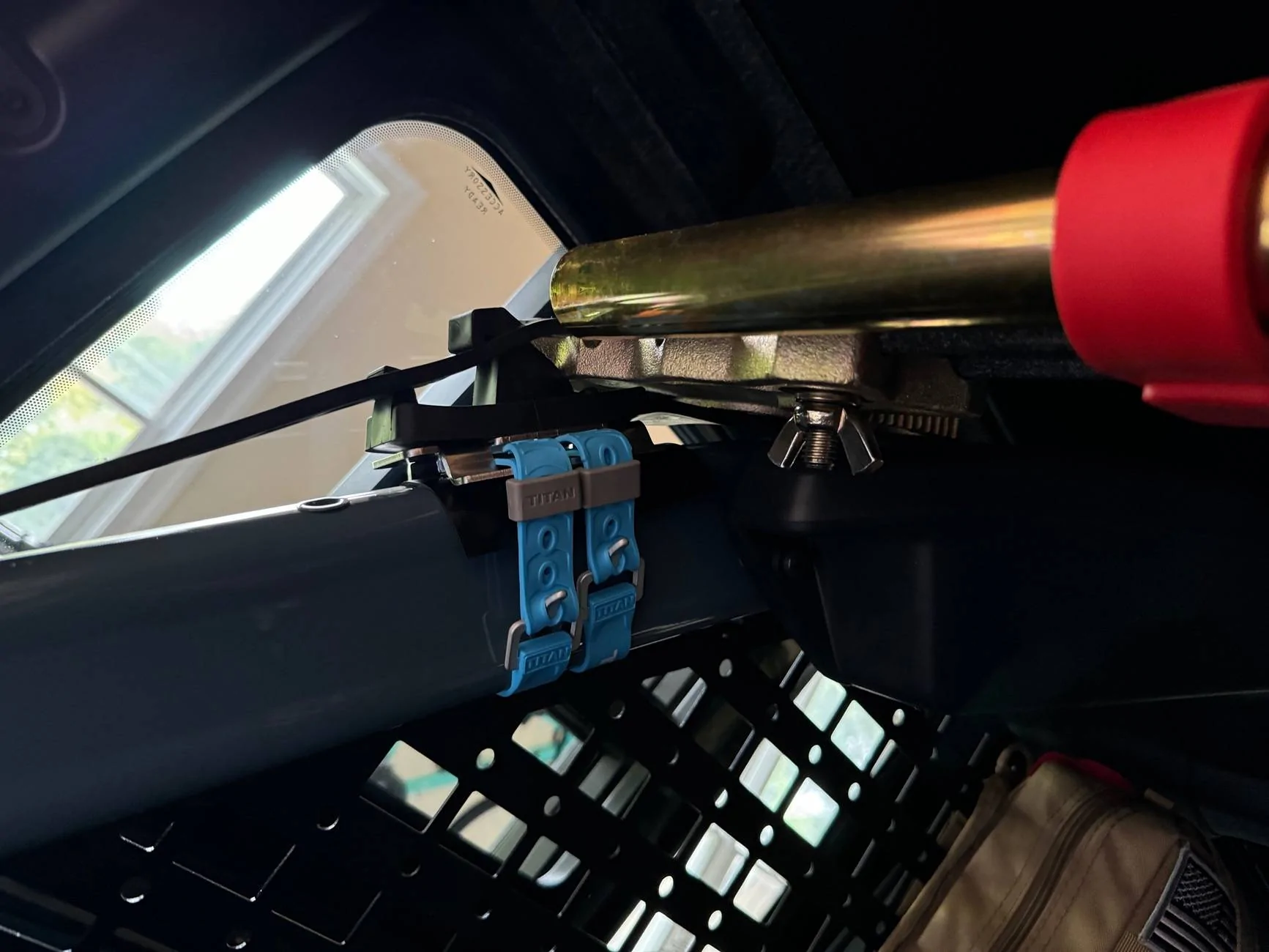

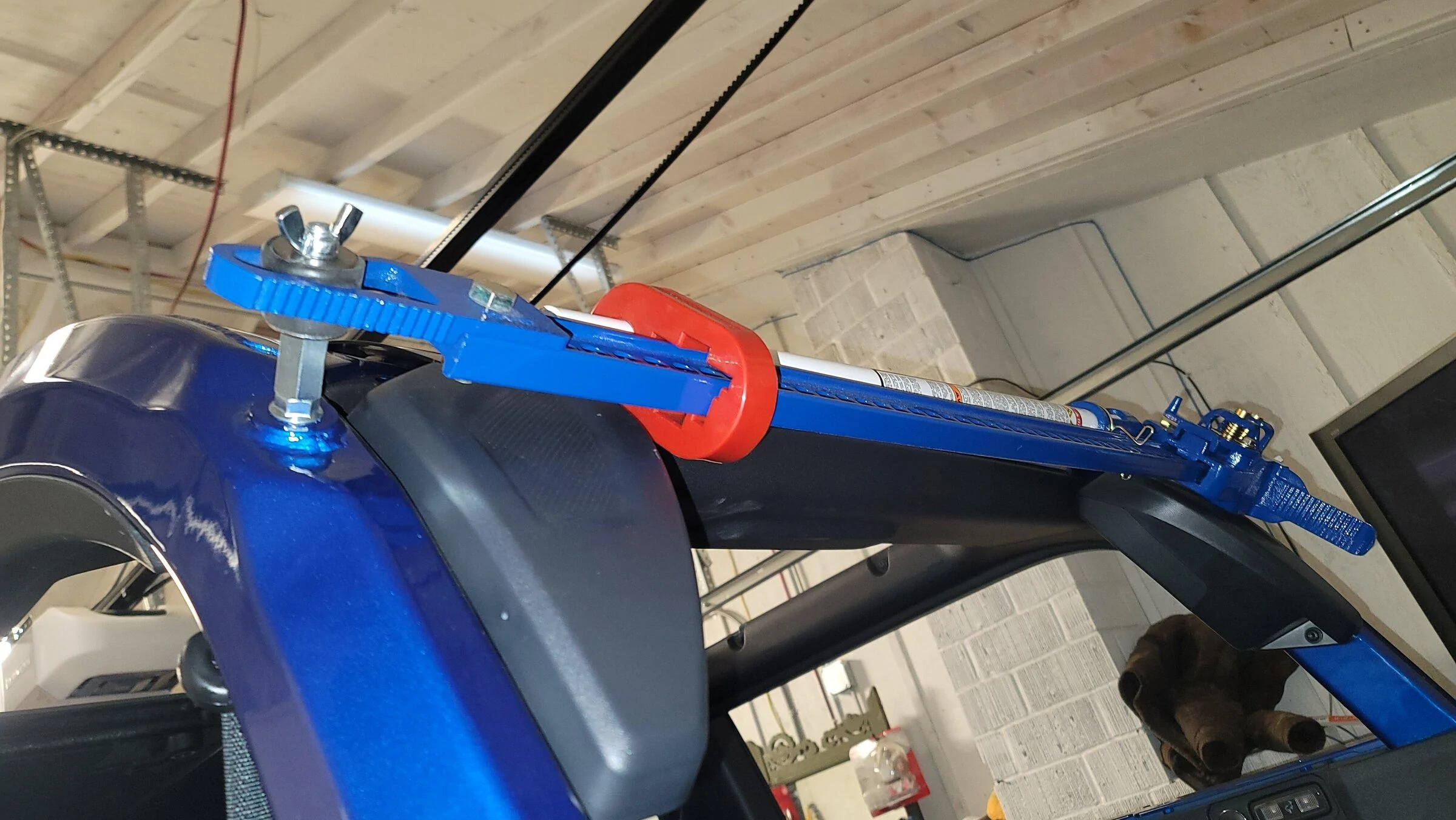

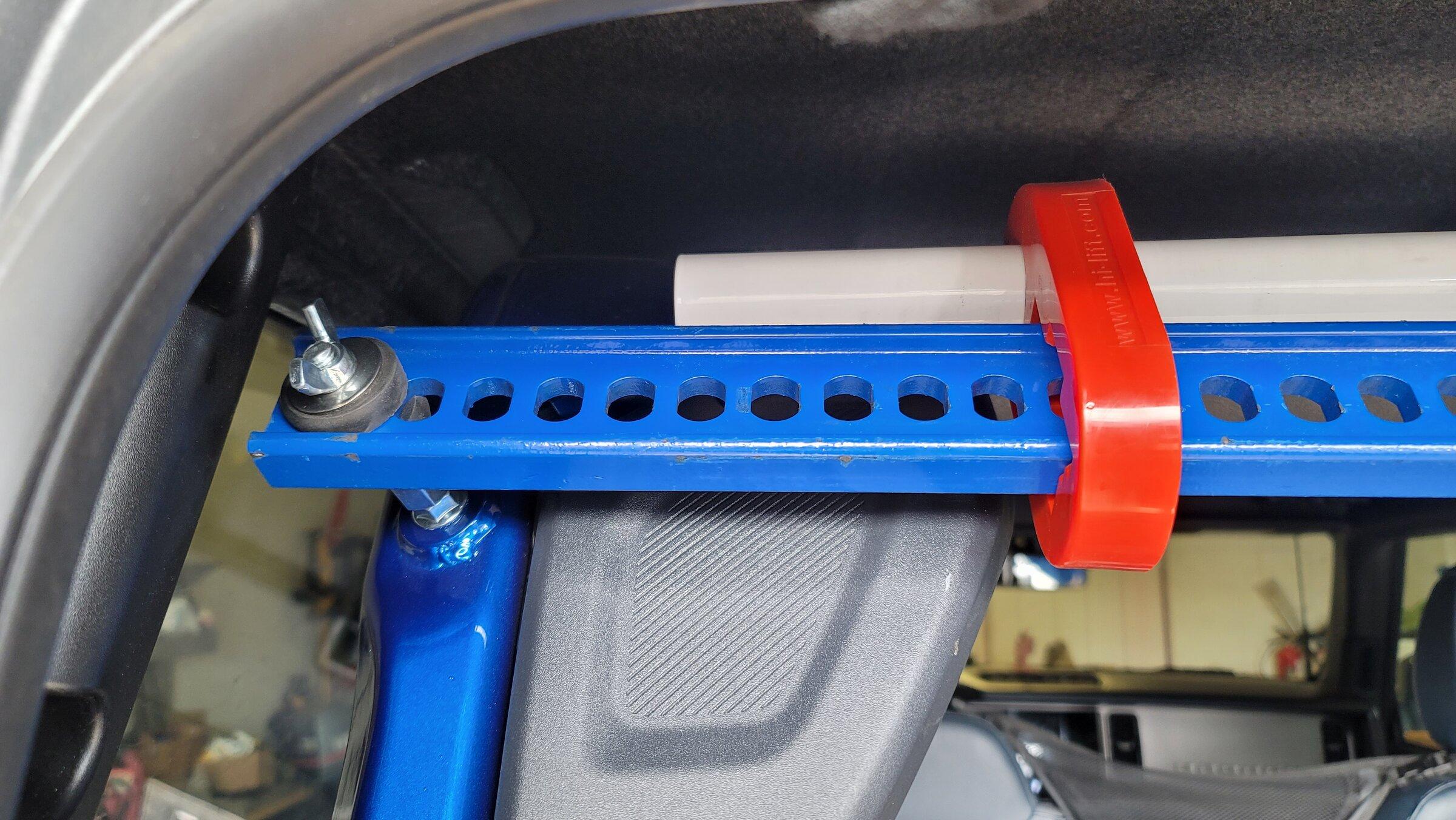

I’ve got a 4 door model and will mount to the rollbar. The other solution presented here (mounting to factory bolt points on the rollbar) will only work for 2 door models. 4 doors don’t have those factory mounting points.
That said, I’m using Built Right Industries Quick Fist Riser mounts — long arm.
https://builtrightind.com/products/...hIgZtZTNE-kxhVVCNG94oSjnP2L-35W6tDktPFyepUyGv
But instead of using the included mounting hardware, I used 2 nine inch Titan straps for each bracket (four total). I tensioned the straps to 4 holes. I also put a small rubber strip between the bracket and roll bar to protect the paint.
Titan Utility Straps –... https://www.amazon.com/dp/B07W86BB79?ref=ppx_pop_mob_ap_share

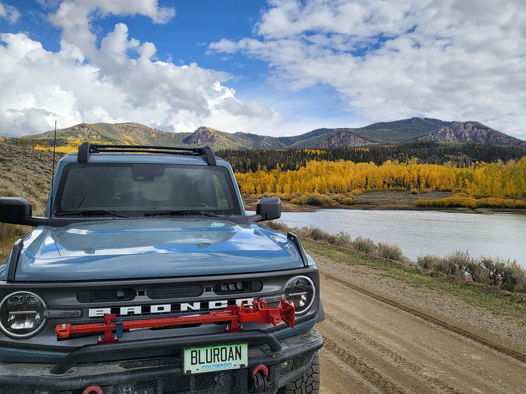

I can't remember if I posted before, but my third iteration is a 42" jack (replaced my 50 year old 48) on a bull bar using Amazon roll bar mount hardware, Previously I used a horizontal rear hitch mount : hung too low and won't work with my new bumper and a mount on the rotopax carrier next to the spare tire: can't carry both gas and jack, I like the bull bar best, but I use the shorter 42" jack.

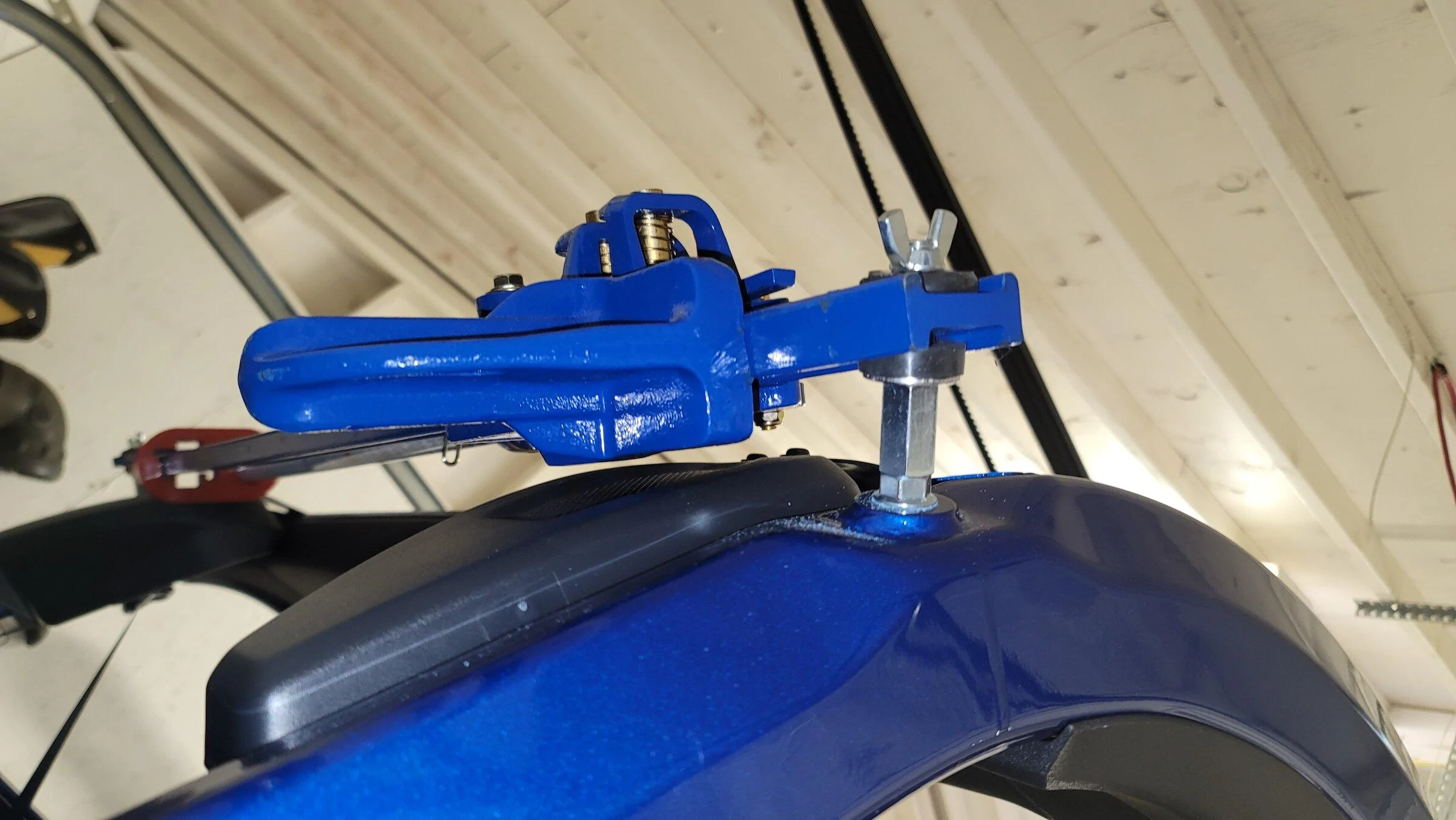

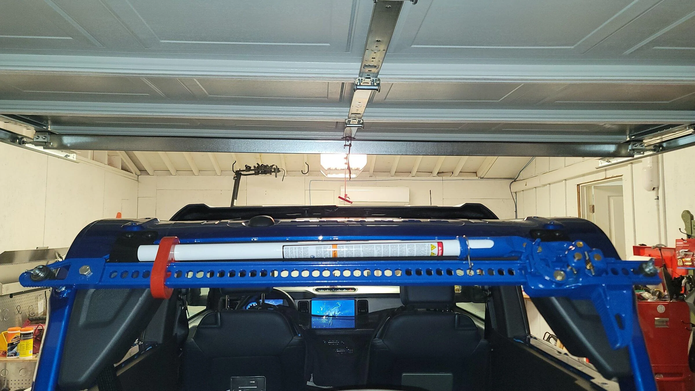

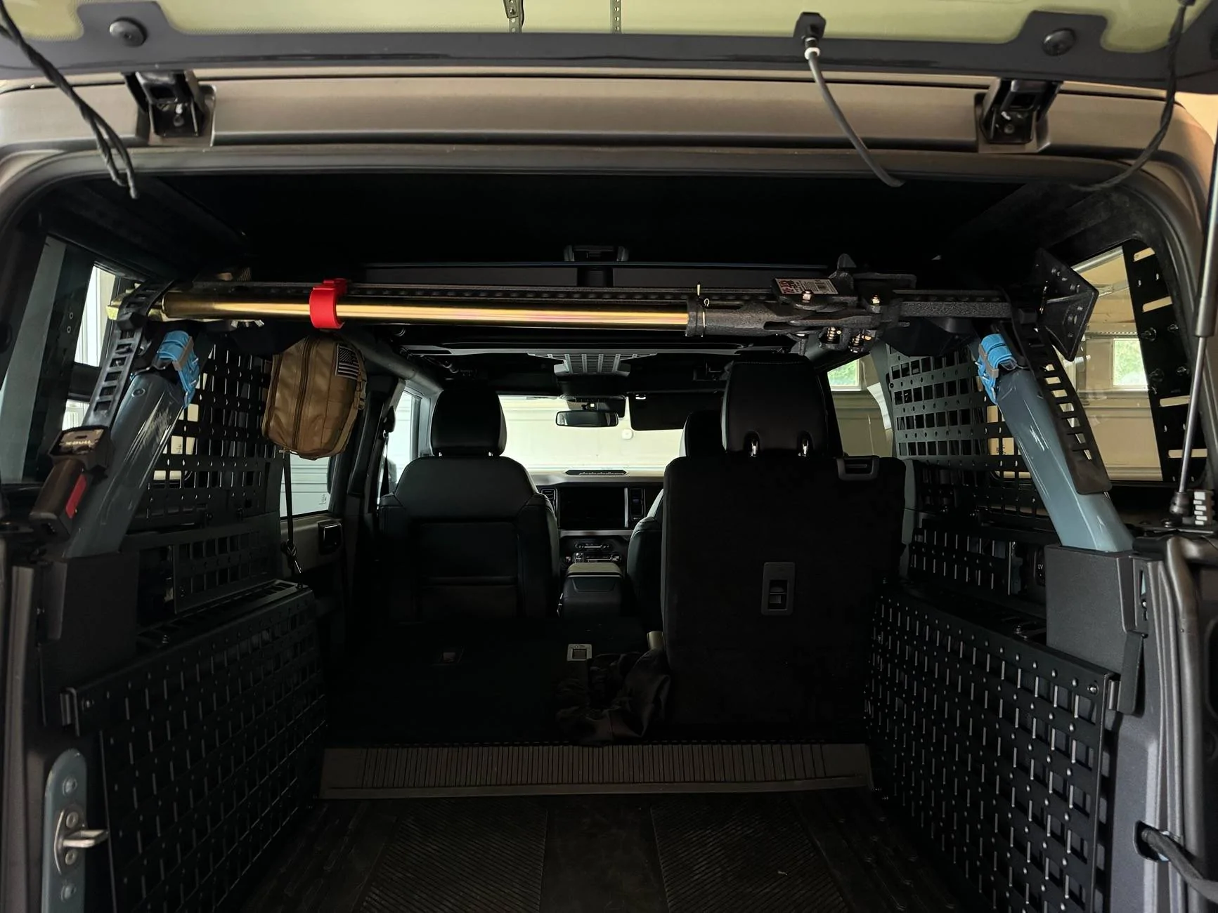

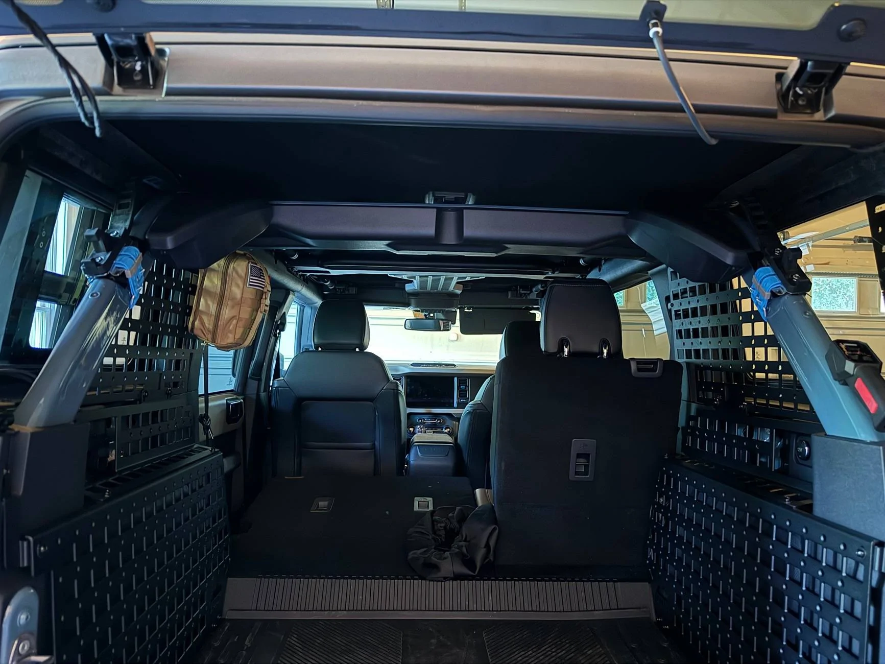

Heres my setup.
Clears top and speakers and is inside so less likely to get it stolen.
Utilitizes the factory holes in roll bar.
Dude, that's a slick way to mount the jack. Did you come up with that or did you buy it?
